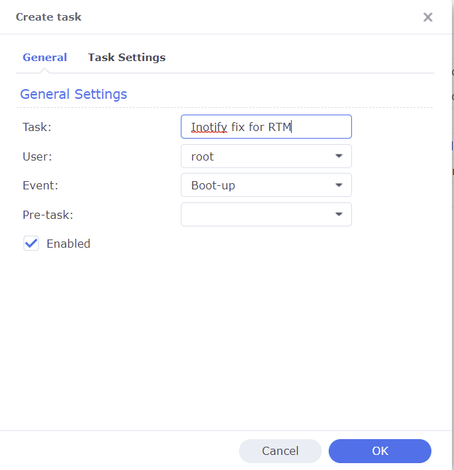

Solution Neminem 2007 Posted November 16, 2025 Solution Posted November 16, 2025 You have inotify issues still remaining. And that will disable Realtime monitoring. System.IO.IOException: System.IO.IOException: The configured user limit (8192) on the number of inotify watches has been reached, or the operating system failed to allocate a required resource. You can fix that by reading and doing this.

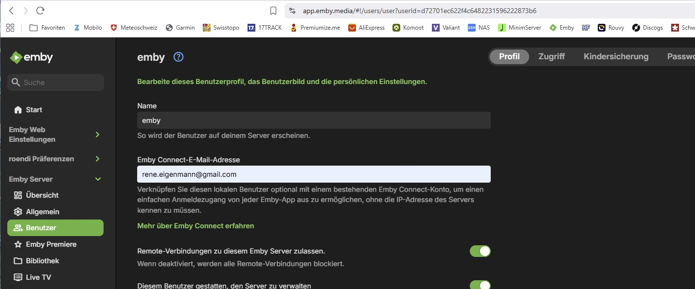

Roendi 16 Posted November 17, 2025 Author Posted November 17, 2025 Hi Luke, I restart the Server again and this Error Message is going away. The only Thing I have: I can’t save my Email Address on the Profile. But I send an Email to emby.media. like described. Everything works now like bevor Thanks for your Support
Luke 43720 Posted November 17, 2025 Posted November 17, 2025 Quote I can’t save my Email Address on the Profile Why can't you? What exactly happens when you try?

Roendi 16 Posted November 18, 2025 Author Posted November 18, 2025 @Neminem Now I see another small Problem. The Event Type Boot-up no longer exist. I feel the function come now to late
Roendi 16 Posted November 18, 2025 Author Posted November 18, 2025 (edited) Task Scheduler is working now on Startup Sorry after long searching I found it. Sorry for that Edited November 18, 2025 by Roendi 1
