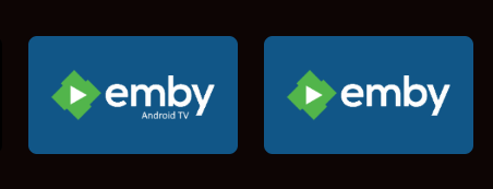

ElwoodBlues 1 Posted November 25, 2025 Author Posted November 25, 2025 On 11/17/2025 at 7:23 PM, sa2000 said: Thank you for the logs. It puts it all into context. So it is Nvidia Shield running Emby for Android TV app version 2.1.23 streaming a recorded .ts file from Emby Server version 4.9.1.90. The playback stream is being transcoded by the emby server So I understand that playback is ok unless you do some seeking and then the audio / video start to drift and gets worse as you do more seeking. The .ts file that was being played back shows about 58 minutes of a news recording. Assuming that the problem arises with this .ts file (news recorded 7am), i will send you a private link to upload the media file so i can do tests with it. - Does the issue arise if you play this .ts file with, for example, vlc and do seeking - Does the selection of subtitle stream have a bearing on the problem - What options are set on the Nvidia Shield Emby for Android TV app in App Settings > Playback Settings - If you install the universal Emby for Android app on the shield, does that have the problem in same way to the Emby for Android TV app ? See the links here for the latest stable release and beta release for the Universal Emby for Android app https://emby.media/community/index.php?/topic/21348-emby-latest-versions/#comment-208311 >>So I understand that playback is ok unless you do some seeking and then the audio / video start to drift and gets worse as you do more seeking. Yes.. or having to go back & forth a bit having overrun where the commercials end. >>The .ts file that was being played back shows about 58 minutes of a news recording. Assuming that the problem arises with this .ts file (news recorded 7am), i will send you a private >>link to upload the media file so i can do tests with it. Unknown. Newroom Tokyo is a PBS program and doesn't have the same commercial interruptions as network TV does. >>- Does the issue arise if you play this .ts file with, for example, vlc and do seeking Unknown.. the smaller laptop screen makes it harder to see faces, mouths.. to see if audio & video are in sync. >>- Does the selection of subtitle stream have a bearing on the problem That is another problem I have been having with OTA recorded media. Most times I have no subtitles.. just a brief message " unable to load subtitles " when starting the program. I had given up on the problem so didn't pay much attention to it anymore until you mentioned it. >>- What options are set on the Nvidia Shield Emby for Android TV app in App Settings > Playback Settings Max stream bitrate=Auto ( wired connection ) Still watching prompt = hell NO Screensaver during pause = no Resume rewind = no Audio Output = Auto Allow TrueHD Pass-Thru = Yes Allow DTS Pass-thru = Yes Allow DTS-HD Pass-thru = Yes Allow Direct Play of TS files = Yes Skip forward =30 Skip Back = 10 Enable refresh rate switching = Yes Prefer exact refresh rate = no Match video resolution = no De-interlace HD content = no Allow Untrusted ssl playback = yes Pass direct path = Selection greyed out >>- If you install the universal Emby for Android app on the shield, does that have the problem in same way to the Emby for Android TV app ? See the links here for the latest stable release >> and beta release for the Universal Emby for Android app https://emby.media/community/index.php?/topic/21348-emby-latest-versions/#comment-208311 You guys really need to do something about this. If you search 'Emby' in the playstore app on the Nvidia box you only get the one for Google TV. you have to search for " emb " for it to show both versions. And when you are able to download the android version.. add it to the favorite apps toolbar.. you can't tell them apart. they are both Emby. both with the exact sam,e blue, green & white icon.. One interesting difference.. is on the Emby for google tv. I get the 'unable to load subtitles' message.. and on the generic emby android app the subtitles play.... I am having trouble determining if there is a time shift issue on the Emby for android. Do you know of any TV programs that often make use of a clapper?
sa2000 696 Posted November 25, 2025 Posted November 25, 2025 3 hours ago, ElwoodBlues said: If you search 'Emby' in the playstore app on the Nvidia box you only get the one for Google TV. you have to search for " emb " for it to show both versions. Thanks for highlighting this. I will follow it up 3 hours ago, ElwoodBlues said: And when you are able to download the android version.. add it to the favorite apps toolbar.. you can't tell them apart. they are both Emby. both with the exact sam,e blue, green & white icon.. There is a difference. One has the text "Android TV" 3 hours ago, ElwoodBlues said: I am having trouble determining if there is a time shift issue on the Emby for android I suggest you continue using the Emby for Android app and if the problem arises, save the .ts file that is highlighting this and let me know and I will send you a new upload link to see if i can reproduce the issue Thanks
