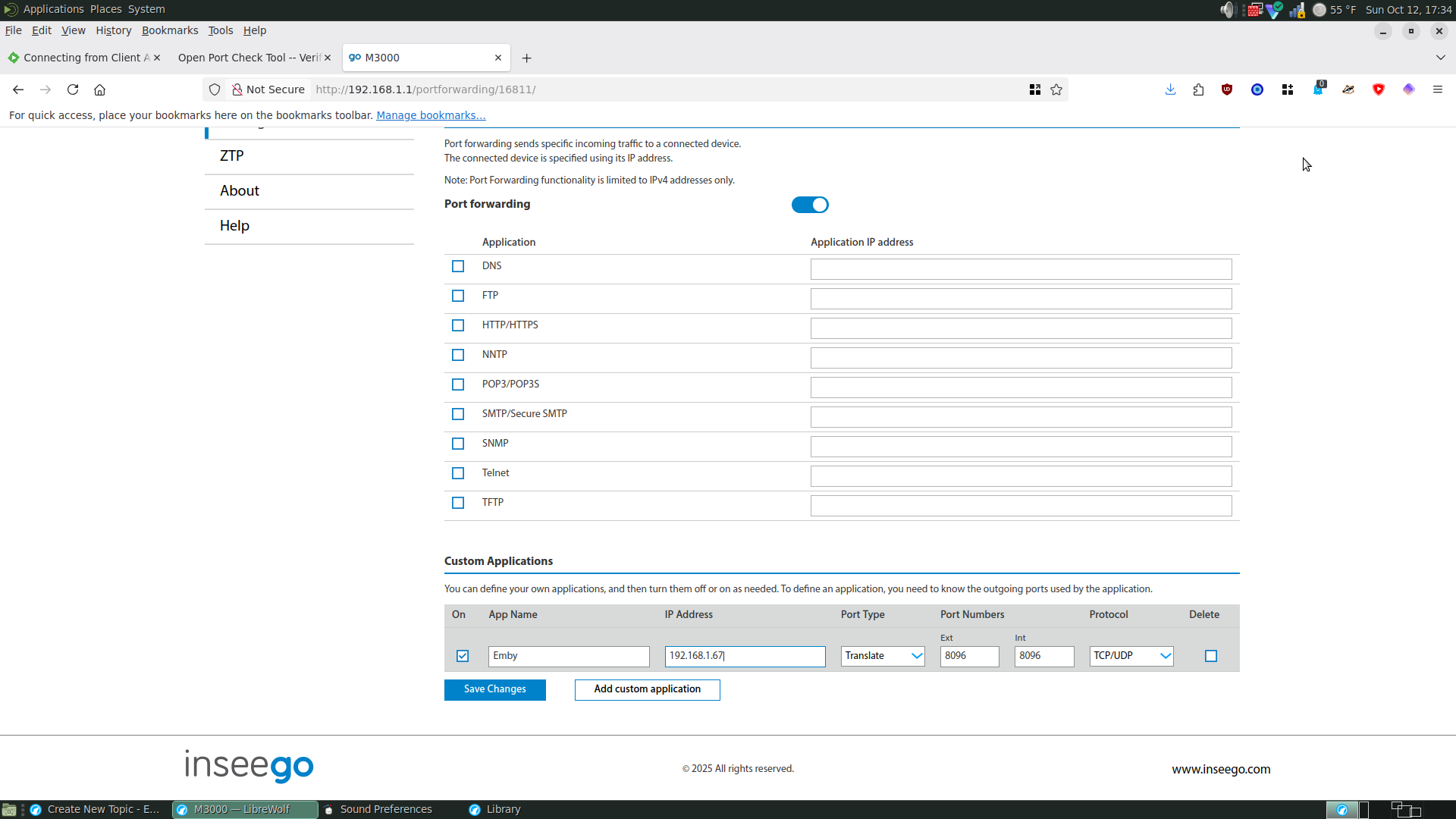

Ihategettinganotheraccount 0 Posted October 13, 2025 Posted October 13, 2025 I am running Rocky Release 9.6. and can't connect to the server outside of my network. I assumed it was my router not being configured to allow it. I am in an apartment though and can't change anything there. I have been using Nordvpn Meshnet but since Nord has shut that down that is no longer an option. I do have my own hotspot. I configured the port forwarding I think how the Emby documentation reads. I used the home IP address. I still can't load Emby through a browser that isn't the server. https://www.canyouseeme.org/ can not see me. With all that I am wondering if its not the apartment router blocking it.

Luke 42242 Posted October 14, 2025 Posted October 14, 2025 For the address that entered into the port forwarding, are you sure that's the right value?
Ihategettinganotheraccount 0 Posted October 14, 2025 Author Posted October 14, 2025 7 minutes ago, Luke said: For the address that entered into the port forwarding, are you sure that's the right value? I took the address from Emby's dashboard I tried both home and remote.
Luke 42242 Posted October 14, 2025 Posted October 14, 2025 13 minutes ago, Ihategettinganotheraccount said: I took the address from Emby's dashboard I tried both home and remote. Well it has to be the local address, not remote. Are you sure that's the correct address for the server machine? Emby Server should detect the correct IP address, but you should still verify to be sure. Also what options are available in the port type drop down?

Luke 42242 Posted October 14, 2025 Posted October 14, 2025 It’s the one right in your screenshot with the port forwarding settings.
Ihategettinganotheraccount 0 Posted October 14, 2025 Author Posted October 14, 2025 22 minutes ago, Luke said: It’s the one right in your screenshot with the port forwarding settings. Turns out that is the only option in the drop down menu.
