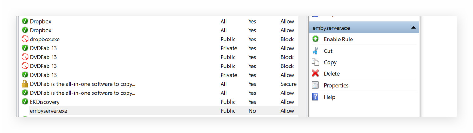

Barbablanca 7 Posted October 5, 2025 Posted October 5, 2025 Please help me troubleshoot. For whatever reason, emby server won't connect anymore. I disabled the firewall rule, and that has zero effect. What else do I need to look?

Barbablanca 7 Posted October 5, 2025 Author Posted October 5, 2025 I get the message that Firefox can’t establish a connection to the server at localhost:8096. (this despite that the rule for embyserver is disabled on the firewall)

ebr 16331 Posted October 6, 2025 Posted October 6, 2025 Hi. The rule in the firewall you are looking at is for public networks only. So, if your network is properly set to "Private" this rule has no effect anyway. Please ensure your network is set to "Private" and that you have appropriate rules in the firewall and let us know if that helps.
