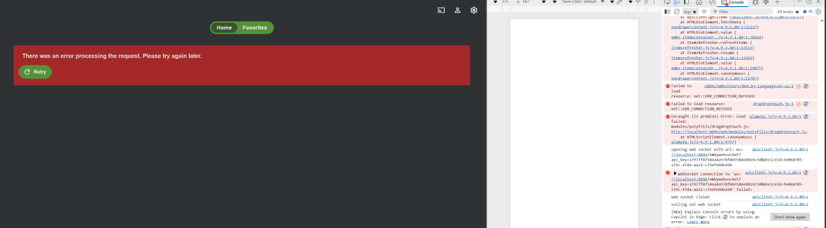

akacharos 34 Posted October 1, 2025 Posted October 1, 2025 Emby dashboard suggested to restart Emby server to update from 4.8 to 4.9.. I restarted it, but it hanged there forever. I let it do its thing for several hours. Eventually I gave up and restarted the whole windows machine. Server cannot load (connection refused). I show a glimpse of interface loading with the error attached . Log shows that core components are initiated just fine, but somehow the web component doesn't work. Given the last entries of the log, I suspect the issue is with the sqlite database? Server was working fine for few years now and been through several major updates. That's a first one. I tried several windows reboots but always the same result. Any help is appreciated. embyserver-anon.txt

brothom 211 Posted October 1, 2025 Posted October 1, 2025 2 minutes ago, akacharos said: @brothom, could you explain what scripts fail to load? Sorry, I should have explictely mentioned the webbrowser log this screenshot: It looks like a bunch of the scripts / assets can't be loaded. Maybe this is because your server has upgraded. Can you maybe try to clear your browser cache / cookies? You're able to reach the emby page, but some other content doesn't seem to be right so that indicates the server is running.

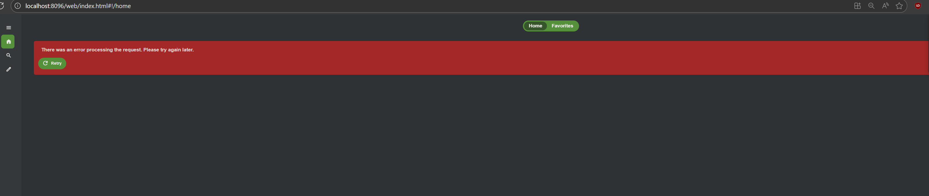

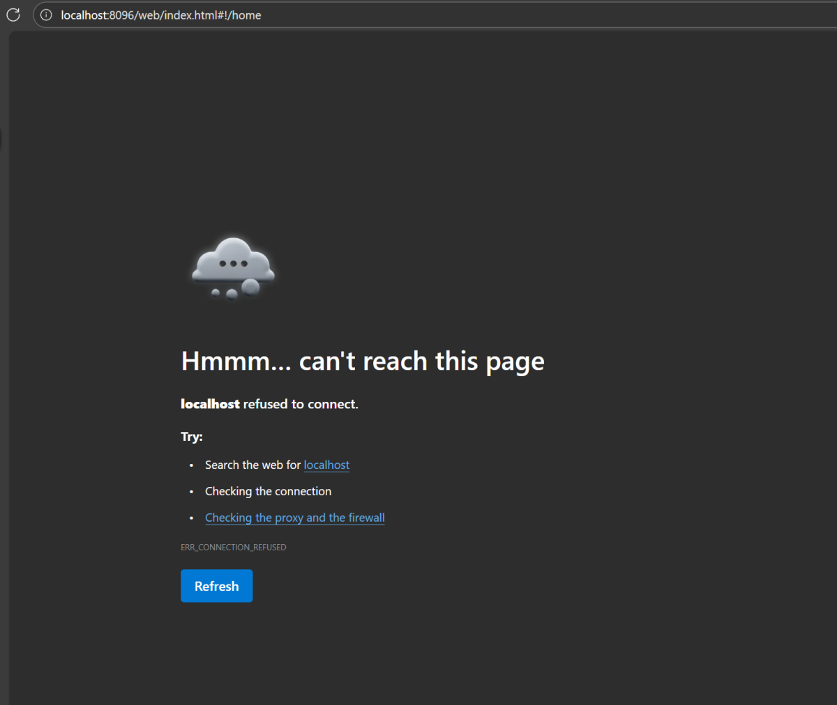

akacharos 34 Posted October 1, 2025 Author Posted October 1, 2025 Sorry, I should have clearly stated that the screenshot attached is only when I run EmbyServer.exe and the browser open up. Once I reload the web page just goes down (connection refused/unable to connect) from all browsers including incognito and I just realized that the Emby server stops running because I can't see it in the processes...so this looks bad Any other suggestions? Shall I try to revert to 4.8 or it's a bad idea?

akacharos 34 Posted October 1, 2025 Author Posted October 1, 2025 Here's the last attempt to start it up. Exactly the same log output. So I start the server, browser tab opens with this: I reload the page and get this: Emby server process is dead and log attached gets generated. So I am kind of stuck. embyserver-63894946260-anon.txt
