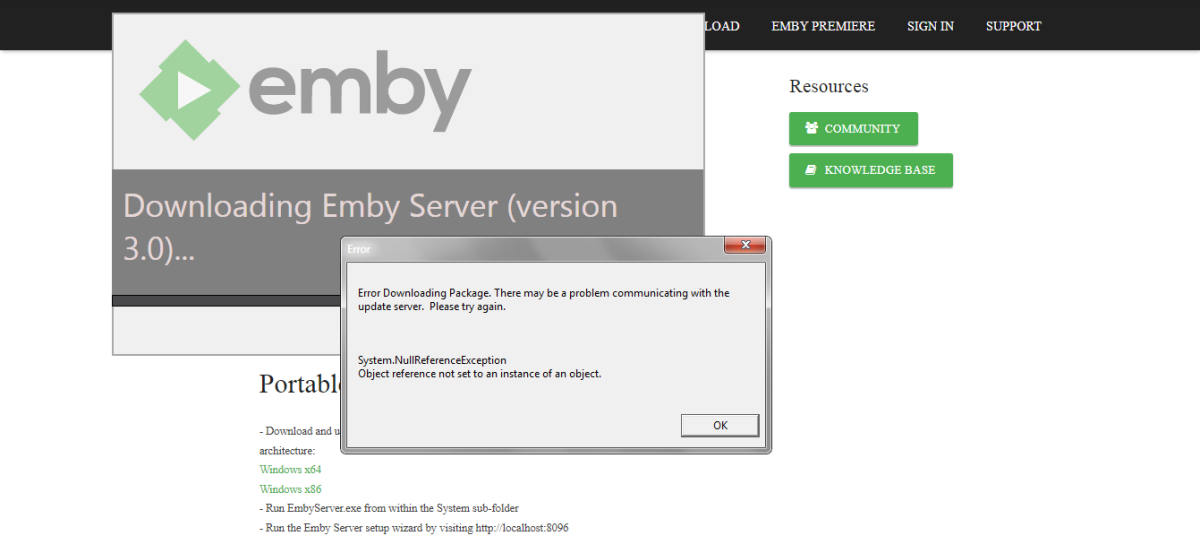

Guest Posted September 18, 2025 Posted September 18, 2025 I had Emby years ago and it worked fine. Now I can't even install it on the exact same computer it was on before because it can't download the setup files. I searched and found others with the exact issue as far back as ten years and it's still not been fixed?

seanbuff 1360 Posted September 18, 2025 Posted September 18, 2025 30 minutes ago, BLAlley said: I searched and found others with the exact issue as far back as ten years and it's still not been fixed? What is the URL you are using to download the Emby Server install package? Also, looks like you're using quite an old version of Windows, Windows 7 perhaps? Have you ensured the OS is fully up to date?
Guest Posted September 18, 2025 Posted September 18, 2025 https://embydata.com/downloads/server/release10/setup.exe Yes, Windows 7 with Service Pack 1, just like it says on your site."* Supports Windows 7 SP1 or newer version of Windows. If running Windows 7 please make sure Windows Updates are fully up to date."

brothom 211 Posted September 18, 2025 Posted September 18, 2025 6 hours ago, BLAlley said: I had Emby years ago and it worked fine. Now I can't even install it on the exact same computer it was on before because it can't download the setup files. I searched and found others with the exact issue as far back as ten years and it's still not been fixed? I found this microsoft link: https://learn.microsoft.com/en-us/answers/questions/1241236/the-object-reference-is-not-set-to-an-instance-of and https://stackoverflow.com/questions/34084003/visual-studio-error-object-reference-not-set-to-an-instance-of-an-object-after. They mostly indicate there are either old files that need to be cleaned up ór the current user has insufficient permissions over the designated folder. You could try reinstalling the .DOT framework (these tend to get funky over time from my own experience) and making sure there's nothing in the director Emby is trying to install. These are %appdata%\Roaming\Emby-Server and Emby-InstallLogs I think.

Lessaj 486 Posted September 18, 2025 Posted September 18, 2025 Looks like the stub installer might be trying to get a 3.0 server version from Github which doesn't exist anymore (just based on what the UI shows). Windows 7 is dead, move on. I know it was probably the best OS Microsoft has put out, but it's dead now. To my knowledge it already has issues with TLS which will just get worse since newer methods aren't/won't be implemented. 1

Luke 42289 Posted September 18, 2025 Posted September 18, 2025 Also Emby is available to you. The portable install can be obtained from our download page: https://emby.media/windows-server.html just unzip wherever you want to keep it and run Embyserver.exe

Lessaj 486 Posted September 18, 2025 Posted September 18, 2025 The Windows installer doesn't install a service that automatically starts anyway, you'd have to configure it yourself. You can still do that with the portable installation. https://emby.media/support/articles/Run-as-Windows-Service.html
