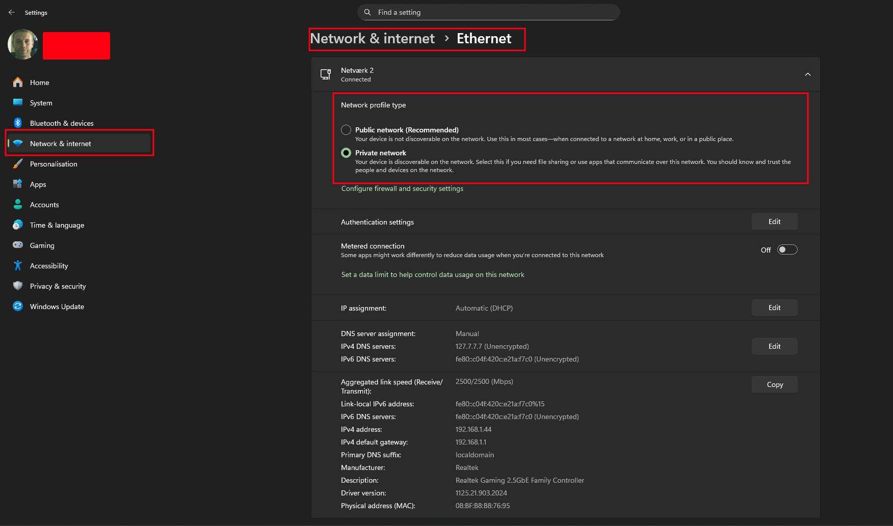

pwhodges 2039 Posted September 4, 2025 Posted September 4, 2025 Is the network type set to public (wrong) or private (correct)? Paul

RobertLaing 0 Posted October 11, 2025 Author Posted October 11, 2025 On 9/4/2025 at 8:39 PM, pwhodges said: Is the network type set to public (wrong) or private (correct)? Paul I looked on my dashboard on my main PC under 'Network' and there is no such option.
Neminem 1630 Posted October 11, 2025 Posted October 11, 2025 Are you looking Server PC ? Are you not seeing this under network ?
