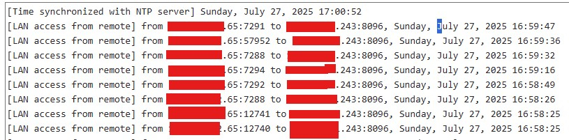

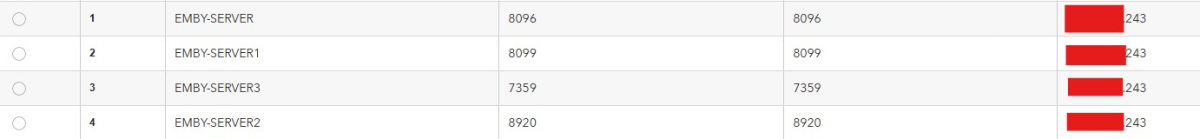

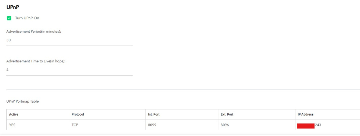

Dont1982 8 Posted July 27, 2025 Author Posted July 27, 2025 I just got a new router because the other one let the factory smoke out of it. I can connect through all my devices connected to my network. When I try to connect outside my network, it does not work. I have got the port forwarding on and I made up the port forwarding like I had before. I have turned off all antivirus and firewall and still cannot connect outside the network. I tried using emby connect and the ip address that my server shows. I'm thinking that the router messing up might have been the issue with the shows not recording all the way. According to the router I can see where my iPhone is accessing the server through the port. The new router is a Netgear Night Hawk RS90. I have attached the screenshots of the port forwarding i made, and the port forwarding Emby made. I have tried it both way with mine only, Emby's only and both and i can not access my server from outside my network. Any help on this matter would be a great help.

Q-Droid 1011 Posted July 27, 2025 Posted July 27, 2025 (edited) Your server is listening on 8099 but your apps are forwarded to 8096. 2025-07-27 15:54:36.939 Info App: Adding HttpListener prefix http://+:8099/ UPnP has a forwarding rule that might be in conflict with your other defined rules and it's hard to know which one has precedence. Clean up your forwarding and decide which ports you want to use and advertise. The easiest would be to use the default 8096 internally and externally but if you have a reason to not use that port just make sure that you don't configure multiple and possibly conflicting rules. And turn off UPnP unless you need it for something else. Edited for correction. Edited July 27, 2025 by Q-Droid
