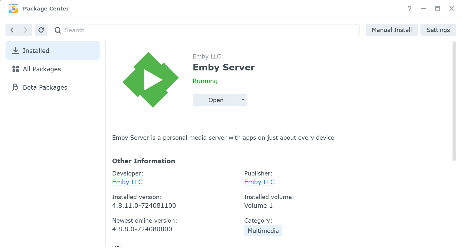

karbo 2 Posted June 29, 2025 Posted June 29, 2025 I've installed Emby (4.8.11.0) on Synology (7.2.2 72806 update 3), and I try to open the URL http://192.168.0.25:8096/web/index.html, a page opens and shows " forbidden" (in both Firefox and Chrome). So, now I'm stucked because the wizzard is not starting. I'm not using a VPN or so, I'm just in my private network. I've had Emby running a few years ago but had a synology system crash. Had to reinstall synology and now after quit a while, I try to install Emby again. But no luck so far. Any ideas?
Luke 42239 Posted June 29, 2025 Posted June 29, 2025 Hi, can you please show a screenshot? Was this a new install of Emby? Did you just do the server startup wizard?
karbo 2 Posted June 29, 2025 Author Posted June 29, 2025 Hi, thanks for the quick response. I installed it new. but it might be that there was an old install already present from before the system crash. The OS was reinstalled at a certain point. Perhaps that's playing tricks?
Solution Luke 42239 Posted June 29, 2025 Solution Posted June 29, 2025 OK I would suggest shutting down the server and then deleting the server data folder: Emby Server Data Folder When you start back up, it should be a fresh start at that point. Please let us know if this helps. Thanks.
karbo 2 Posted June 29, 2025 Author Posted June 29, 2025 OK. I'll do that later this week. I let you know for sure 1
karbo 2 Posted June 30, 2025 Author Posted June 30, 2025 Hi Luke, I've followed your advice and now it's working fine! Thank you for you help. Regards, Jos 1
