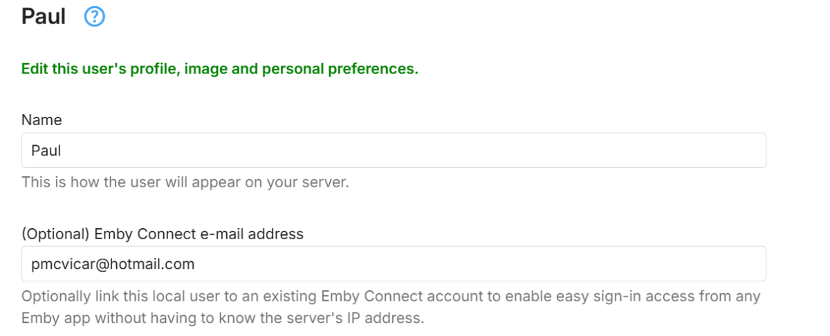

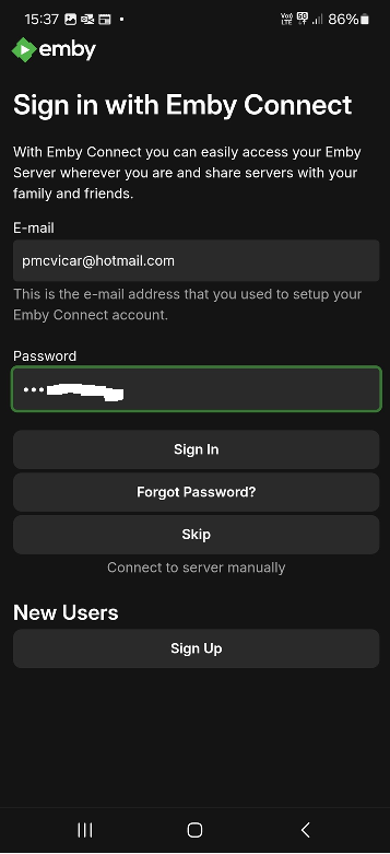

Arishem 0 Posted June 28, 2025 Posted June 28, 2025 Hi I am trying to connect to my Emby server remotely. I have been connecting to the server over my LAN with no problems, and this is the first time I have tried to connect remotely. In the past when I have connected over the LAN I have entered the server adress manually. I am now trying to sign in on my Android phone using the Emby app and Emby connect. The below actions on the Android phone are being done over the Mobile network - not over wi-fi. Step 1. I open the Emby App on Android and get the Welcome to Emby screen. I select Next. Step 2. I get the screen below asking me to Sign in with Emby Connect, and enter my login details. Step 3. I get taken to the following screen in the app I was expecting to see my server listed here. Because I am being asked to Sign in with Emby Connect I am assuming I am not signed in? I have enabled Allow remote connections to this Emby Server. in the Network settings on the Server I have entered my email address to associate my User with my Emby account as per below: Please advise what I am missing if i want to connect to my server remotely. Emby server log attached. Thanks! embyserver (1).txt
Luke 42290 Posted June 28, 2025 Posted June 28, 2025 Hi, yes that's odd. You should see your server there. Try removing the Emby Connect info, clicking save, and then adding it back and clicking save again. Please see if that helps. Thanks.

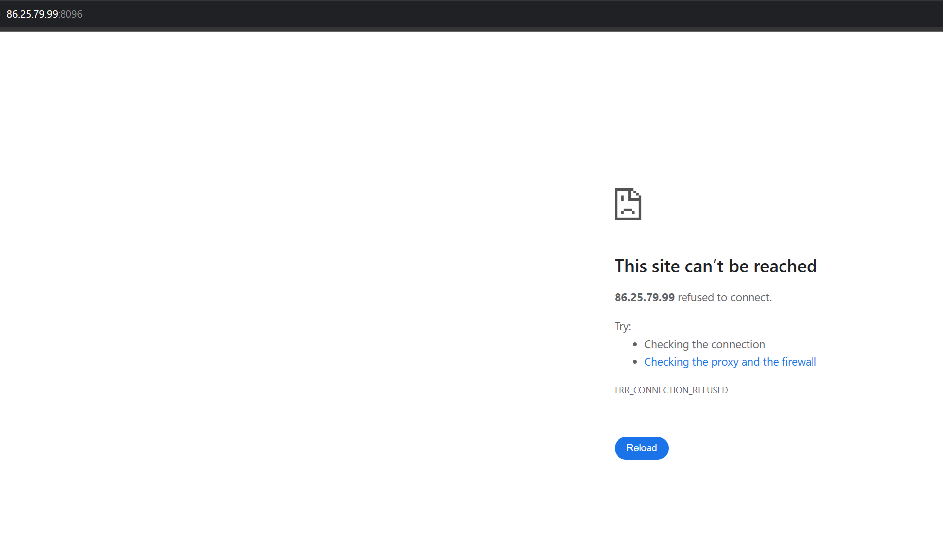

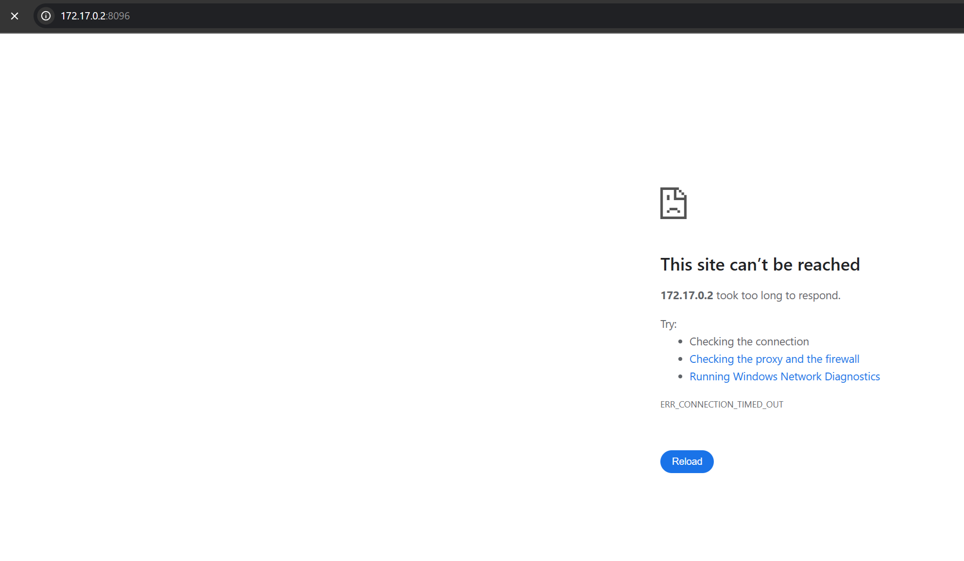

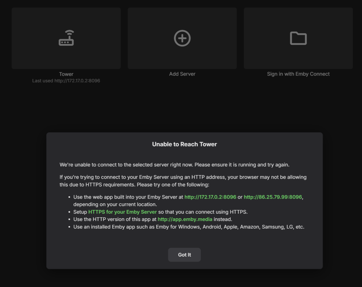

Arishem 0 Posted June 28, 2025 Author Posted June 28, 2025 3 hours ago, Luke said: Hi, yes that's odd. You should see your server there. Try removing the Emby Connect info, clicking save, and then adding it back and clicking save again. Please see if that helps. Thanks. Tried that and did a re-start of the server. I can see the server listed when I log in, but I am unable to connect (trying it from Windows via Chrome this time). I got the screen below when trying to connect tot he Tower. I tried those links and none helped. One of them took me to a 12 page forum post talking about encryprion I think. Any more advice?
Luke 42290 Posted June 28, 2025 Posted June 28, 2025 Right you need to choose from those four options in the dialog. Which one would you like to do?
Arishem 0 Posted June 28, 2025 Author Posted June 28, 2025 1 hour ago, Luke said: Right you need to choose from those four options in the dialog. Which one would you like to do? Not sure what you mean mate? I clicked on this and then this then this http://app.emby.media took me back to the same place I started and I already tried the Android app. Which one do you suggest?
Luke 42290 Posted June 29, 2025 Posted June 29, 2025 Quote I clicked on this Is that the correct local network ip address? Maybe it's not?
Luke 42290 Posted June 29, 2025 Posted June 29, 2025 Quote and then this This is your remote ip address, which might not work from inside your home network if your router doesn't allow that. .we cover this in our remote setup guide: Connecting from Client Apps
Luke 42290 Posted June 29, 2025 Posted June 29, 2025 Quote Which one do you suggest? I suggest getting the local network address figured out. What is the local network ip address of your server machine? Then we should look at why Emby Server is detecting your local network address as 172.xx. This can happen sometimes in odd or overly complex network setups. As a last resort, it can be configured manually in server network settings but it's usually better to learn what's going on first.
