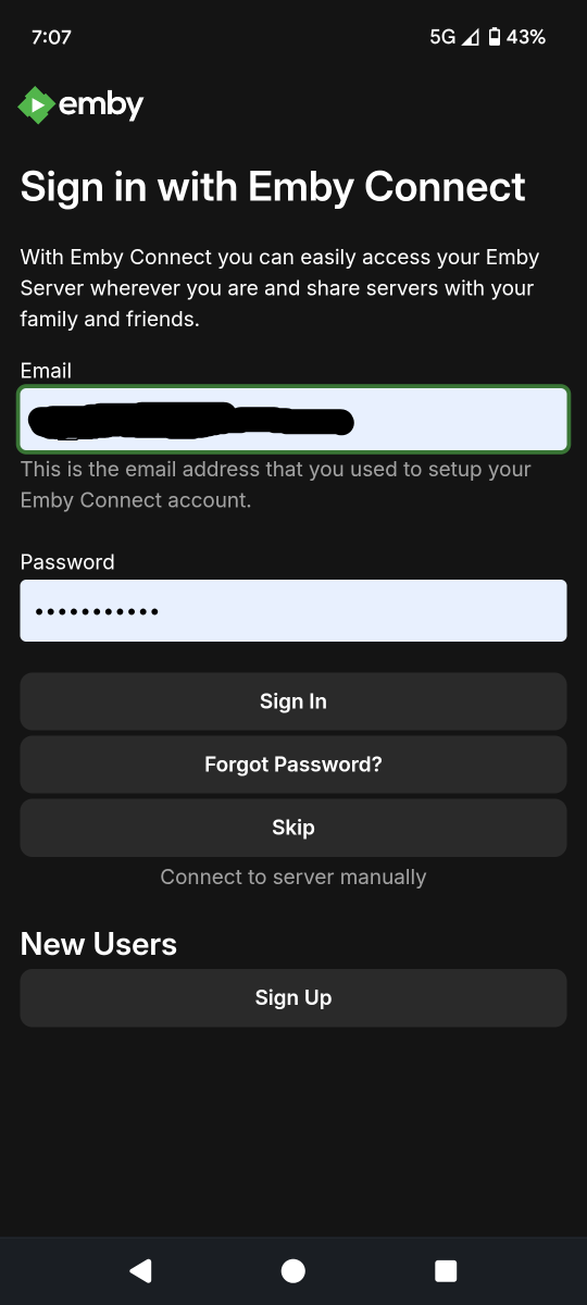

Spyr01 2 Posted June 11, 2025 Posted June 11, 2025 i got emby setup to my server and i was able to stream to my local devices on my network. but i cannot stream outside my home. i looked into this and my ip address is dynamic so i cant use a direct connection for emby to connect to external ip address. so i dug deeper and found emby connect. i created a account and all it has listed is: add server and sign in with emby connect. i click the sign in with emby connect button. it then takes me to a area where i fill in my username and password i created. as soon as i click the sign in button, it just takes me to previous screen with nothing changed. if i go home and add my server using the add server button, it only allows me to add it via the local ip address. which i am able to add it but when added and i sign into emby connect, it shows my local ip aka the one i created at home but cant connect to it. what am i doing wrong? 1

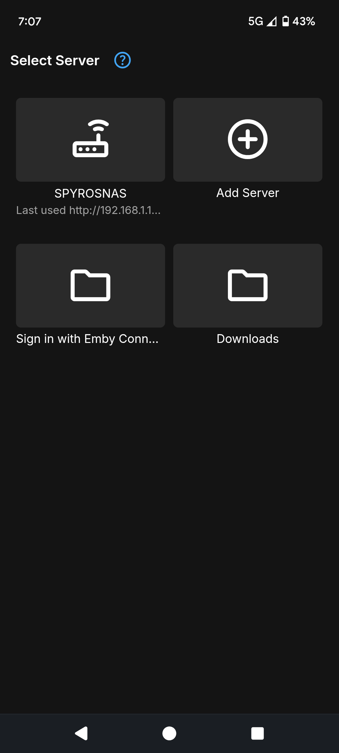

Spyr01 2 Posted June 12, 2025 Author Posted June 12, 2025 i still dont understand why my origional problem is what it is and why it is happening guys. when i had plex, it works fine out of the box. to me, it seems to me it is a emby app or emby server side issue. it allows me to login like i said but i cant connect to my server via a external connection. unless someone can do a step by step to setting up a internal and external connection via the emby app and i can see where i am going wrong. cause again, when i go to my emby app and sign in using my email address i use for the emby server. all i see is my local ip server and add new server and there is the connect to emby connect which if i use that, it goes back to previous screen. if i go to the add a server button, it asks for a ip which i cant use due to me being dynamic ip!

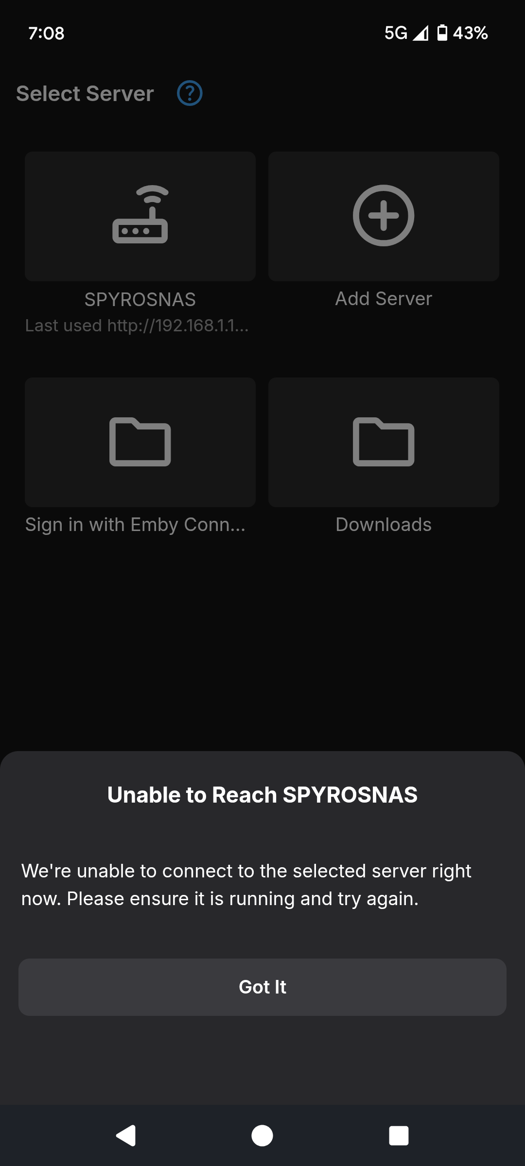

Spyr01 2 Posted June 12, 2025 Author Posted June 12, 2025 here is what i see in app: the one is when i can connect via lan. the others is when i make a attempt to connect via wan. the one that shows the login. after i try to login, it takes me back to the screen that has the icon for my server for local
Luke 42301 Posted June 13, 2025 Posted June 13, 2025 Can you try doing a new server connection by clicking add server?
Spyr01 2 Posted June 13, 2025 Author Posted June 13, 2025 i have and i am able to add local server but i cant add my server over wan. as i show in te pictures above
seanbuff 1360 Posted June 14, 2025 Posted June 14, 2025 2 hours ago, Spyr01 said: i have and i am able to add local server but i cant add my server over wan. as i show in te pictures above You still have not confirmed that you have completed all of the steps in the "External Connections" guide that I originally replied to you with. On 12/06/2025 at 10:30, seanbuff said: In order for Emby Connect to work, you must first configure your server to be accessible remotely. Try following this guide: Connecting from Client Apps, specifically "External Connections" Emby Connect will not work until you have done that. Your server needs to be configured for remote connections first.
seanbuff 1360 Posted June 14, 2025 Posted June 14, 2025 On 13/06/2025 at 09:06, Spyr01 said: when i had plex, it works fine out of the box. The way Plex operates is such that all your connections go via their central servers, this makes it easy for them to provide remote connectivity without any user intervention. Emby is designed to be self-hosted (your server and connections are yours only), therefore it is up to the individual admin (you) to configure their Emby Server for remote access.
Luke 42301 Posted June 14, 2025 Posted June 14, 2025 2 hours ago, Spyr01 said: i have and i am able to add local server but i cant add my server over wan. as i show in te pictures above What exactly happens when you try to enter the address manually?
