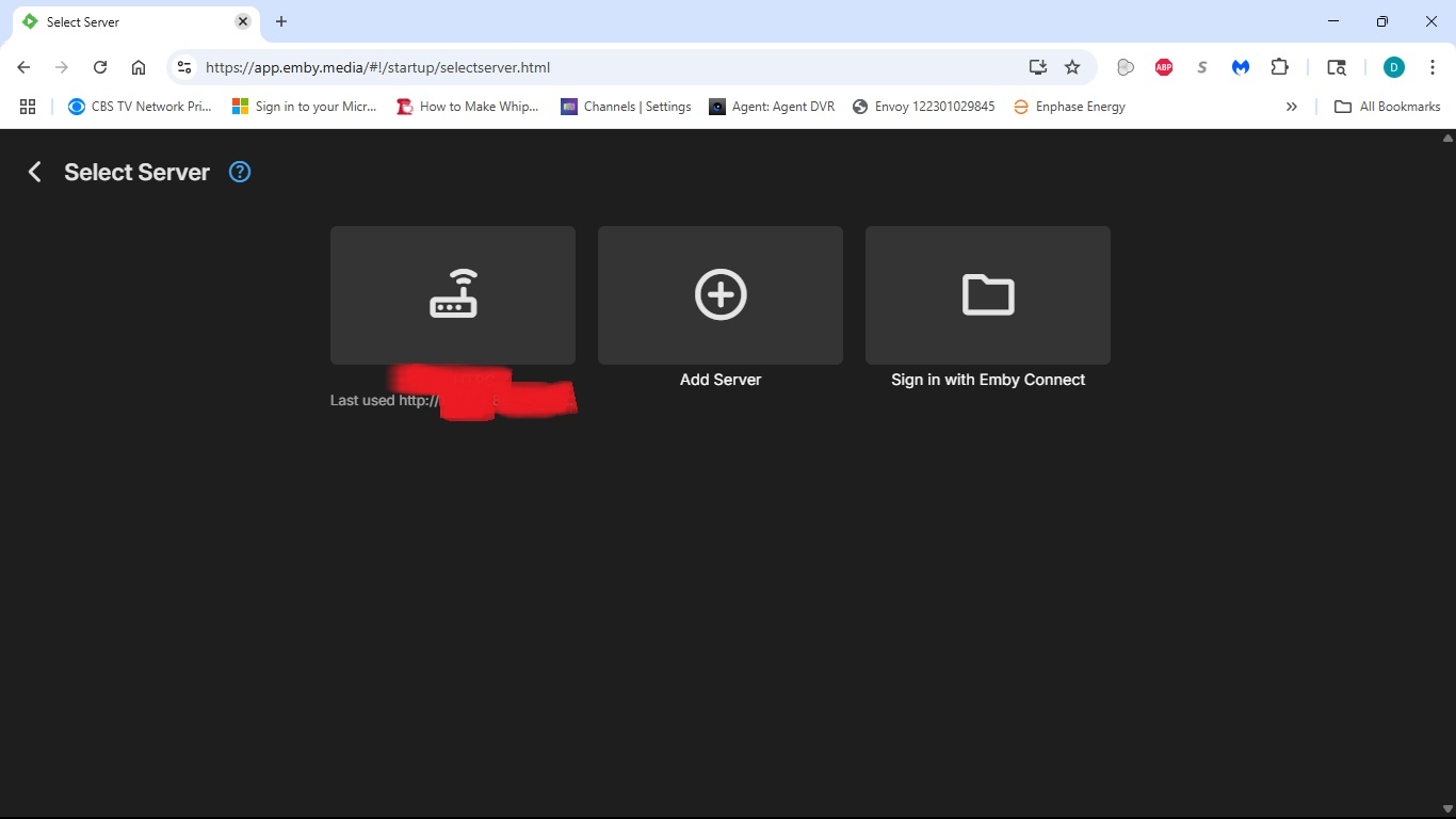

daldana 126 Posted June 4, 2025 Posted June 4, 2025 On the sign-in page, have you tried to add a new server with the correct "new" remote ip address?

Methodman104 10 Posted June 4, 2025 Author Posted June 4, 2025 50 minutes ago, daldana said: On the sign-in page, have you tried to add a new server with the correct "new" remote ip address? no, did not know i needed to.

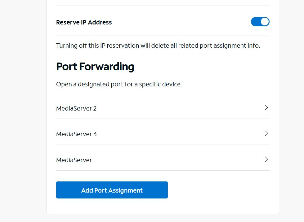

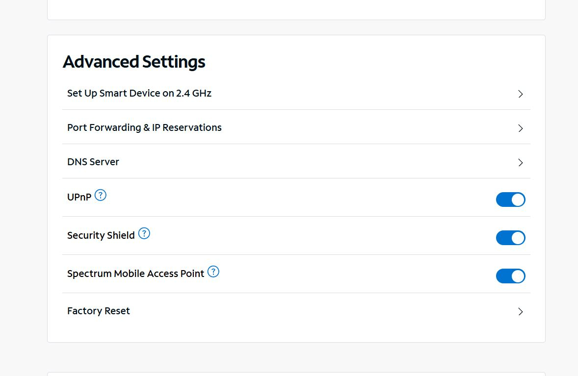

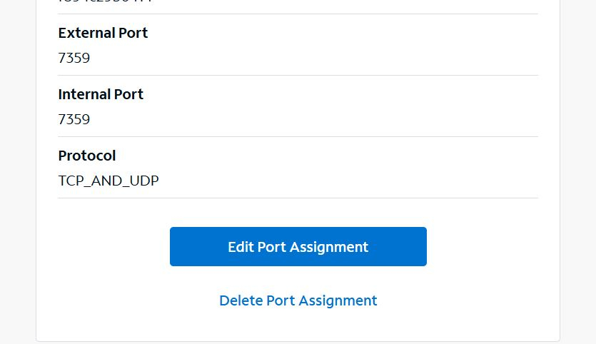

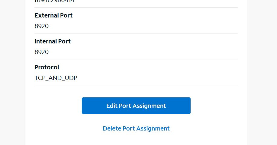

Methodman104 10 Posted June 4, 2025 Author Posted June 4, 2025 (edited) I forgot screen shots Router here they are... Edited June 4, 2025 by Methodman104

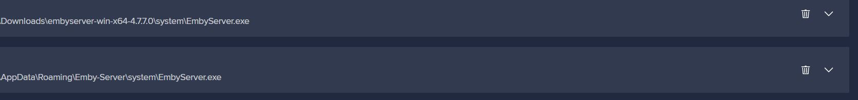

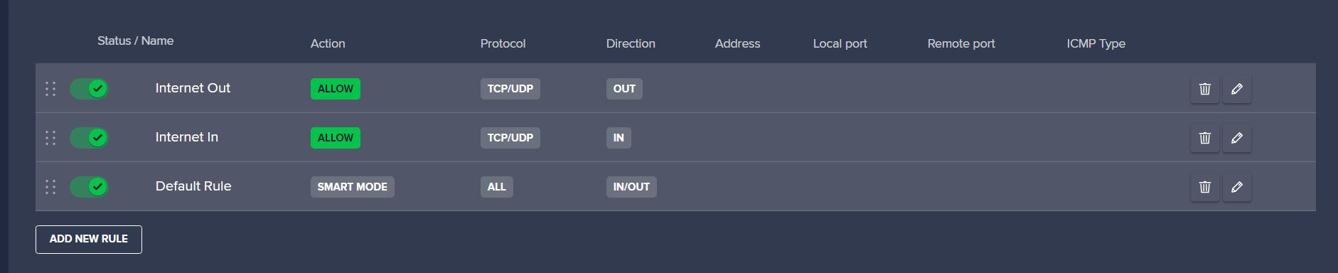

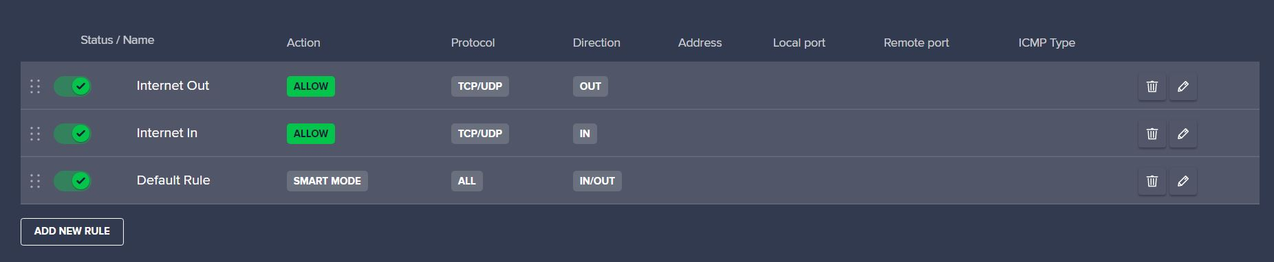

Methodman104 10 Posted June 4, 2025 Author Posted June 4, 2025 (edited) here are screenshots for Firewall application rules Avast Premium Edited June 4, 2025 by Methodman104
daldana 126 Posted June 4, 2025 Posted June 4, 2025 I had a similar problem after changing out a Spectrum modem. It replaced my old ip address with a new one, but my signing into Emby would always try the old address. I ended up adding a new server with the new address and it connected after that. I also had to tell my family members to change to the new server. After that happened a couple of times, I ended up using No-Ip for a hostname, so now I don't have to worry about ip address changes from Spectrum.

daldana 126 Posted June 5, 2025 Posted June 5, 2025 Does your sign in page look something like the one below? If so, try clicking on add server, then put in the new ip address and click connect. It's worth a try before buying a new router.
Methodman104 10 Posted June 5, 2025 Author Posted June 5, 2025 (edited) 45 minutes ago, daldana said: Does your sign in page look something like the one below? If so, try clicking on add server, then put in the new ip address and click connect. It's worth a try before buying a new router. yes it does (not on my desktop) but on my other devices. On the desktop when I load the emby app it loads into my server, but my live DizqueTV channels have no thumbnails and my content on-demand loads and plays for one second, then stops. But as I mentioned the other devices it looks like the photo you posted. So I have to add the new address and it will connect to the existing server? Or will that create an all new server from scratch? Edited June 5, 2025 by Methodman104
