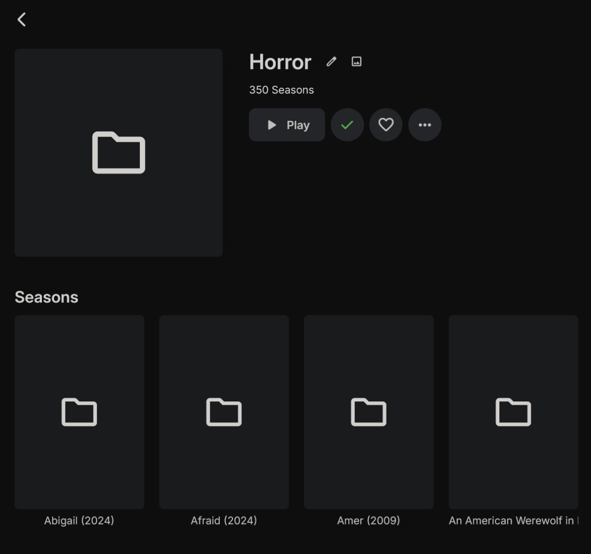

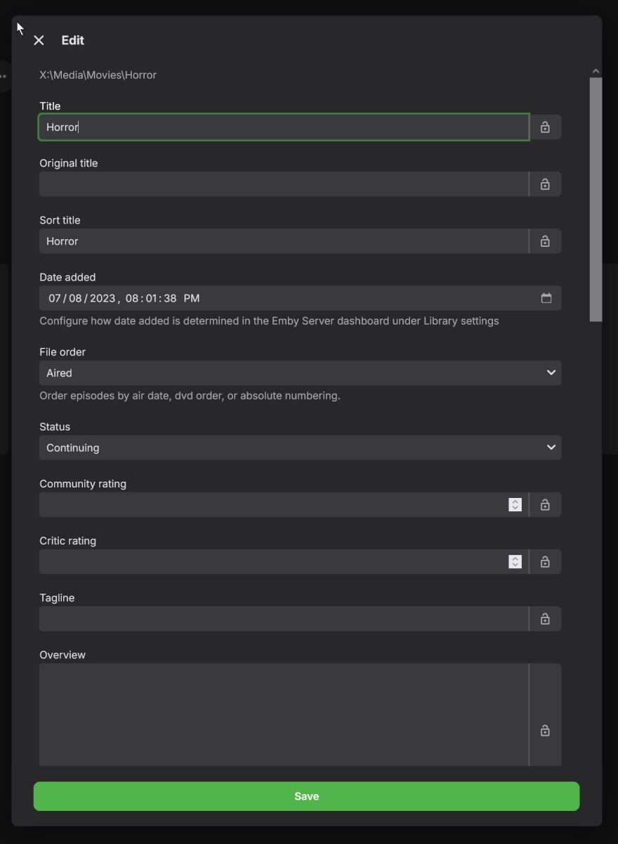

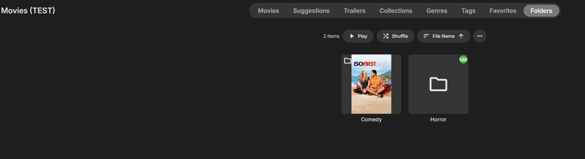

snacks03 15 Posted May 29, 2025 Posted May 29, 2025 (edited) One of my folders in my Movies Library is identifying as a Series. I've tried removing the identification, tried removing all of my nfos for that folder, completely removing the folder path from the library and removing the entire library, all cases continue to make the same bug. I also tried going into the Swagger UI mentioned in this post, but I'm not knowledgeable enough to see if there is something wrong. Running version 4.8.11.0 Edited May 29, 2025 by snacks03 add app version

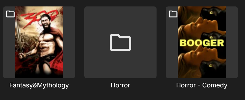

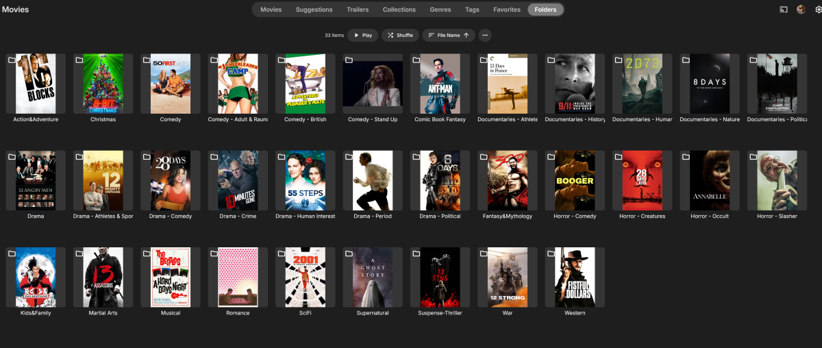

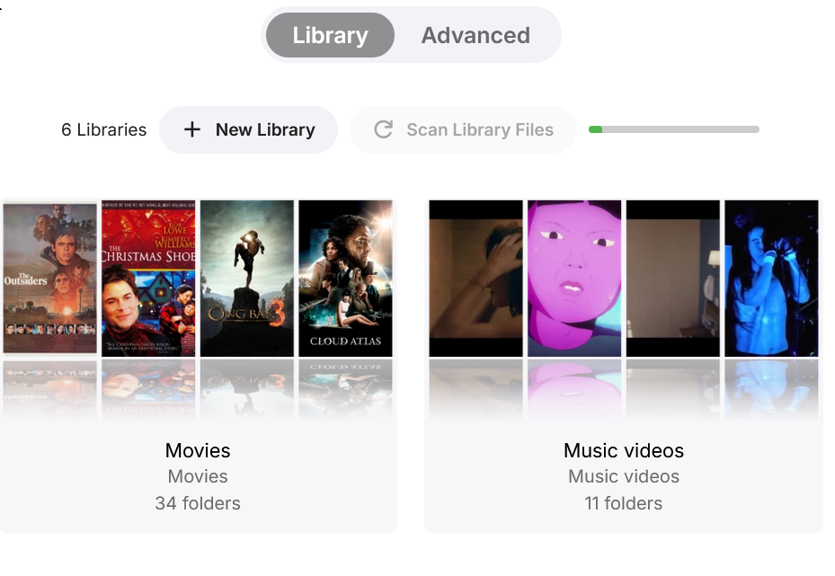

snacks03 15 Posted May 29, 2025 Author Posted May 29, 2025 (edited) 4 minutes ago, GrimReaper said: Since that's a movie library, why not use dedicated (Movie) content type library instead of Mixed content, therefore avoiding such occurrences by default (although in complex folder structures, other issues might arise)? this is not a mixed type content library, it has always been a Movie type library. Should I wait for the library scan to complete before submitting the log? I've added and removed this path a few times this morning Edited May 29, 2025 by snacks03 add images 1
GrimReaper 4840 Posted May 29, 2025 Posted May 29, 2025 Can you recheck/confirm in your Settings>Library tab on library thumbnail as it is not possible for an item to be identified as a Series in a Movie-type library.

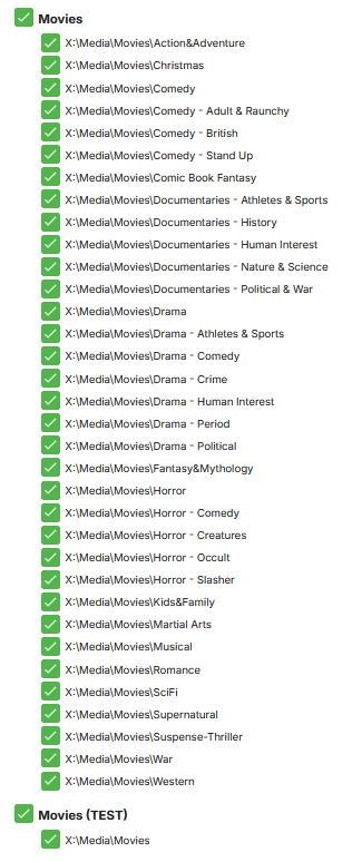

snacks03 15 Posted May 29, 2025 Author Posted May 29, 2025 3 minutes ago, GrimReaper said: Can you recheck/confirm in your Settings>Library tab on library thumbnail as it is not possible for an item to be identified as a Series in a Movie-type library. Im also generating a new library with only the suspect path (Horror) and a working path (Comedy) right now as Moves (Test). Same issue on new library add. I will have a log posted soon once scan is complete, my collection is quite large
GrimReaper 4840 Posted May 29, 2025 Posted May 29, 2025 I am somewhat confused as Horror folder as in: 44 minutes ago, snacks03 said: is not listed/visible here: 15 minutes ago, snacks03 said: Either way, prerequisite for any troubleshooting is for library scan to complete. As a sidenote, do you maybe have that same folder inadvertently added as some TV shows or Mixed content type library path?
snacks03 15 Posted May 29, 2025 Author Posted May 29, 2025 @GrimReaperI was in the process of removing and adding that path again to make this post, my apologies for the confusion. This problem has been occurring for a few days I double checked my other library pathings, those are set correctly for their content type and dont see any of paths mixed into my two TV libraries. I dont run any of my libraries under the mixed content type.

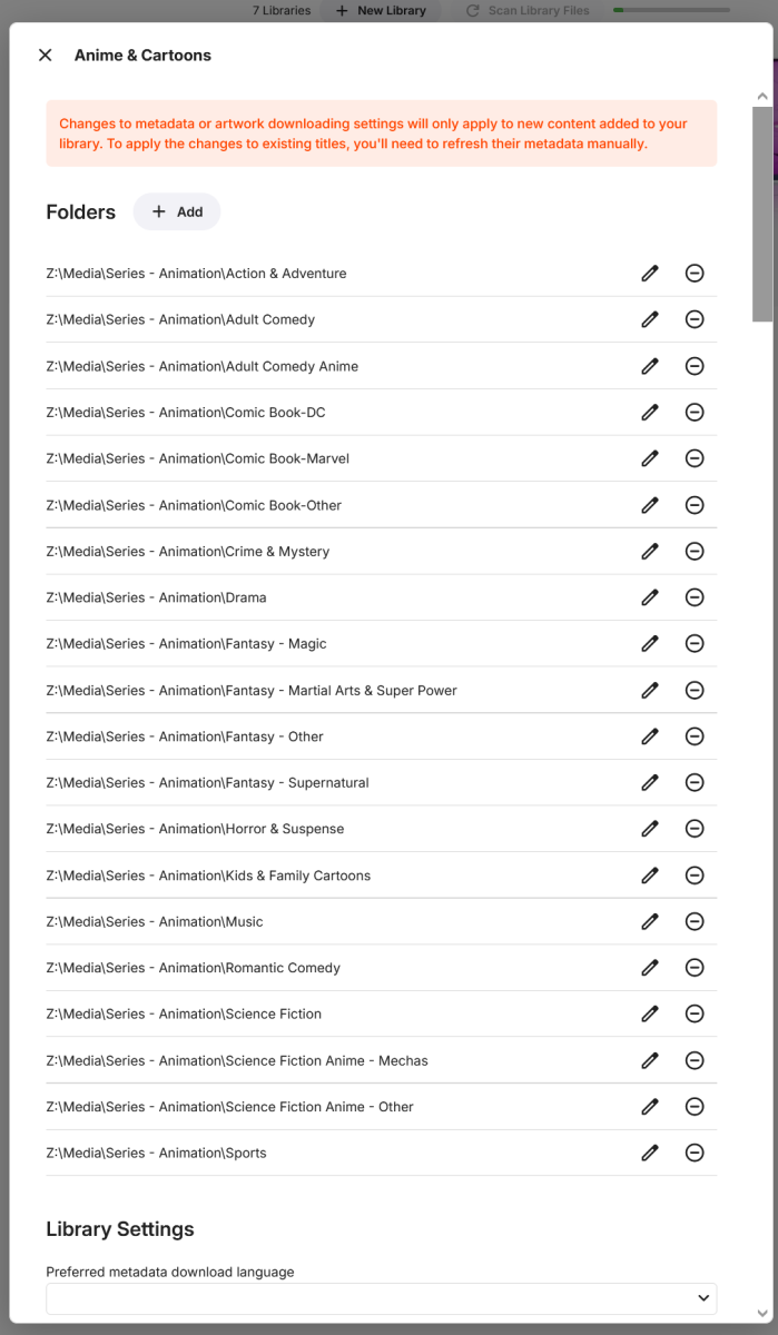

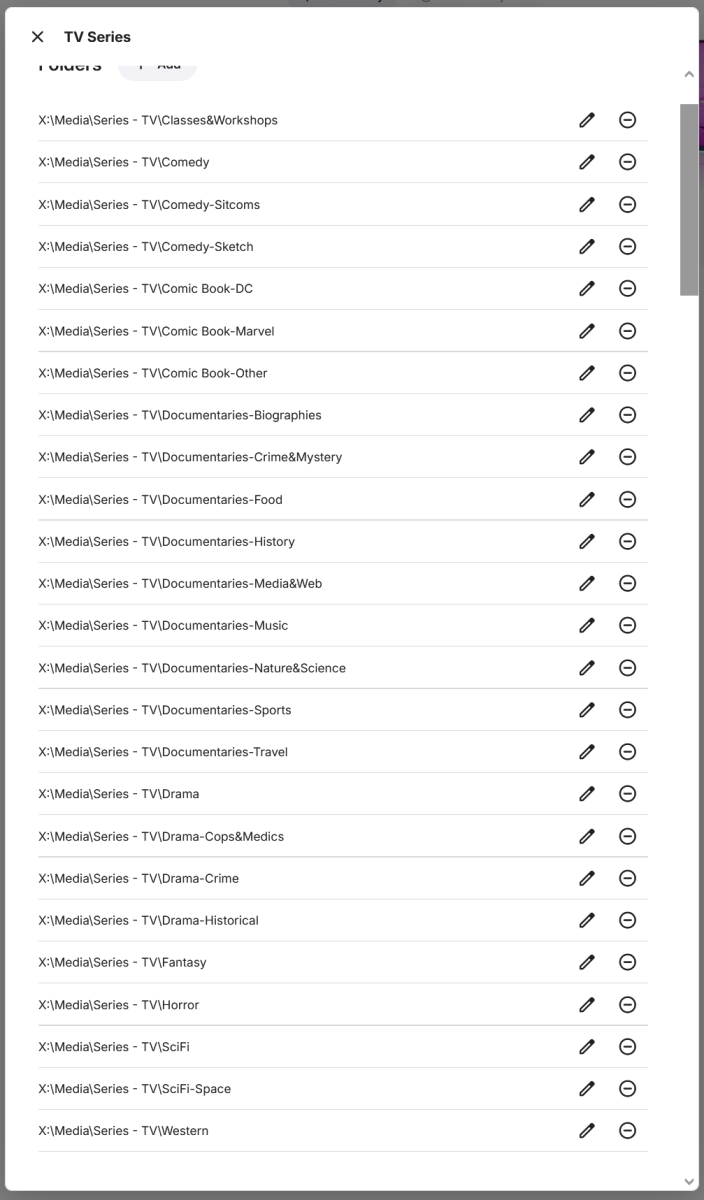

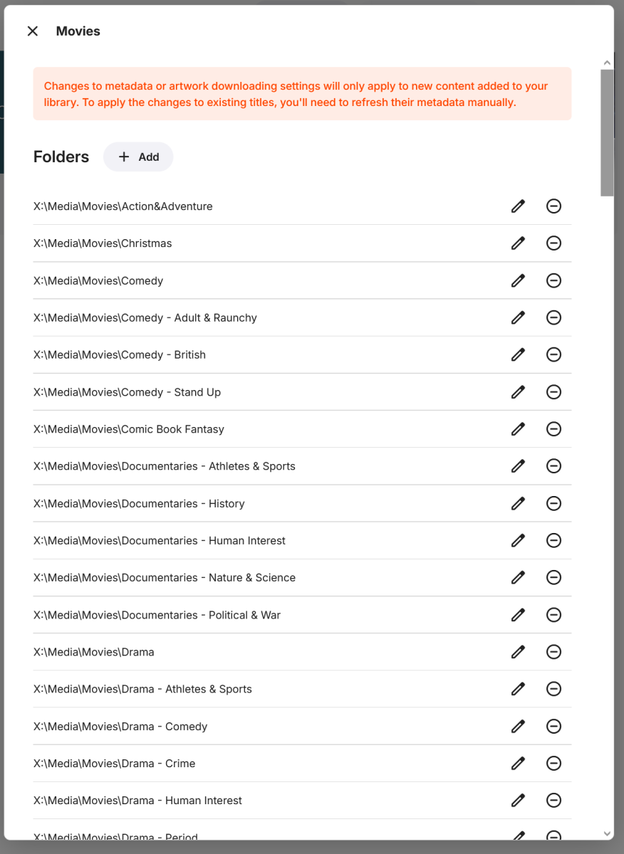

ebr 16305 Posted May 30, 2025 Posted May 30, 2025 Hi. Just a question but why have you added so many specific folders to the library? IOW why not just add "Series-TV" and "Series-Animation"...?
GrimReaper 4840 Posted May 30, 2025 Posted May 30, 2025 (edited) 24 minutes ago, ebr said: Hi. Just a question but why have you added so many specific folders to the library? IOW why not just add "Series-TV" and "Series-Animation"...? I tend to disagree there, have lost track how many topics troubleshooted due to complex library structure failing because of some TV show naming and breaking parser; personally, using #-A-Z folder structure and have added each subfolder as library path separately instead of root - and would always recommend it: keep it as simple as possible. Better to once lose 5-10 minutes for initial setup than hours/days for troubleshooting later. Edited May 30, 2025 by GrimReaper 1
snacks03 15 Posted May 30, 2025 Author Posted May 30, 2025 1 hour ago, ebr said: Hi. Just a question but why have you added so many specific folders to the library? IOW why not just add "Series-TV" and "Series-Animation"...? This was done so that some of my users do not see specific genres. I have some users who do not like war, i have others who dont like kids movies. with my setup this way I can go into my users access permissions and check off what they want and dont want. 1 1
ebr 16305 Posted May 30, 2025 Posted May 30, 2025 1 hour ago, snacks03 said: This was done so that some of my users do not see specific genres Ah, makes sense. Thanks.
