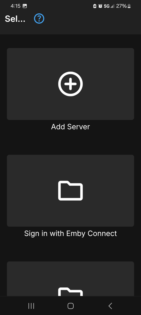

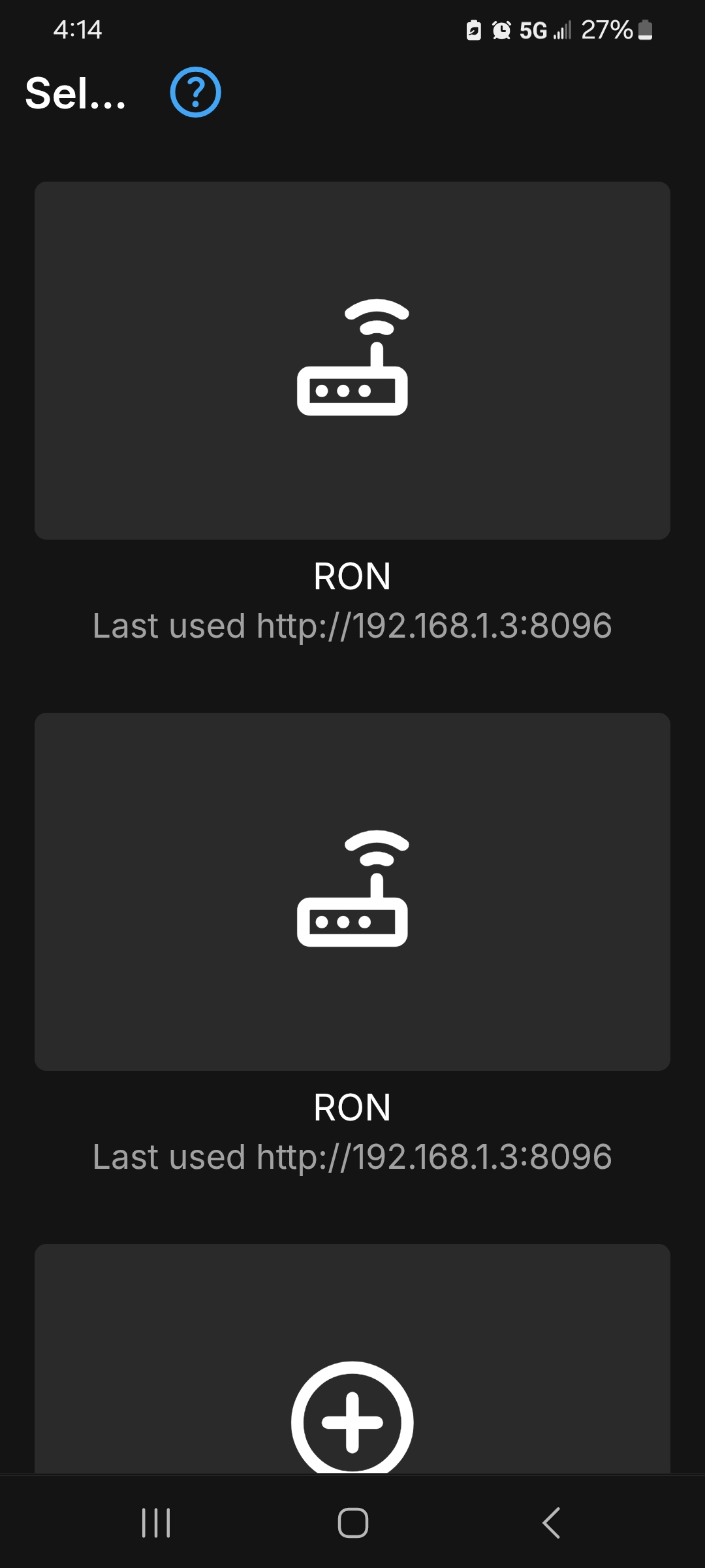

ron1423 0 Posted May 13, 2025 Author Posted May 13, 2025 Hi Luke When I'm home everything works perfect. When I'm away from home at work for example I go to sign in and it goes to the ad server page and it gives me my IP address the only one it shows is the one I use at home I try to put my wan in and it won't take it it says cannot connect. And when I try to sign in with emby connect it does the same thing it says it cannot reach my server at this time. But everything was working fine before I could access it at home at work in my truck I don't know what happened. I run Windows 11 pro with Xfinity Internet and a Netgear nighthawk cable modem and I checked last night everything is open to allow an incoming signal but I must be missing something anything you could help out with would be great.

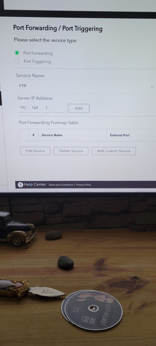

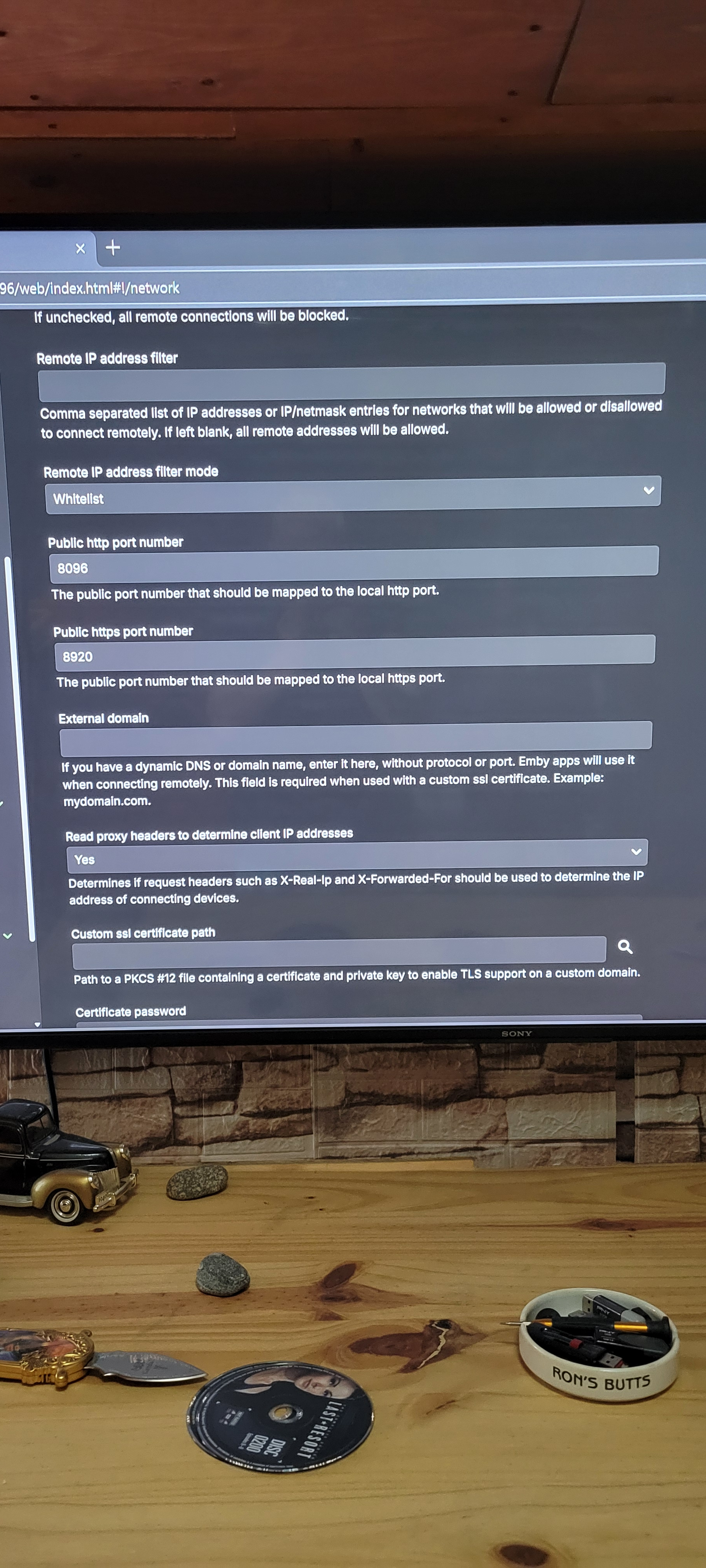

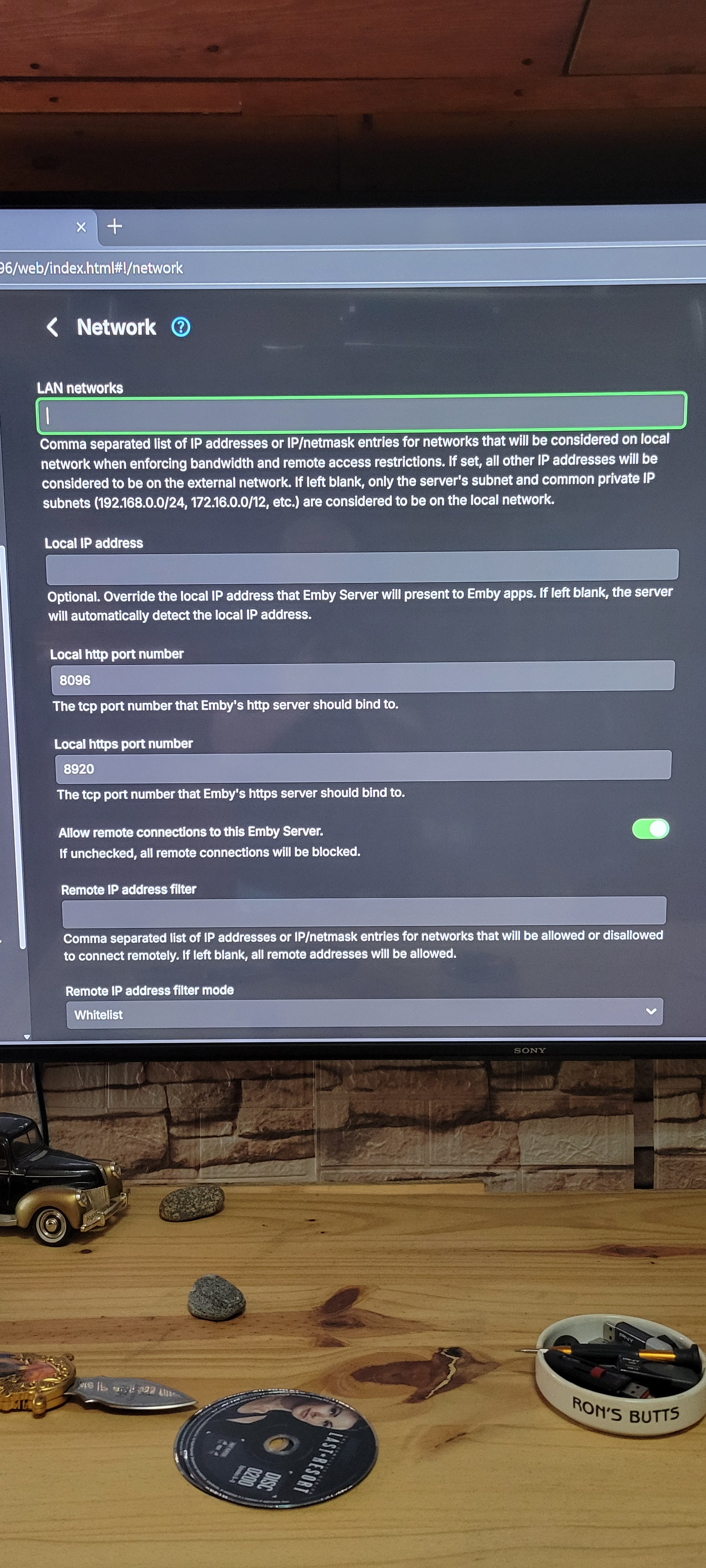

ron1423 0 Posted May 13, 2025 Author Posted May 13, 2025 Sorry I meant yes I did. Do I have to fill any of this out like the remote IP address filter.
Luke 42301 Posted May 13, 2025 Posted May 13, 2025 11 minutes ago, ron1423 said: Sorry I meant yes I did. Do I have to fill any of this out like the remote IP address filter. No, you don't. Can you show us how you setup port forwarding in your router?

Luke 42301 Posted May 13, 2025 Posted May 13, 2025 Did you actually add any port forwarding rules? Connecting from Client Apps
ron1423 0 Posted May 13, 2025 Author Posted May 13, 2025 sorry i'm not very good at this stuff i just know enough to get by. no i did not & no idea where to do it

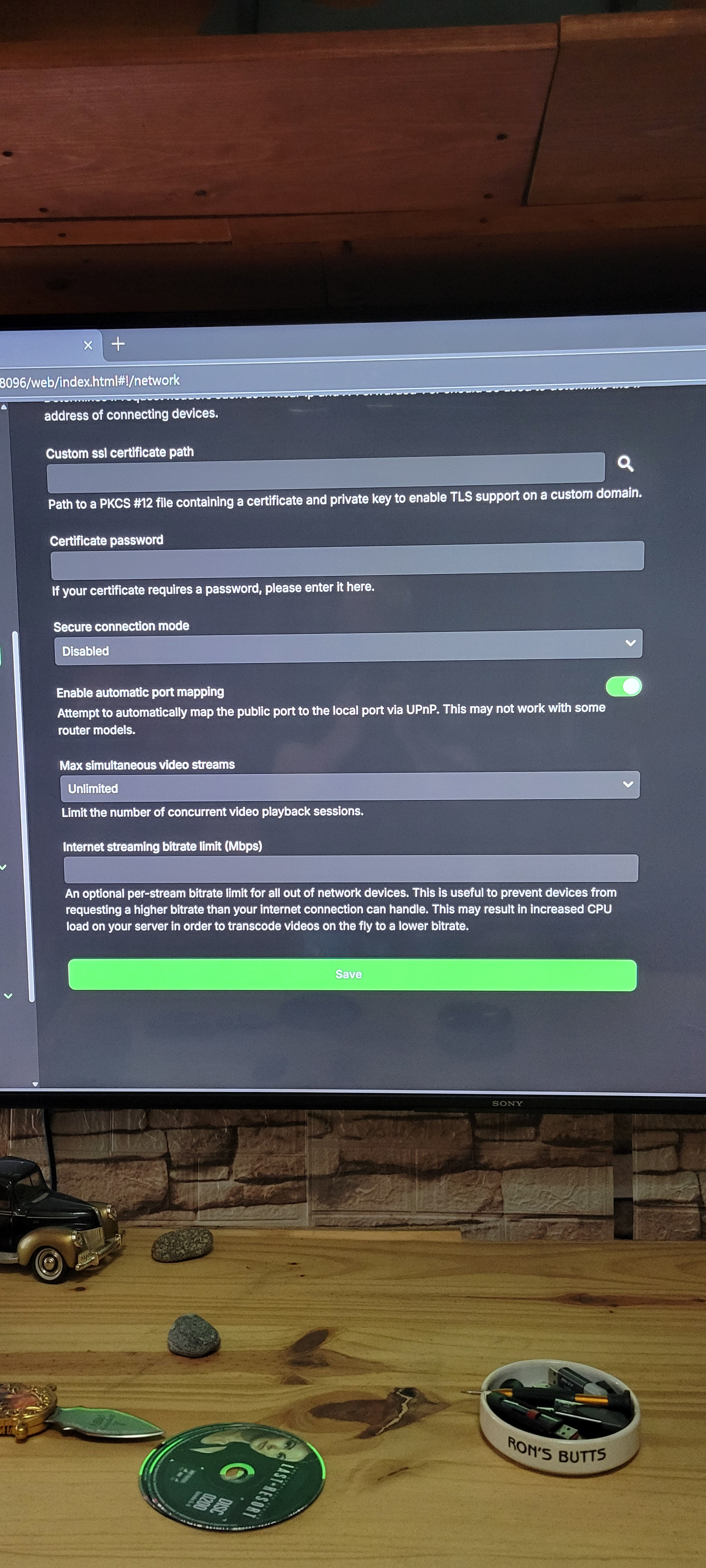

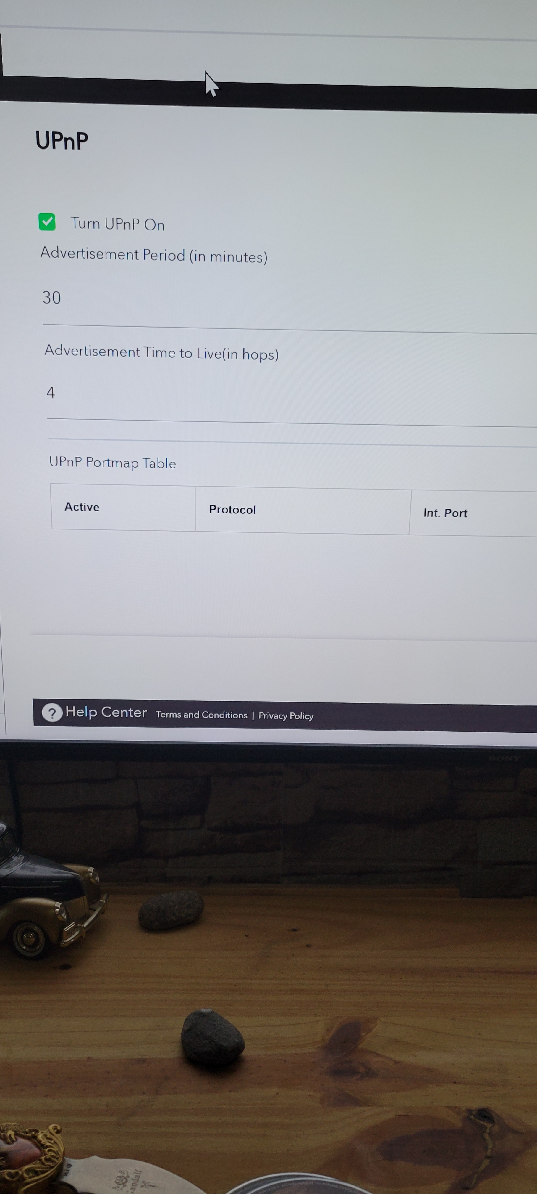

pwhodges 2039 Posted May 14, 2025 Posted May 14, 2025 You have uPNP enabled in yopur router, so Emby should be ab;le to set up the port forwarding - but this can be disabled in the Network setup[ in Emby. You should check whether it's currently enabled. Paul
