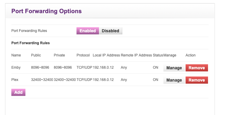

Luke 42237 Posted May 12, 2025 Posted May 12, 2025 Can you show us how you setup port forwarding in your router?
craggy 2 Posted May 12, 2025 Author Posted May 12, 2025 Attached is the 1st router setup. I have assumed that the IP address I need to enter is the IP address of the attached ZenWiFi router. Is that correct?
seanbuff 1354 Posted May 13, 2025 Posted May 13, 2025 3 hours ago, craggy said: I have assumed that the IP address I need to enter is the IP address of the attached ZenWiFi router. Is that correct? You could have a Double NAT situation with your two routers. Please review the "Multiple Routers" section carefully: https://emby.media/support/articles/Connectivity.html#multiple-routers Also, we've seen issues in the past when forwarding both TCP and UDP protocols. Try to select TCP only.
