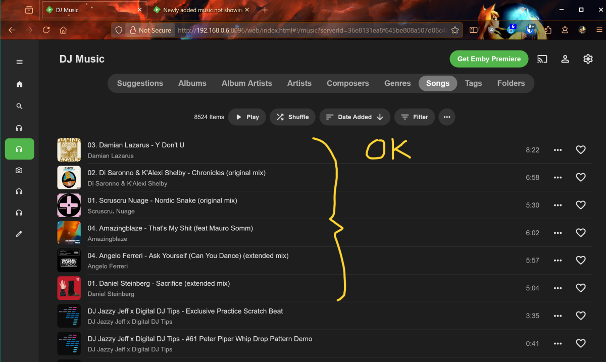

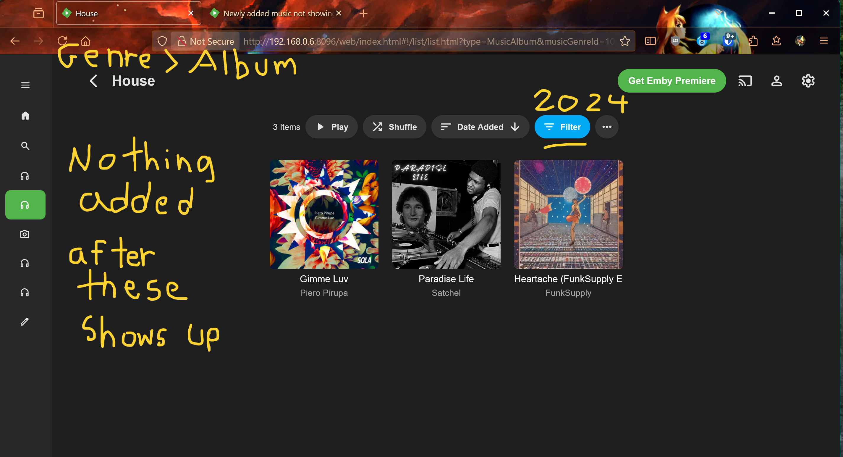

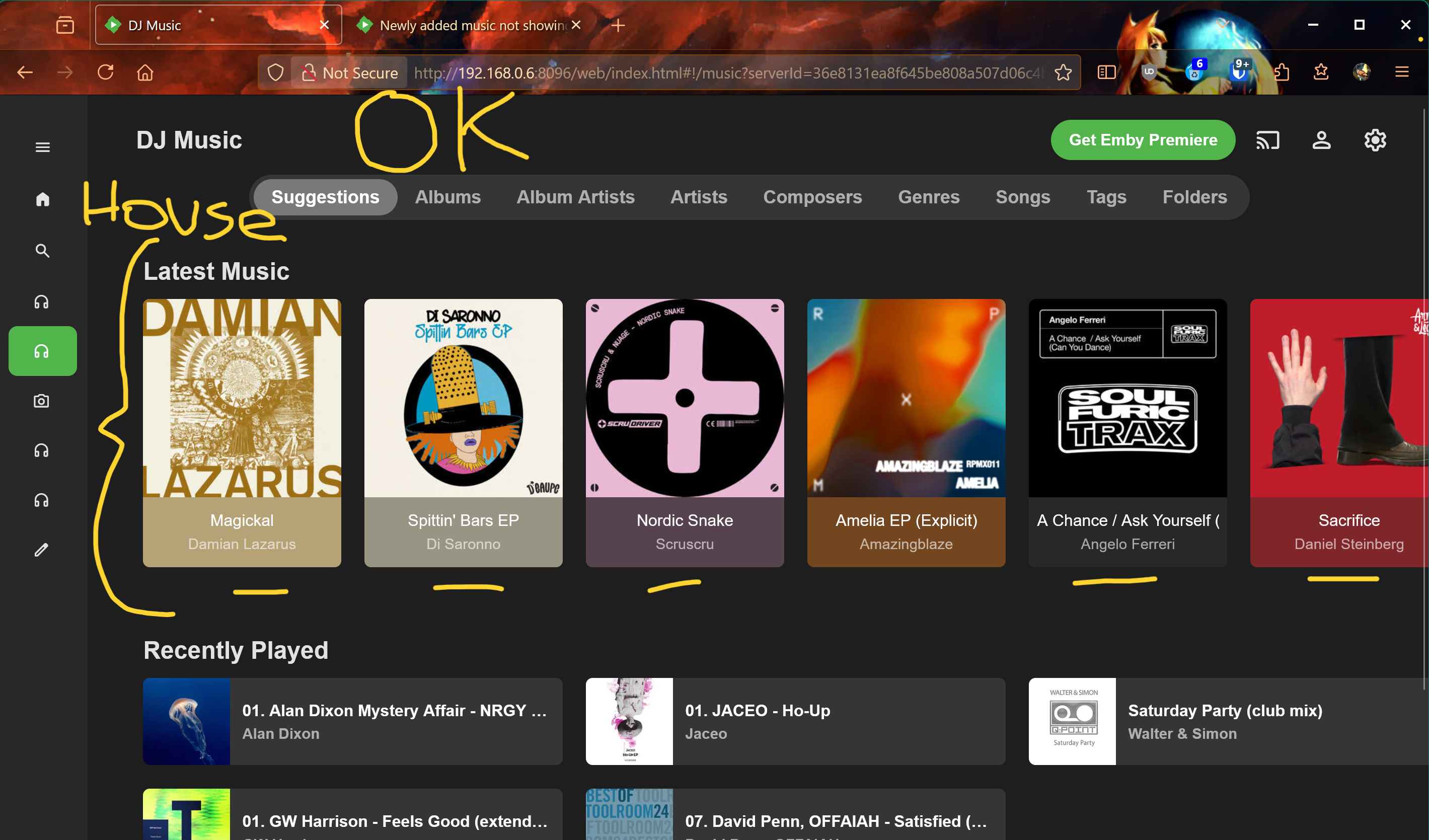

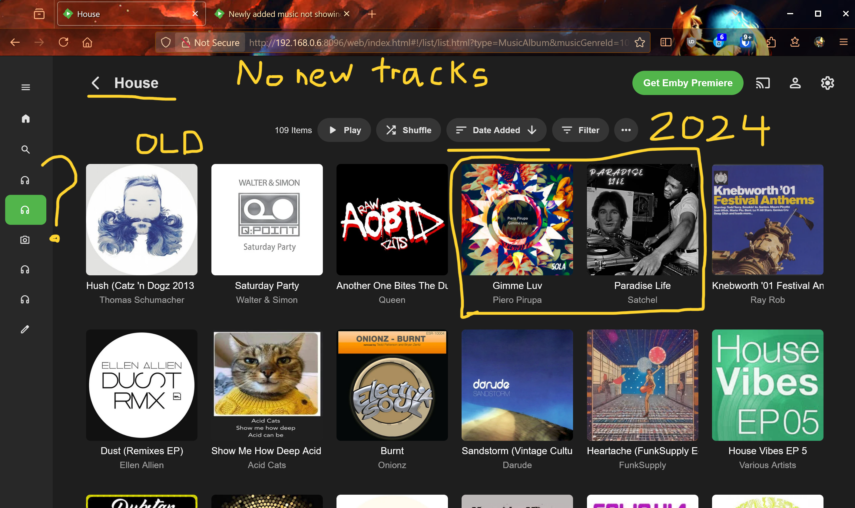

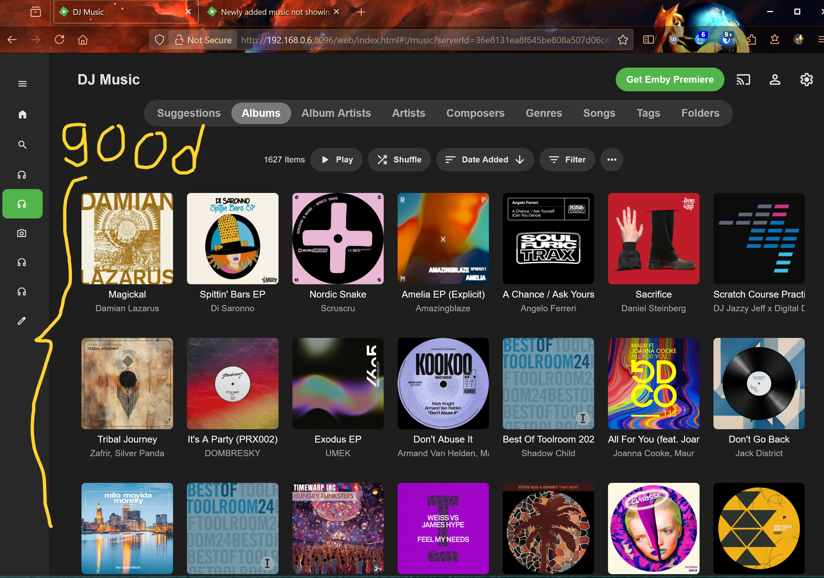

FunkyB 4 Posted April 27, 2025 Author Posted April 27, 2025 I'm not sure how to show this except post a bunch of screenshots. Sorry for the massive images. The same thing happens if I open it on mobile or another browser. It's also the same whether I log in to my admin account or normal account. I double-checked and the "emby" user has Read/Write permission on the Music folder where all of these are stored. Suggestions view - everything shows OK: (the underlined ones are from 2025) Albums view - all OK: Songs view - again. no problem: Artists and Composers also display as expected. But with Genre, newer tracks are just not there. Genre > House: Even if I Filter to 2024 (there isn't even a 2025 for date added): I hope that helps show the situation. Any idea how I can further troubleshoot this?
Luke 42301 Posted April 27, 2025 Posted April 27, 2025 Quote Even if I Filter to 2024 (there isn't even a 2025 for date added): Hi, what do you mean by this? There is no year filter for date added. What you are referring to is the release year value. Do your albums have these values filled in? You can check in the metadata editor.

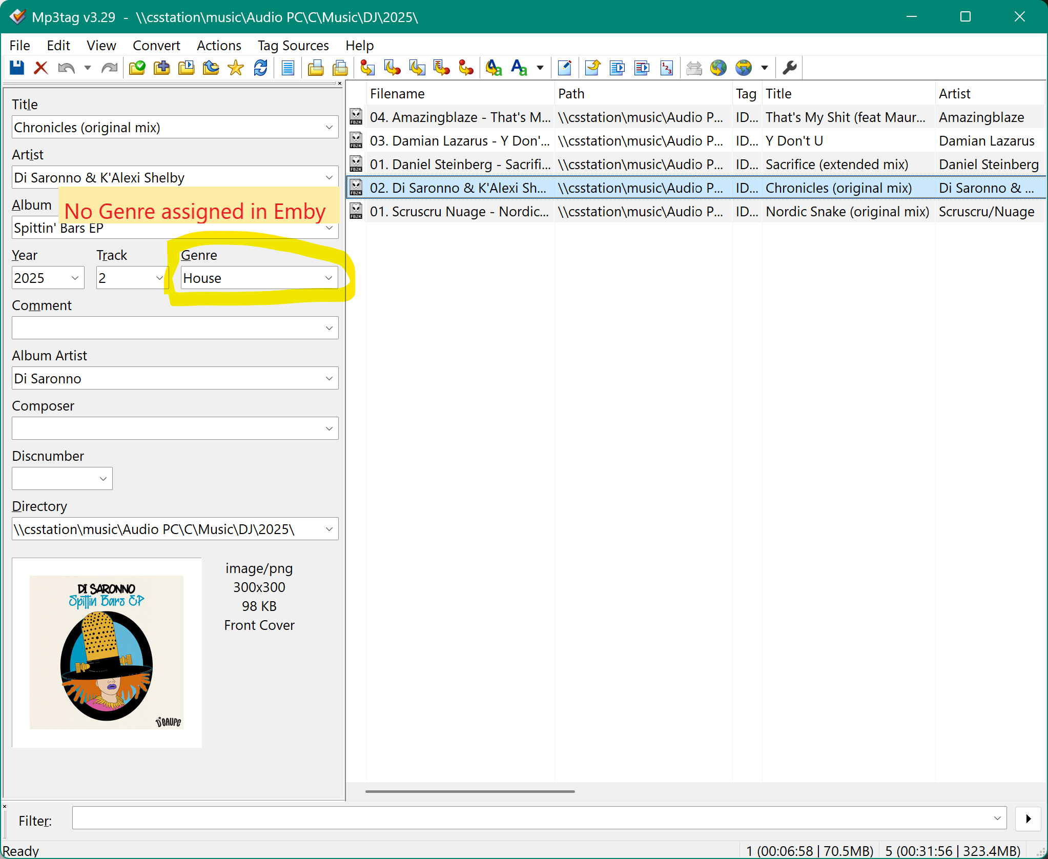

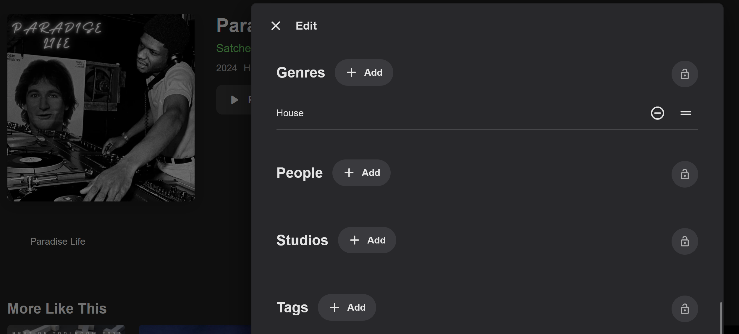

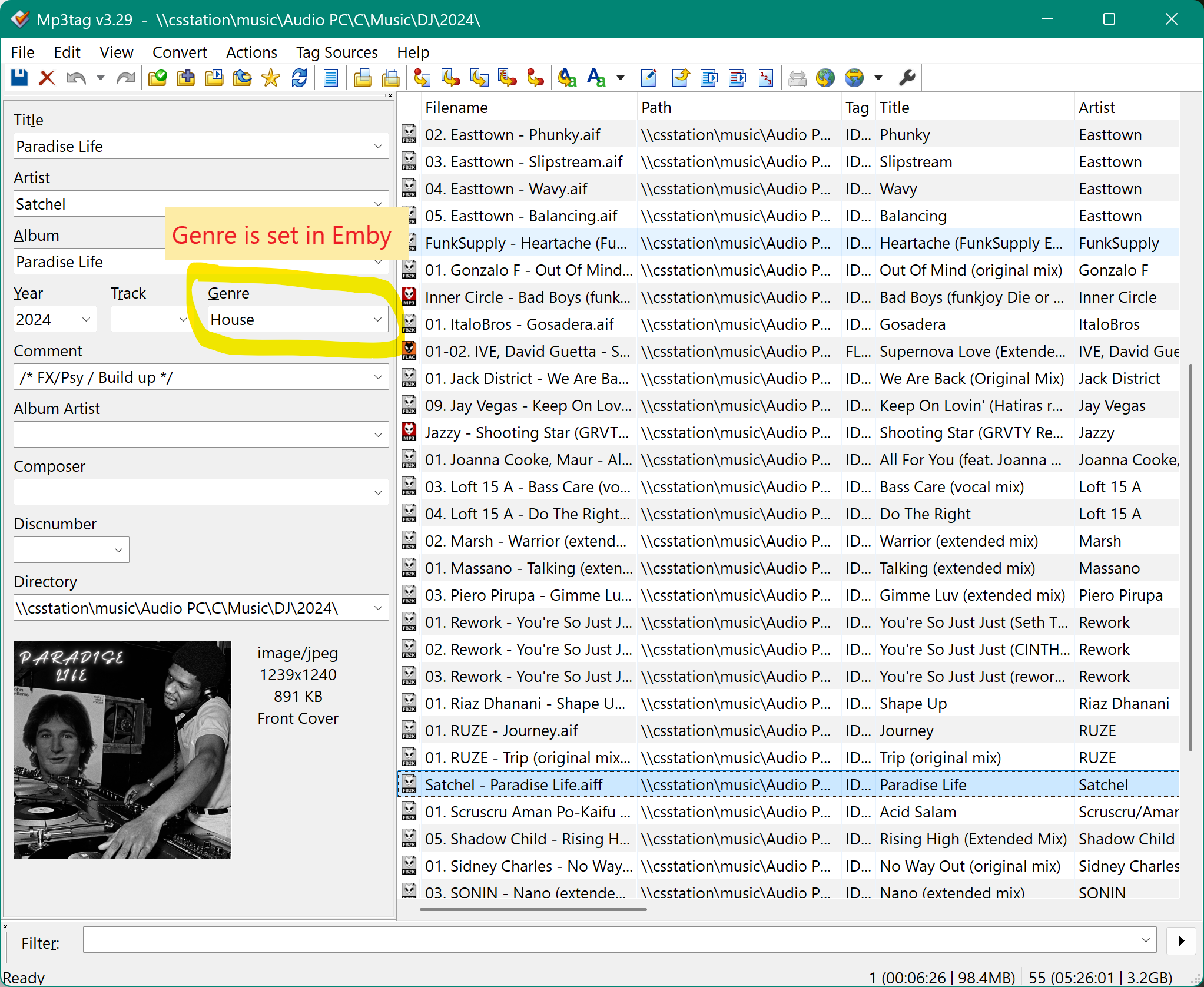

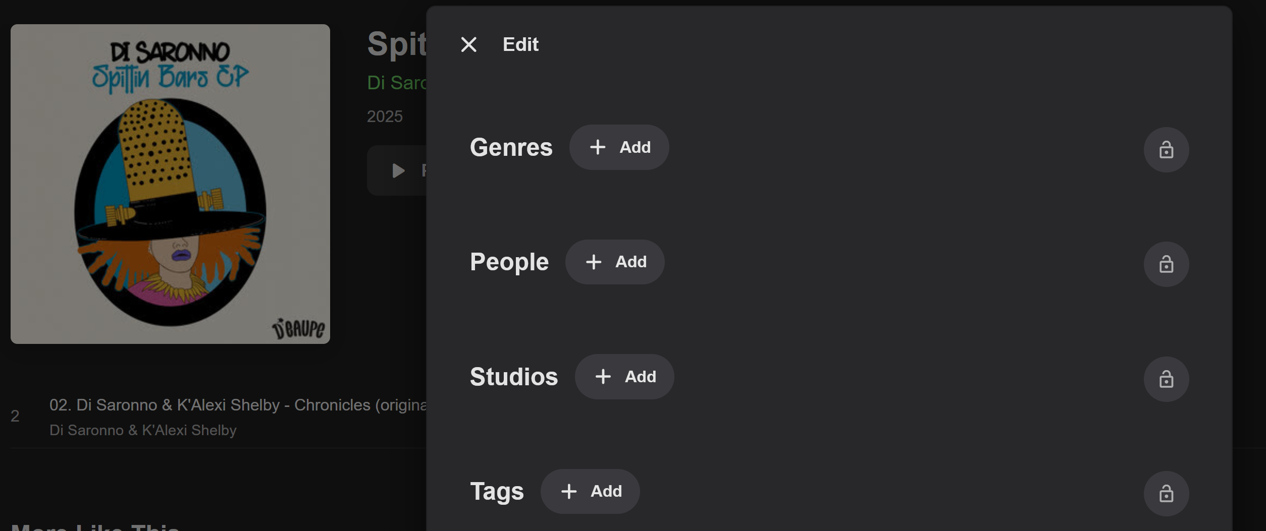

FunkyB 4 Posted May 6, 2025 Author Posted May 6, 2025 Filtering the year in the last screenshot was just to drill down on newer tracks. The filters are all working for me as intended. I've found the issue, though. When I open the metadata editor in Emby on any of the tracks that aren't showing under Genre, there is no Genre assigned to them. If I manually add a Genre there, the track immediately shows up in the Genre tab. So the problem is that for some reason Emby isn't reading the genre tags from track metadata for tracks added sometime after the last install. To double check, I opened both an older track (Paradise Life) and a newer one (Chronicles - that Emby doesn't show a genre for) in MP3Tag, and both have the same genre. There are no ghost trailing spaces or anything either - they are exactly the same. Note that for the track Paradise Life, I did not edit anything in Emby to assign a Genre. I only tagged it before copying it into my library and Emby detected it automatically. Do I need to do a manual re-fresh to re-read the metadata, or is there some setting that maybe I turned off by mistake? I looked through but didn't see anything (however, I also missed the metadata editor :).

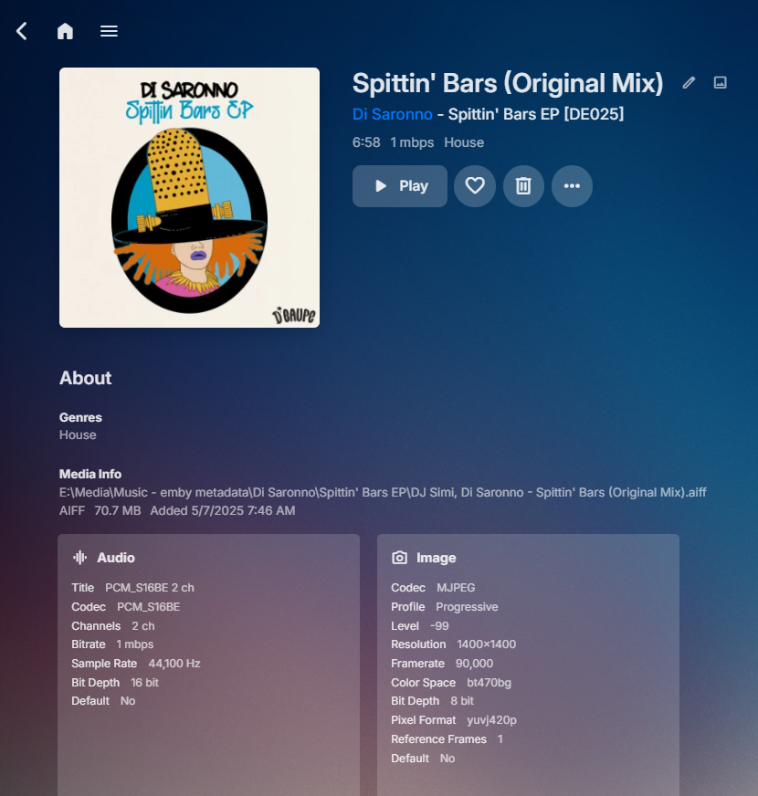

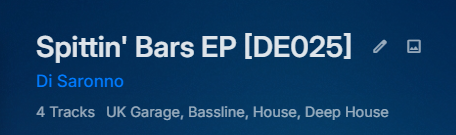

Happy2Play 9814 Posted May 7, 2025 Posted May 7, 2025 (edited) Not sure unless something appears in the server log during import as I get this for aiff and mp3 formats. Only thing I changed on orginal tags is ARTIST to secondard line but could have used semicolons instead. And added AlbumArtist. <?xml version="1.0" encoding="utf-8" standalone="yes"?> <album> <review /> <outline /> <lockdata>false</lockdata> <dateadded>2025-05-06 07:05:55</dateadded> <title>Spittin' Bars EP [DE025]</title> <sorttitle>Spittin' Bars EP [DE025]</sorttitle> <runtime>26</runtime> <genre>UK Garage</genre> <genre>Bassline</genre> <genre>House</genre> <genre>Deep House</genre> <artist>DJ Simi</artist> <artist>Di Saronno</artist> <artist>K'Alexi Shelby</artist> <albumartist>Di Saronno</albumartist> </album> Edited May 7, 2025 by Happy2Play
