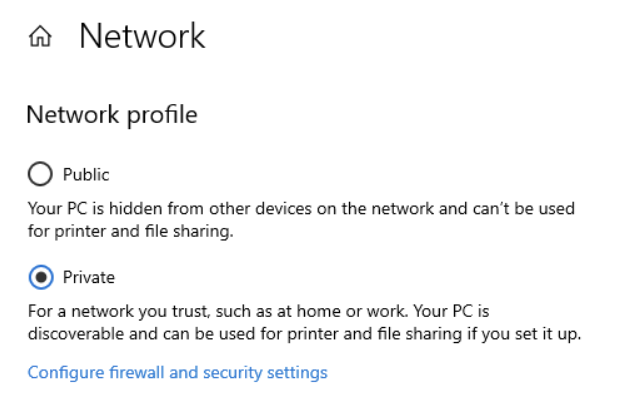

seanbuff 1353 Posted April 21, 2025 Posted April 21, 2025 4 hours ago, Spirosp8 said: With the desktop it works internally, but when trying to access it come up with Unable to reach server error message Is the desktop Windows by any chance? If so, have you verified the Network Profile is set to Private and not Public?
Solution Spirosp8 1 Posted April 21, 2025 Author Solution Posted April 21, 2025 Hi I checked that and was set up correctly. I connected the laptop to lan and had the same issue as the desktop. Check the switch and then logged into the router and checked that upd was allowed it was. So ended up connecting it to the router, no good then disabling and re-enabling udp it and then it all worked. Sorry for the hassle. 1
