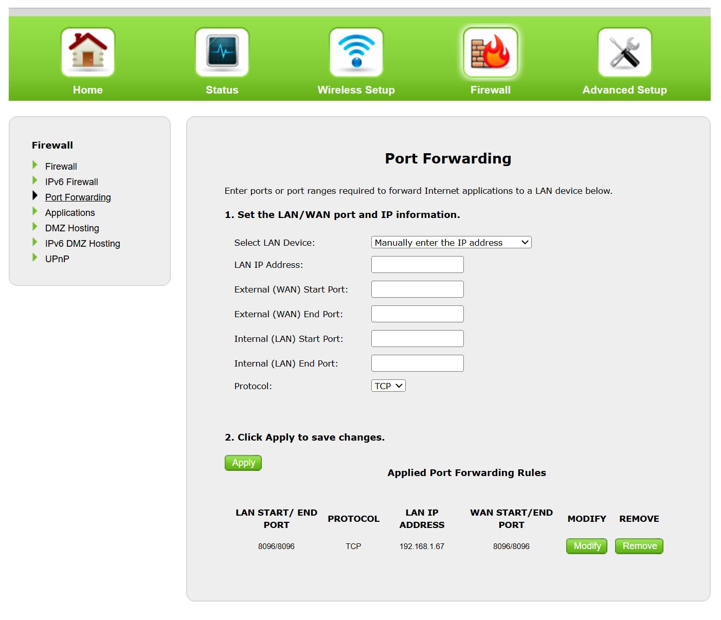

jake0077 4 Posted March 19, 2025 Author Posted March 19, 2025 Here's a screenshot of my port-forwarding page on my router.
Luke 42290 Posted March 19, 2025 Posted March 19, 2025 OK so looks like you forwarded 8096. Are you sure that is the correct LAN ip address?
jake0077 4 Posted March 19, 2025 Author Posted March 19, 2025 That is In-Home (LAN) access address listed on my server page. When I do a port check, it shows 8096 is open but not when connected to vpn.
