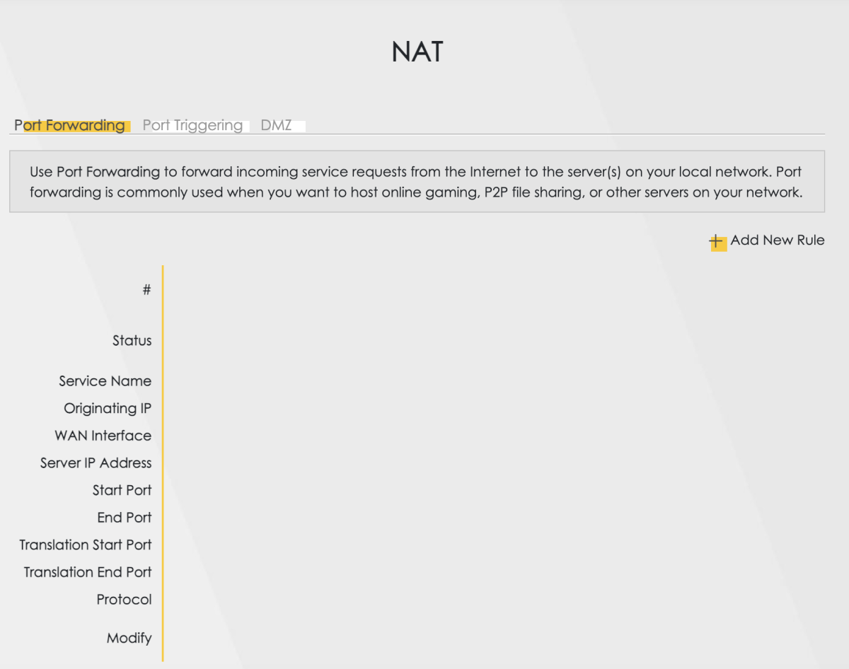

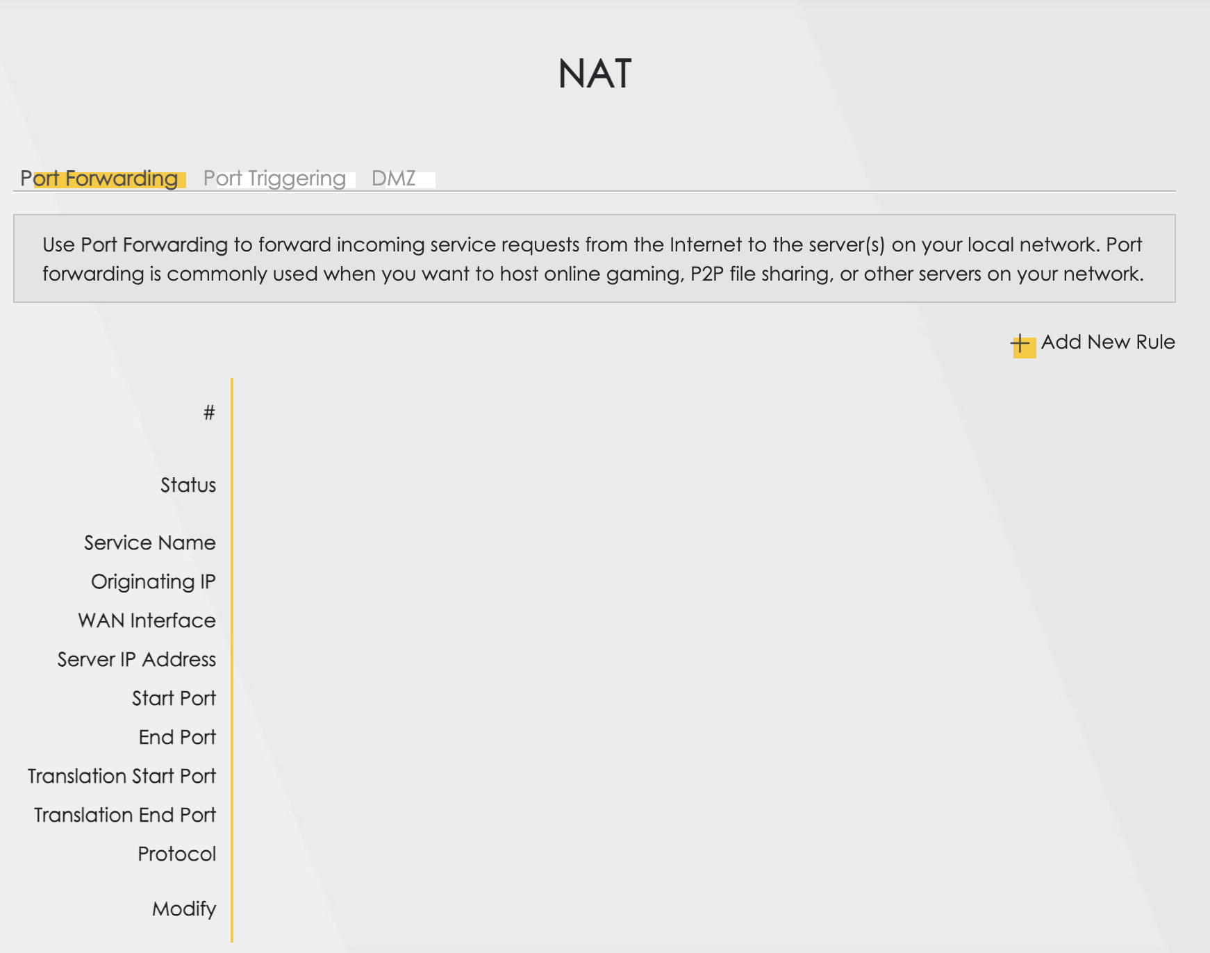

johnlumgair 3 Posted March 18, 2025 Author Posted March 18, 2025 Thank you., Sorry I wasn't at home so I didn't get a chance to check but now I have. I've changed my ISP a few times since having this NAS; this is the one that has been tricky. The IP address is a higher number it starts with 140 I don't understand what cgNAT when I log in I can see section called NAT but I don't know what to do thanks again
pwhodges 2039 Posted March 18, 2025 Posted March 18, 2025 cgNAT is nothing to do with your router. It is implemented in the ISP's network, and prevents you getting into your network from outside. All you can do is see if you're behind it, and if so ask your ISP to change it for you (probably at a price) or find a way around it (e.g. Tailscale or some other tunnel). If your IP address starts with 140, you are likely not behind cgNAT, but doing a tracert to some outside address and posting the result here would enable us to confirm that. Paul
