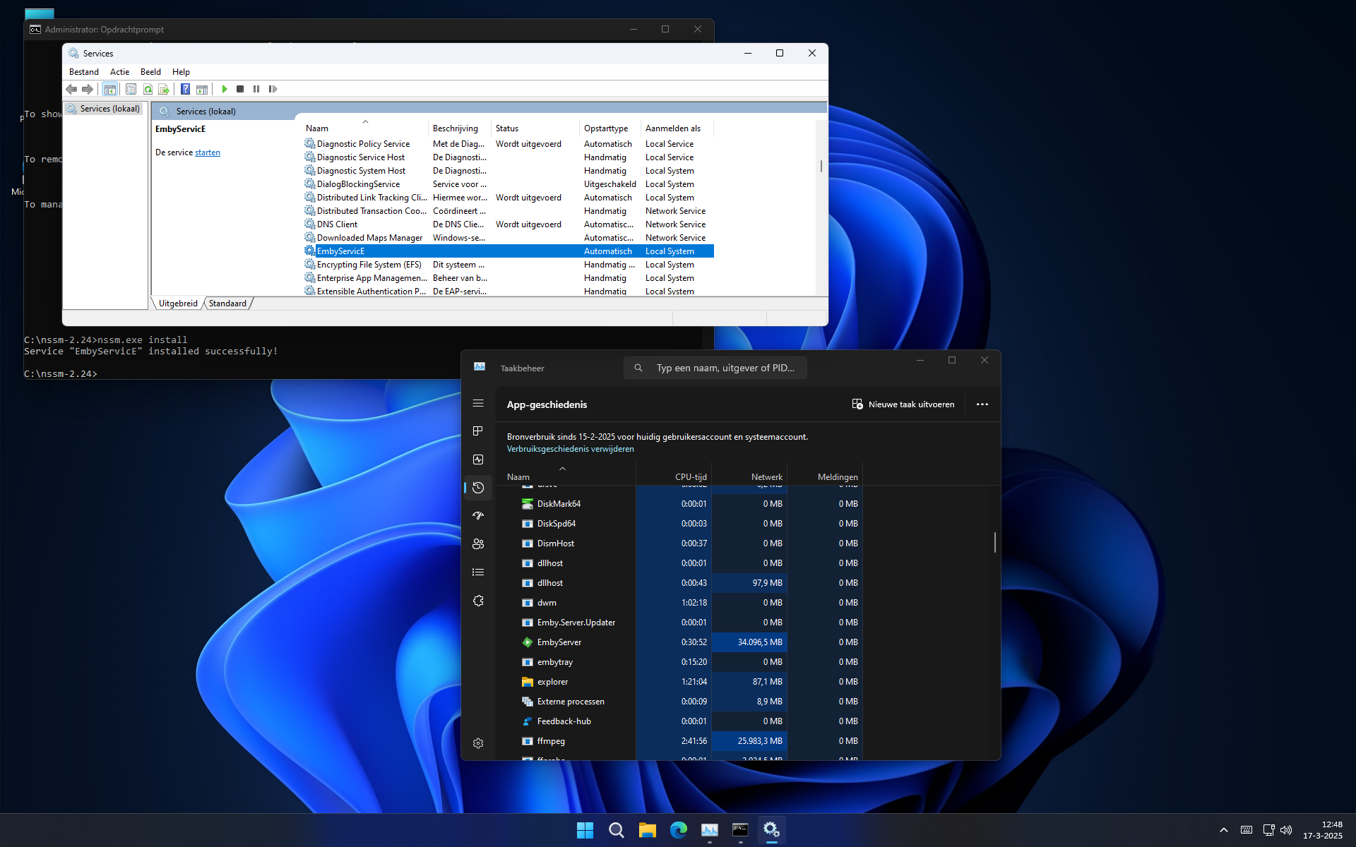

Luke 42178 Posted March 17, 2025 Posted March 17, 2025 hi, looks like you've somehow managed to get multiple instances of the server running, probably due to the windows service. You probably have both the windows service and the application running at the same time, and this can cause problems. You may want to disable the windows service until you find the source of this. Please let us know if this helps. Thanks. 1

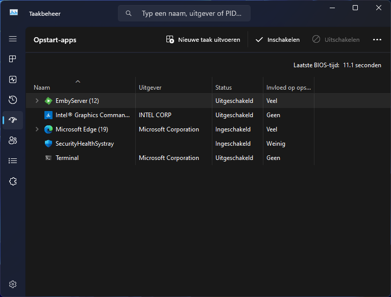

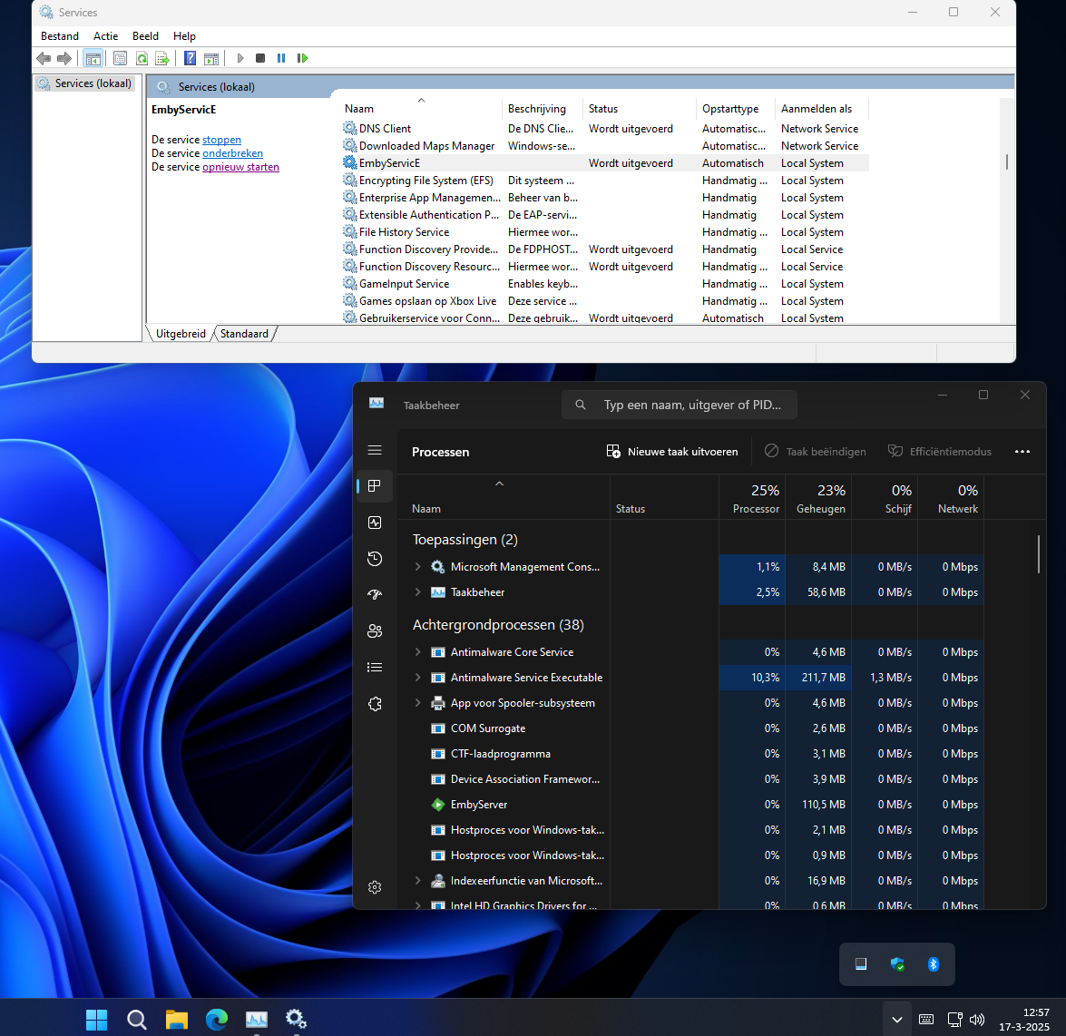

aarbee 6 Posted March 17, 2025 Author Posted March 17, 2025 What did I do: I went into Windows taskmanager. And switched off under Starting apps: Embyserver. I looked in the system tray and stopped Emby there. Rebooted the computer. Installed Emby as a service. Rebooted again, but did not login. And was confronted with the error again. I did check the taskmanager and nothing is running. I have attached a new logfile too. Thanks ahead, RobB embyserver-63877812993.txt

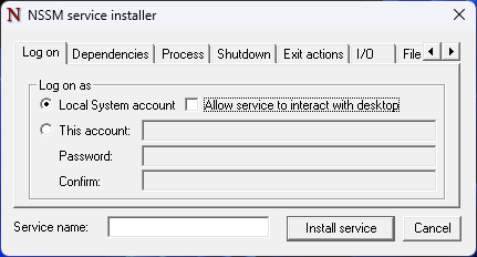

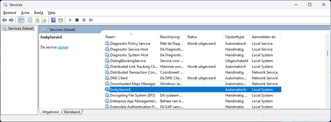

Luke 42178 Posted March 17, 2025 Posted March 17, 2025 25 minutes ago, aarbee said: But if I am logged in to that pc (via rdp) I have access to the //path and through a driveletter. So perhaps, because I logged in to the pc, through the admin1.local and connecting to the nas via sharename.nas/shareuser.nas, which works when regular logged in, but has different behaviour under service? Which user must I fill out then? The shareuser.nas or the admin.local? Because in principal, I do "not know" who the viewer is. Can be any friend, family. Right but you logging into the PC is not the same as how the windows service will execute. Note that in the screenshot it says "local system account". This is not the same thing as your windows account. 1
aarbee 6 Posted March 17, 2025 Author Posted March 17, 2025 I am logging in with the only admin I have on that pc. I guess that must be the local system account. But I will create a new service, and fill in that admin account on "this" account. RobB
Solution Luke 42178 Posted March 17, 2025 Solution Posted March 17, 2025 17 minutes ago, aarbee said: I am logging in with the only admin I have on that pc. I guess that must be the local system account. But I will create a new service, and fill in that admin account on "this" account. RobB Hi, no, as I just mentioned, it is not the same as your windows account: https://stackoverflow.com/questions/510170/the-difference-between-the-local-system-account-and-the-network-service-acco 1

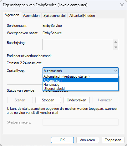

Neminem 1591 Posted March 19, 2025 Posted March 19, 2025 Try setting the service start to Delayed, that way your file mounts have time to get online, before Emby starts. 2
aarbee 6 Posted March 19, 2025 Author Posted March 19, 2025 I can do that. I would think, that if the PC switches on at 14:00 and I try to play the movie at 17:00 it would be time enough. But I understand what you say. Suppose the service started before the network connection, it hangs behind. RobB
Neminem 1591 Posted March 19, 2025 Posted March 19, 2025 Yes that's my theory and it will never work until service restart. 1
aarbee 6 Posted March 19, 2025 Author Posted March 19, 2025 I can only delay the startup. Lets hope that is enough time then. 1
Carlo 4561 Posted March 20, 2025 Posted March 20, 2025 All your NSSM pics show use of the local system account. You want to create an account on the computer that has access to all your content and use this account to run your Emby Server service. Carlo 1
aarbee 6 Posted March 21, 2025 Author Posted March 21, 2025 The delayed Service loading did the trick. Thanks @Neminem Afterwards it is logical, but I did not think of it. You did. I will test a few days with auto shutdown and auto start and report then back. I am happy. RobB 1 2
