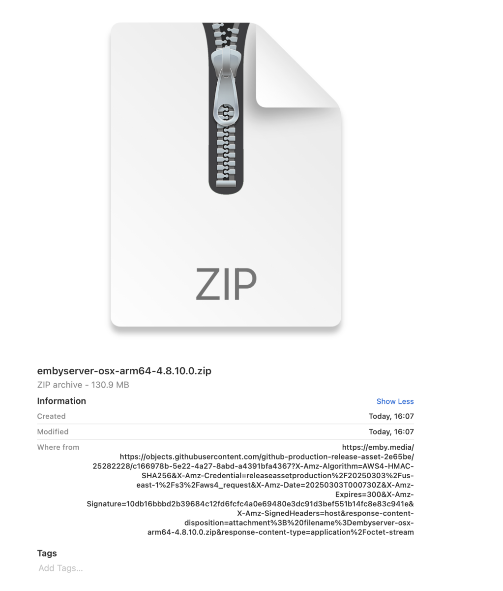

rayyr 0 Posted March 3, 2025 Posted March 3, 2025 I downloaded the file from the official emby website. After installation, I double clicked but nothing happened. I tried both version 4.8.10 and beta 4.9.0.40 and both of them can't work. I tried to see whether it is actually working so I go to http://localhost:8096/ but still shows This site can’t be reached localhost refused to connect. Can anybody tell me what's the problem? My chip is M4 Pro. Mac OS version 15.3.1 (24D70)

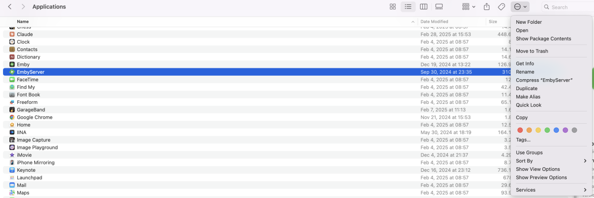

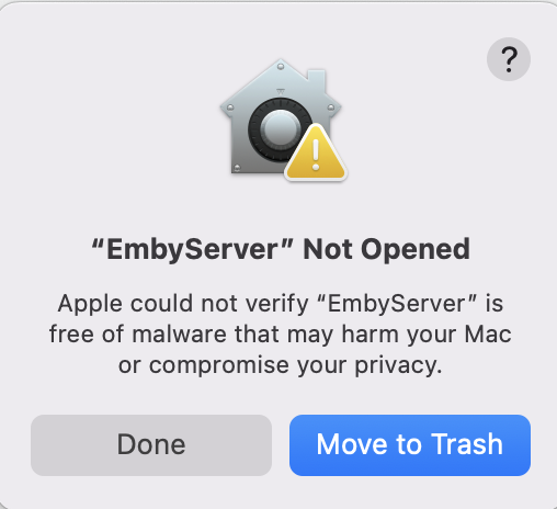

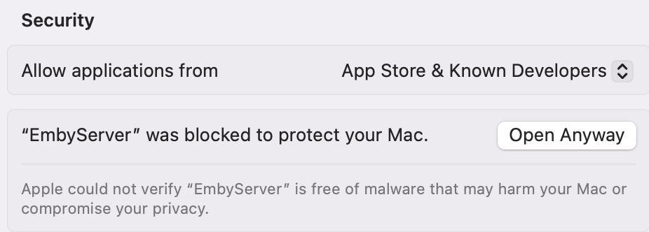

rayyr 0 Posted March 3, 2025 Author Posted March 3, 2025 Well, I just uninstalled and install again with the instruction. After unzip, I drag the app into Applications. The instruction said 'If you're unable to start due to a message about unidentified developer, start Emby Server by clicking the settings icon, then Open'. I think there is no settings icon on the new Mac OS, so I guess it means the icon shown below. After I click open the message in my computer is like this. I have to go to Settings - Privacy and Security and click Open Anyway. I tried the above action again and still nothing happens like before. Only a zoom-in and zoom-out transition on the icon, you know.

Luke 42237 Posted March 6, 2025 Posted March 6, 2025 On 3/2/2025 at 10:54 PM, rayyr said: This would seem to suggest that you never got the server to run at all. @sa2000how do you have your "allow applications from..." option set?
sa2000 695 Posted March 6, 2025 Posted March 6, 2025 (edited) On 03/03/2025 at 03:54, rayyr said: I think this is probably similar to the ownership/permissions issue I investigated here To check if it is the same issue, in terminal session, do the following: ls -ail /Users/rty/.config Copy the output from this Then ensure Emby Server is not already running as checked in Activity Monitor and try and launch it in terminal cd /Applications ./EmbyServer.app/Contents/MacOS/EmbyServer Save the output into a text file - It would show the permissions error if this is the same problem as the one I linked If it is the permissions / ownership issue, then try this command in terminal sudo chown rty /Users/rty/.config See if that resolves the problem 3 hours ago, Luke said: how do you have your "allow applications from..." option set? Same : "Allow applications from - App Store & Known Developers" This in itself does not help and one would need then to select Open Anyway from the link that gets displayed below this security setting. And there was no option to Move it to the Applications folder. Only way was to drag and drop. Edited March 6, 2025 by sa2000 1
