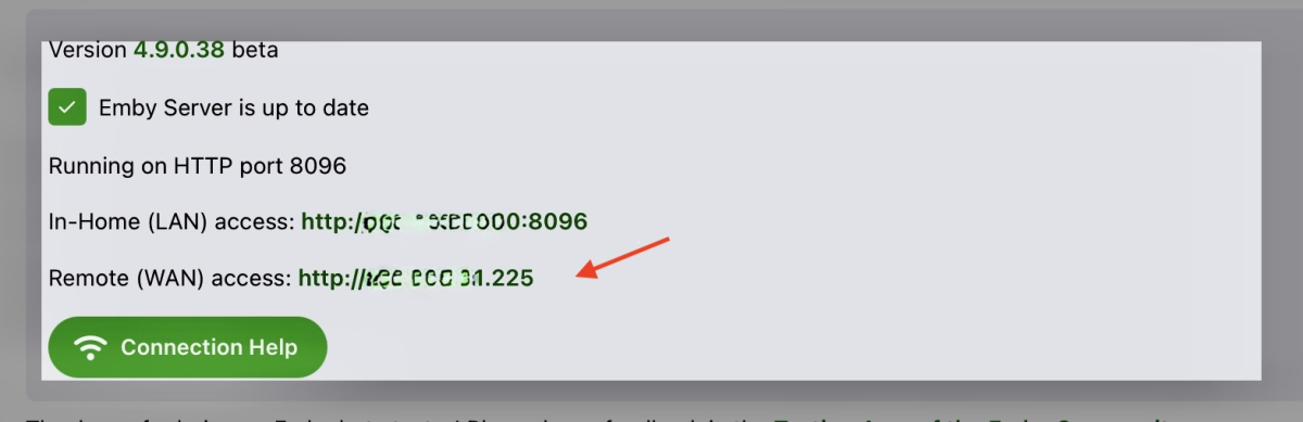

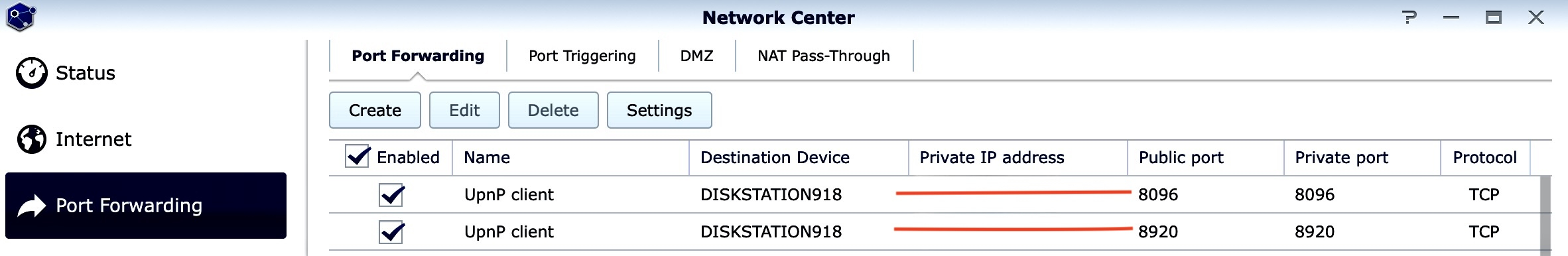

Blue278 22 Posted February 13, 2025 Author Posted February 13, 2025 Hi, "We're unable to connect to the selected server right now. Please ensure it is running and try again" I've tried the port forwarding with my Synology RT6600AX without luck. Thanks

Luke 42237 Posted February 13, 2025 Posted February 13, 2025 7 minutes ago, Blue278 said: Hi, "We're unable to connect to the selected server right now. Please ensure it is running and try again" I've tried the port forwarding with my Synology RT6600AX without luck. Thanks What exactly did you setup in port forwarding?

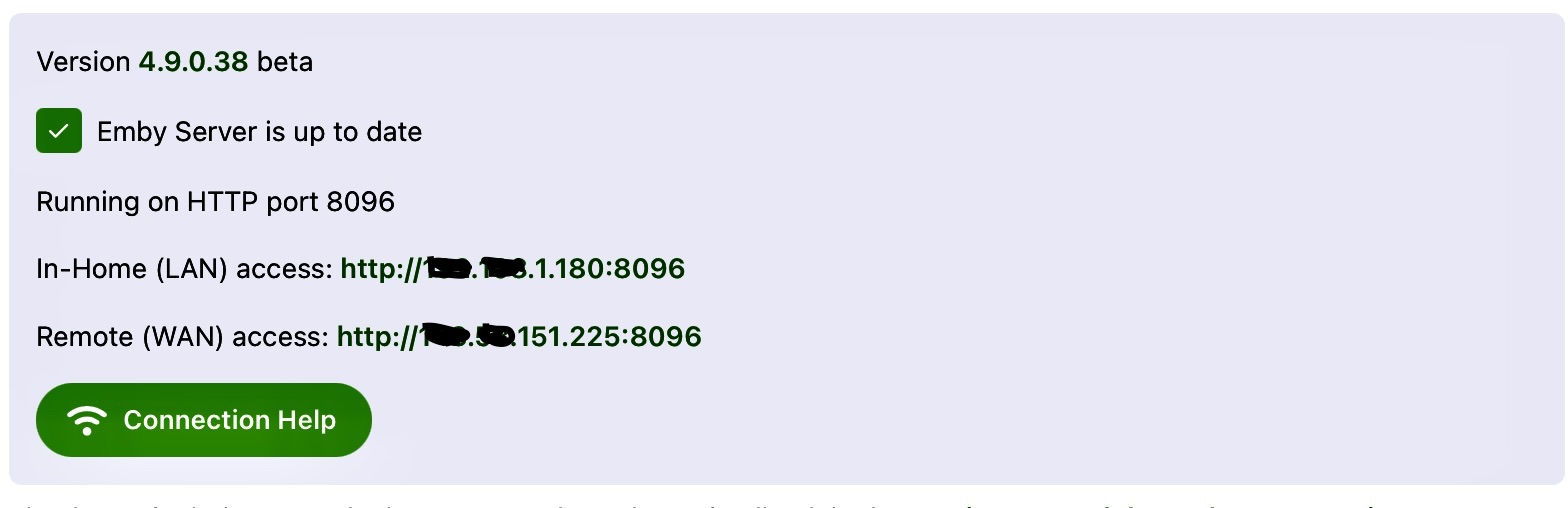

yocker 1410 Posted February 13, 2025 Posted February 13, 2025 20 hours ago, Blue278 said: No idea if it will help but try and give LAN and WAN each their own port. Fx. Lan - > Port 8096 Wan -> Port 80 port forward port 80 to Emby, when connecting to Emby from the internet use port 80 and on local use 8096. If this works then after that you should look into doing some safety work, mainly getting HTTPS up and running as just running HTTP is wildly insecure. Thinking that the way you have set it up might cause conflicts having the same port used multiple times for the same program.
Blue278 22 Posted February 14, 2025 Author Posted February 14, 2025 9 hours ago, Luke said: @Blue278 has this helped? When I change the port to 80, it’s blank.
Blue278 22 Posted February 14, 2025 Author Posted February 14, 2025 10 hours ago, yocker said: No idea if it will help but try and give LAN and WAN each their own port. Fx. Lan - > Port 8096 Wan -> Port 80 port forward port 80 to Emby, when connecting to Emby from the internet use port 80 and on local use 8096. If this works then after that you should look into doing some safety work, mainly getting HTTPS up and running as just running HTTP is wildly insecure. Thinking that the way you have set it up might cause conflicts having the same port used multiple times for the same program. Can changing HTTP to HTTPS be done within emby?
yocker 1410 Posted February 14, 2025 Posted February 14, 2025 (edited) 1 hour ago, Blue278 said: When I change the port to 80, it’s blank. That's normal. 1 hour ago, Blue278 said: Can changing HTTP to HTTPS be done within emby? Not entirely. It's a little bit more complicated than that. The Emby team made a great guide for it that makes the whole process easier. https://emby.media/support/articles/Secure-Your-Server.html It is not necessary to use HTTPS, but it's good common practice to do so as it encrypts your connection. Just make sure that the admin account can't connect from the internet and you will be alright for now, Edited February 14, 2025 by yocker
