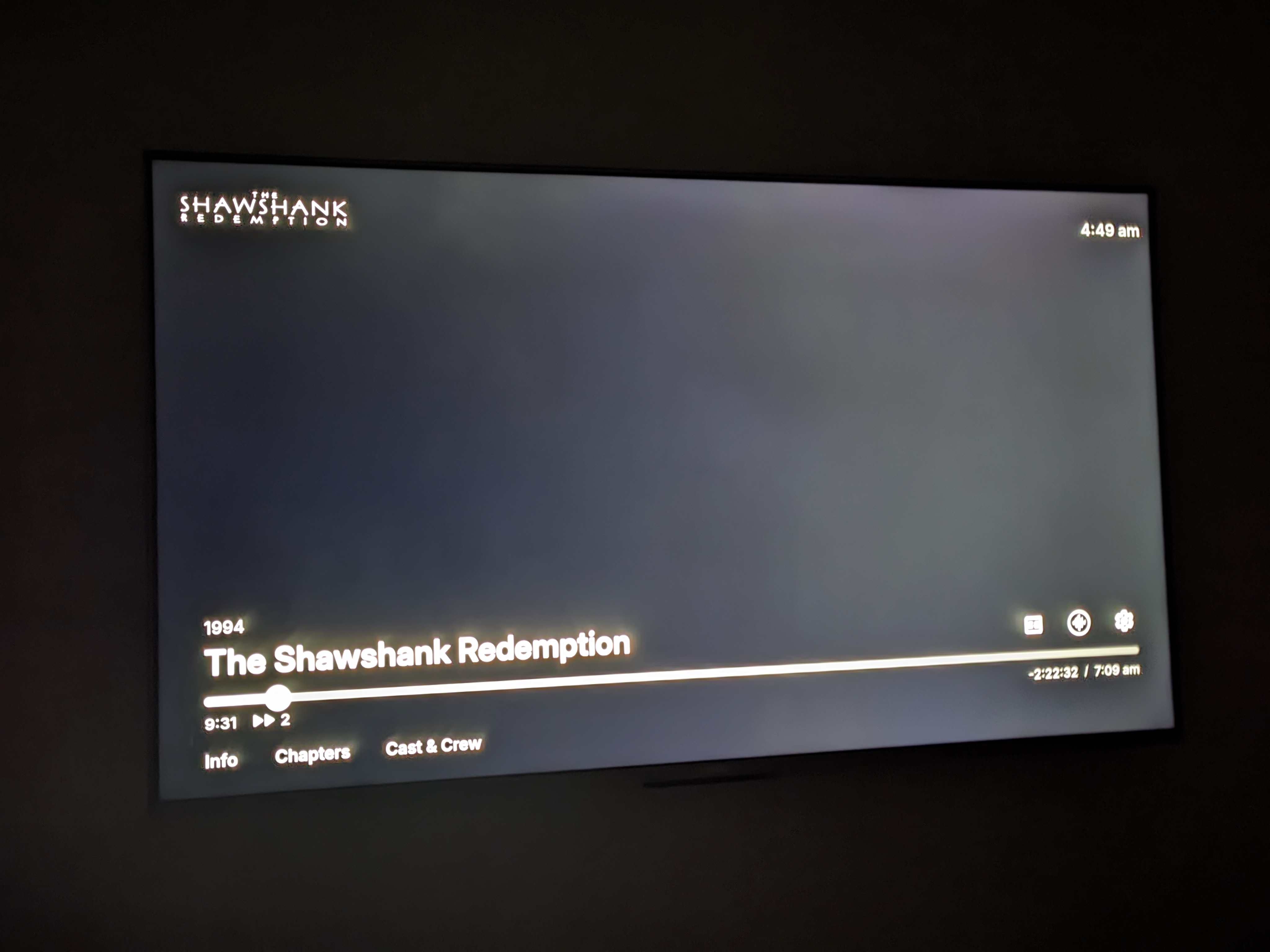

faandfo69 2 Posted February 28, 2025 Author Posted February 28, 2025 The standard android app cannot play anything that the emby android tv app is transcoding It just gives a black scenn and does not play(image posted on previous page) And yes no external speakers. Did you guys get any info as to why emby might be failing at software decoding automatically and forces transcoding?

faandfo69 2 Posted March 1, 2025 Author Posted March 1, 2025 Nothing happens it does not play at all via the standard android app
ebr 16336 Posted March 2, 2025 Posted March 2, 2025 No attempt to seek or pause/play or anything will make it start going?
faandfo69 2 Posted March 2, 2025 Author Posted March 2, 2025 Nope, the playback doesn't start. Stuck like this for past 5 minutes. I tried seeking and playing again and then ff to 2, 3 minute mark but nothing plays
Solution ebr 16336 Posted March 3, 2025 Solution Posted March 3, 2025 Okay, thanks. I think this is a hardware-specific issue but the standard app should be detecting that and falling back to transcoding.
