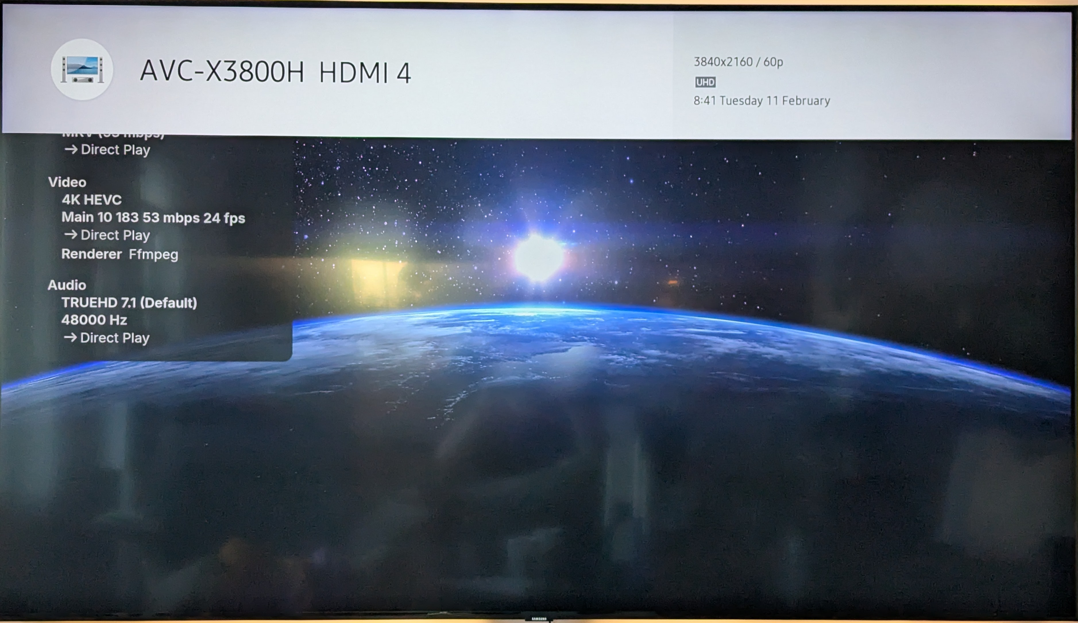

BTW cleared my head a little bit here now, checked my stats for nerds and info from tv. The Shield does not change the fps/Hz on this movie, like it does on other movies.
I tried to force it in the Android menu (Match frame rate Beta), no help. Maybe the problem is here.

VLC might be a bit more tolerant towards some files than Exoplayer (Used by Emby) so reason for it working there.
Btw.. My subwoofer and neighbors in a huge radius hate me now, the bass in the video i tested loud and i had forgotten to turn down my receiver from last i used it.
Edited by yocker
  • Thanks 1
It's good sound movies, and they should now what they are doing. But, maybe not 🙂
Would MkvToolNix do this for me?
Little bit new to encoding etc.
I do very little encoding, so know just as little about it but, any program that can encode should be able to do it, just remember to passthrough the audio (not re-encode that too)
Many people use Handbrake, it's a relatively easy program to learn.
  • Thanks 1
Hi again 🙂
Did you use Handbrake, if I can ask?
Tried it, and the file worked. But tried to set it to not do much with the video. But still it got encoded from 281Mb to 50Mb. The sound looks (mediainfo)and hears right, but I'll get a litte bit skeptical.
3 hours ago, PeteGul said:
Hi again 🙂
Couple of years since i used it for anything but let's see.
You seem to already know the basic like trowing the file in and getting an output so skipping that.
In the "presets" scroll down to the hardware presets and pick one that fits the graphics card / internal graphics you have, if you have fx. intel graphics then pick "H.265 QSV 2160p 4K", you can't pick wrong as those for graphics cards you don't have will be grayed out.
In format i would choose mkv
Since this is a file to test sound we don't really care about the video it self so in the other taps you just pick automatic, in the "filters" tap you disable all.
Here the one that matter:
In the audio tap you make sure the right audio track is chosen, in codec depending on audio format you choose ">insert name here<passthru" like fx. "TrueHDpasstru, that should leave the audio untouched.
Since you are going to use H.265 with this the file and no filters or other things are used the file might be considerably smaller, H.265 is a very efficient format.
The audio will remain untouched and have it's original size inside the video file.
And you are done.
