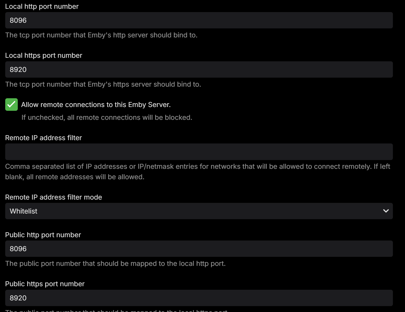

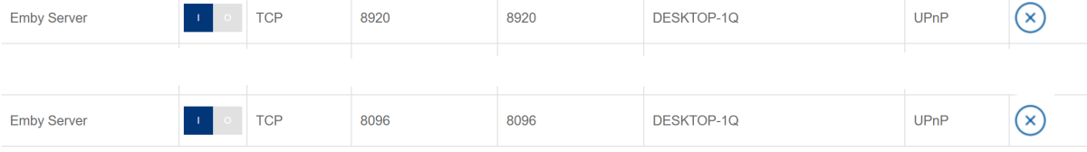

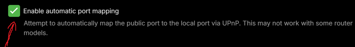

AndreiP 33 Posted January 28, 2025 Posted January 28, 2025 (edited) Hi the community, I would like to run 2 Emby servers on the same Internet network and make it so that I can access both from outside my home. I want that one will be basic and the second one will be use as a test server. After reading all the information found on the forum I would like to publish here to be sure that I have understood how to configure the second server. I also hope that my message will be useful for all users with the same situation. In general, if I understand correctly, I have to manually open two ports (secure and insecure) on my router that will be different from the one used by my first server and to put it in network configuration of the second server, is that right? So, currently, my first server has this configurations in the network menu: In my router I have (I did not created it manually, I suppose Emby did it for me): If I undersdand correctly, here are the steps to follow: 1. I install my second server on another PC. 2. I remove "Enable automatic port mapping". 3. Then in Emby configurations I have to change 8096 and 8920 to other numbers, for example 8097 and 8921 (for the local and for the public port number). 4. In my router settings I open 2 ports and give them the values 8097 and 8921 respectively and I add the IP adress of the PC where is installed the seond Emby server Please confirm or correct my understanding of the configuration. I apologize in advance if I wrote nonsense because I am not very good in networking configuration. P.S. Also, btw, could you please explain to me why there are 2 ports (8096 and 8920) that are open and not just one currently. I thought that Emby force always to use an insecure connection... Thanks, Edited January 28, 2025 by AndreiP
Solution Happy2Play 9814 Posted January 28, 2025 Solution Posted January 28, 2025 29 minutes ago, AndreiP said: Please confirm or correct my understanding of the configuration. Yes that is correct. 30 minutes ago, AndreiP said: P.S. Also, btw, could you please explain to me why there are 2 ports (8096 and 8920) that are open and not just one currently. I thought that Emby force always to use an insecure connection... Depends on your setup if you are providing a ssl cert or not so in reality you only need to forward the method you will be using. 1

pwhodges 2039 Posted January 28, 2025 Posted January 28, 2025 5 hours ago, AndreiP said: In general, if I understand correctly, I have to manually open two ports (secure and insecure) on my router that will be different from the one used by my first server and to put it in network configuration of the second server, is that right? Yes. Basically, the two servers must be running with different ports, and you need port forwarding for both sets of ports so that you can access them independently. There is a somewhat different approach for the external access, though. The way I do this is to have a reverse proxy which is accessed only using https (I recommend Caddy, as that does all the setup of the certificates for you). Define two subdomains in the DNS of your chosen domain name (e.g. emby1.<mydomain> and emby2.<mydomain). In the reverse proxy define separate virtual servers for these two names and forward them to the two local servers using their local ports. The proxy can be set up to respond on the default https port of 443 for both subdomains - simplifying the router setup, and removing the need to specify a port when accessing Emby. Paul

ebr 16354 Posted January 28, 2025 Posted January 28, 2025 9 hours ago, AndreiP said: if I understand correctly, I have to manually open two ports (secure and insecure) on my router that will be different from the one used by my first server and to put it in network configuration of the second server, is that right? As Happy alluded to, you would only have to open two ports to the outside if you needed to provide both secure and insecure access. If you have secure access setup for your server, then you would only want to open the secure port.

Lessaj 486 Posted January 28, 2025 Posted January 28, 2025 Technically you don't need to change the ports for your second instance since you said it's on another computer, you could leave it with the default ports, and as part of your port forwarding is when you change the port. So for example 8096 on the outside would be sent to the first computer on 8096 and 8097 on the outside would be sent to the second computer on 8096. Similar to pwhodges I'm using a reverse proxy so I only need to open 443 and then within my reverse proxy config I have multiple domains specified, the web server looks at your requested domain and decides where to send it based on that. You could run hundreds of services behind a single reverse proxy. 1
AndreiP 33 Posted February 1, 2025 Author Posted February 1, 2025 Thank you for all posts here! I did exactly as it's wrote in the first message and I can acces to the second server from inside the network and remotely. Thank you. I have one suggestion to the developers: to configure in the future the option to merge the 2 servers in just one visible from the home screen: the user will see only one media library, let's say "Movies", even if the source come from 2 different servers ("movies" folder from server 1 and "movies" folder from server 2).
