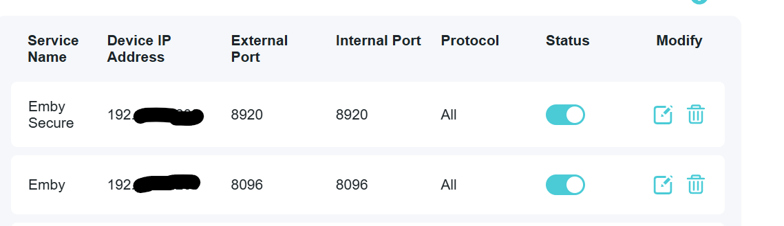

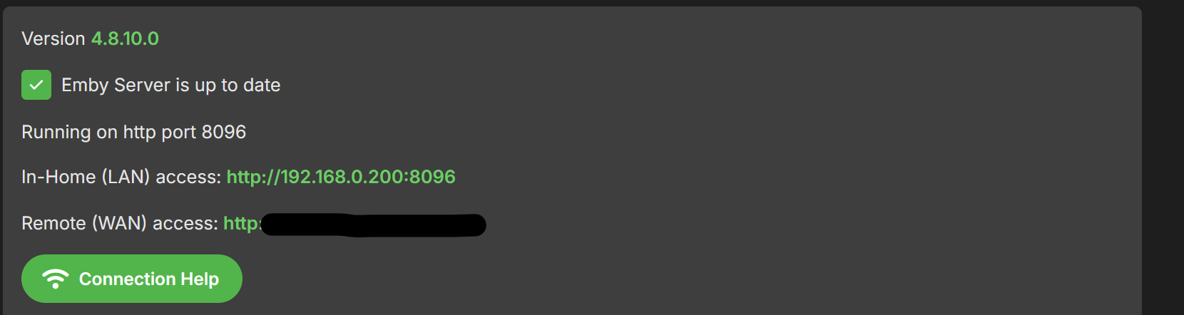

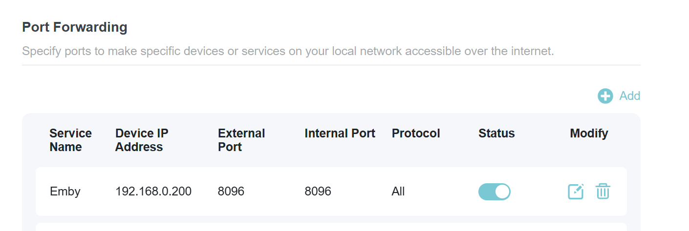

rochambeaux 2 Posted January 3, 2025 Posted January 3, 2025 Running Windows Premiere Server. Served configuration looks good: Port forwarding set in router: On Android client Sign in with Emby Connect takes email and password but goes back to Select Server screen. When try to manually connect using above information get Unable to Reach Server. What's the secret combination to get this to work? Plex has a similar setup and just works, flawlessly, every time.

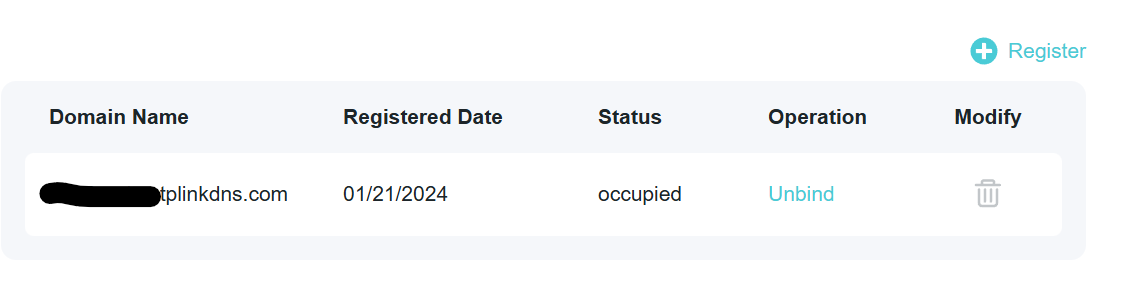

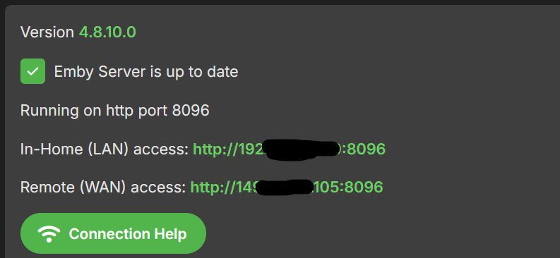

rochambeaux 2 Posted January 13, 2025 Author Posted January 13, 2025 Couple of things. In the Connectivity link you point to canyouseeme.org, which is a huge clickbait trap and does not allow you to enter the IP to be tested. This is the only way I could get it to work. I cannot get to Emby using the external IP address. Everything is setup correctly: Blacked out Ip and ports all match. However, if I use the the Dynamic Host Name on my router instead of the external IP, it resolves and I can enter credentials and connect. For whatever reason, Emby connect will not accept the same "bare" IP address that the hosted name below points to.
