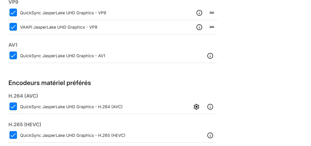

richt 95 Posted December 11, 2024 Author Posted December 11, 2024 (edited) @LukeYes, I am still having the problem. I've looked and the HARDWARE encoders are still set at defaults. See the screen capture below. The SOFTWARE encoder is set as you noted, however my guess is that these parameters are not called until after the hardware decoder has failed. I will however reset the software encoder to defaults and retest. Since reporting the error I have done a little testing directly from the TOS6 command shell. In the shell, I can get VAAPI encoding to work, but so far not QSV. Looks like Emby is using QSV, is there any way to change it to VAAPI? <edit> After resetting all software and hardware encoders, to default, hardware encoding still fails. Attached log. ffmpeg-transcode-1bcba9b0-6c3a-42bc-a6c5-98aa298ad793_1.txt Edited December 11, 2024 by richt

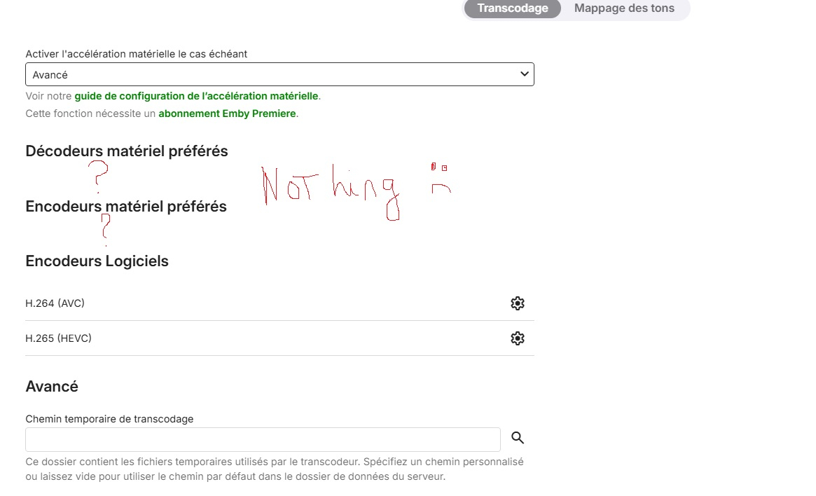

Sydo36 2 Posted August 25, 2025 Posted August 25, 2025 Hello. (Sorry for my english) Exactly the same for me. With TOS 5 : Perfect works with software decoding but since i have migrated for TOS 6 and, the hardware decoding isn't available in the transcoding menu. Of course, i owned Emby premiere I will try the version for testing and i am waiting a new version. Thanks You!

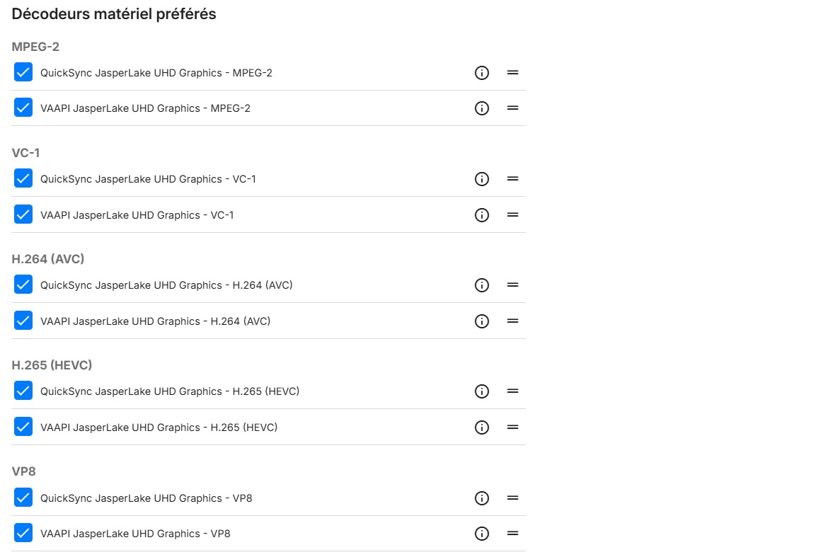

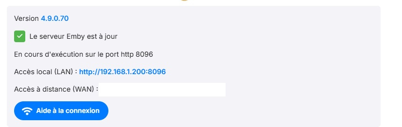

Sydo36 2 Posted August 27, 2025 Posted August 27, 2025 (edited) I tried the Last for TOS 5 : The 4.9.1.22. And Now I have installed the Beta Version for Tos 6. It's Work. I have the parameters for Hardware Decode & Recoding Do you know, how this bug will be solved with a new emby version? Thanks you Edited August 27, 2025 by Sydo36 add pics

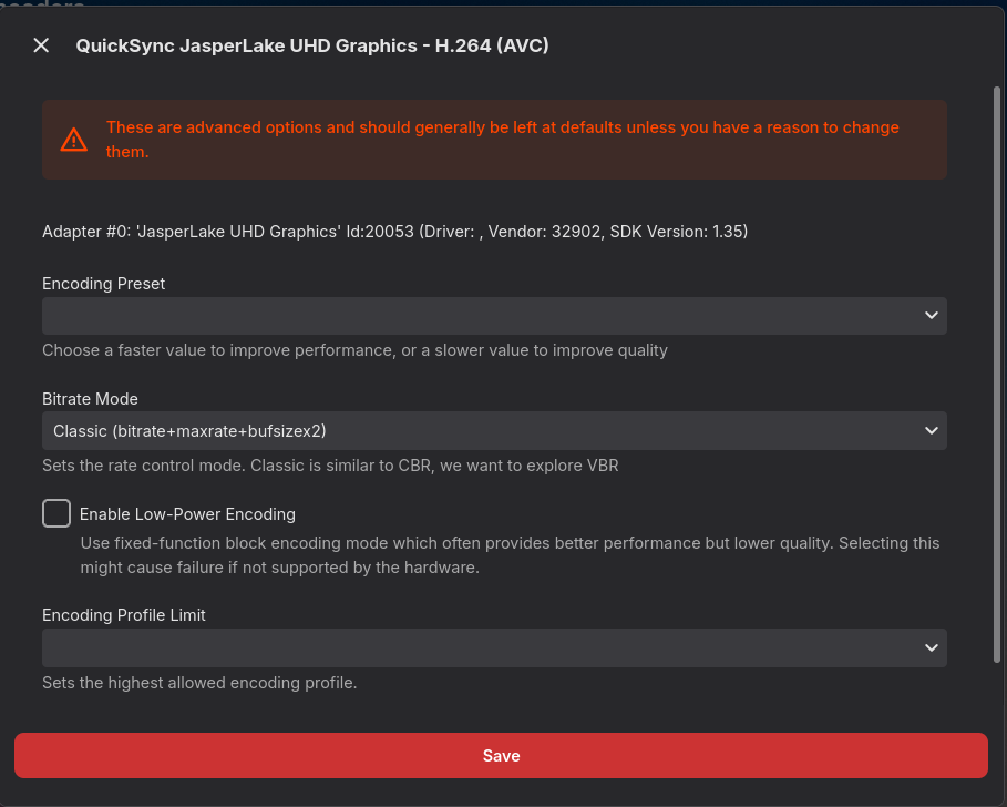

Luke 42234 Posted October 8, 2025 Posted October 8, 2025 Hi, I would try resetting your customizations: Warning EncoderParametersH264Qsv.BitrateMode: Original: Classic Actual: Vbr
