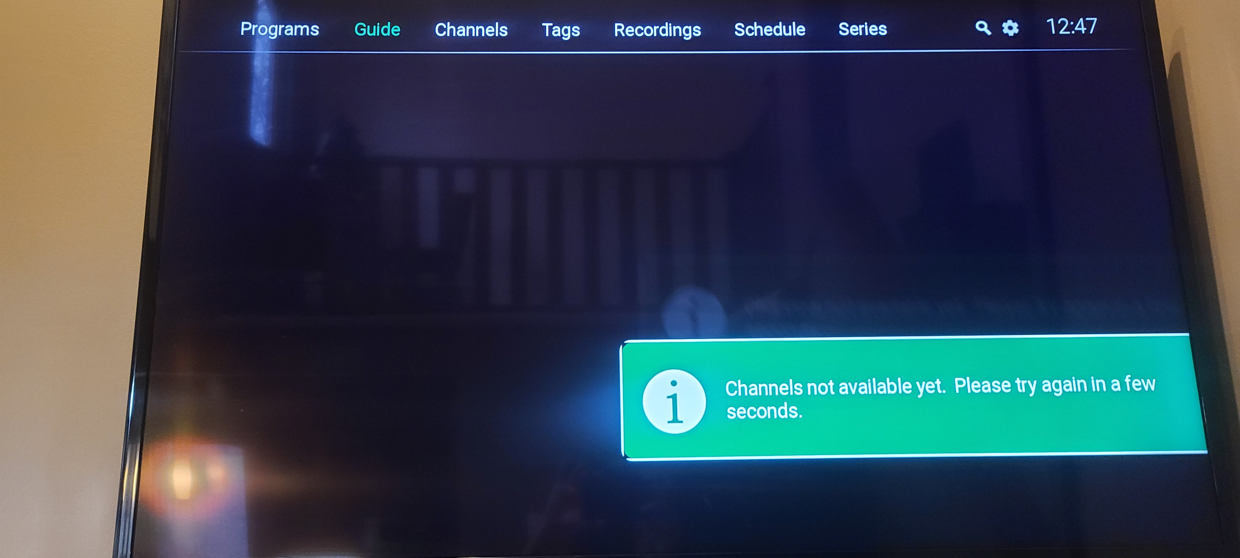

kmartinka 3 Posted November 28, 2024 Author Posted November 28, 2024 (edited) Hello, thanks for responding so soon. Especially if you are celebrating the US holiday today. I had the topic incorrectly quoted. It should have said "Channels not available yet". Sorry for not being clear with my issue. Attached is a picture that should show the state of the problem. This keeps revolving and never produces the guide. This happens on both my Rokus. Edited November 28, 2024 by kmartinka

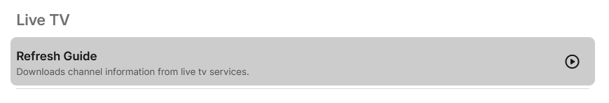

speechles 2062 Posted November 28, 2024 Posted November 28, 2024 (edited) I believe you need to be more patient and make sure the guide task has completed and ran at least once. Quote 2024-11-28 07:07:28.650 Info Server: http/1.1 Response 500 to host4. Time: 264ms. GET http://192.168.1.184:8096/emby/LiveTv/Channels?userId=415f3717572e463db743b78255fc1726&SortBy=Number&sortOrder=Ascending&tagIds=&Limit=1500 2024-11-28 07:07:30.719 Info Server: http/1.1 Response 404 to host4. Time: 0ms. GET http://192.168.1.184:8096/emby/Items//Images/Backdrop/0?EnableImageEnhancers=true&maxwidth=1280&maxHeight=1080&quality=90 2024-11-28 07:07:31.451 Info Server: http/1.1 Response 404 to host4. Time: 0ms. GET http://192.168.1.184:8096/emby/Items//Images/Backdrop/0?EnableImageEnhancers=true&maxwidth=1280&maxHeight=1080&quality=90 Response 500 Response 404 Response 404 Those are the 3 http conditions for the request to obtain guide data. The first is the 500 error which means the server cannot complete the request. The next two are 404 because the server already told it was 500. Now it is telling the resource has moved to stop making the request it cannot complete. Have you run this task? Has it completed? ---- You need to sometimes wait to go to the LiveTV guide on the Roku until the app has fully loaded the homescreen. If you attempt to go there before the homescreen has fully rendered you might experience this issue. Edited November 28, 2024 by speechles

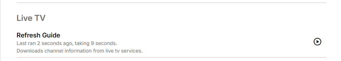

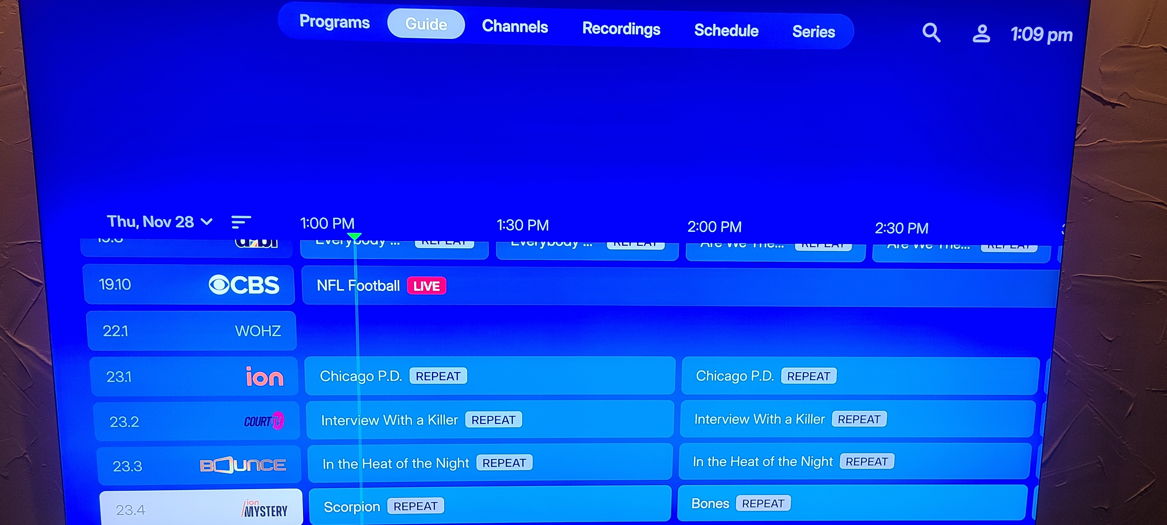

kmartinka 3 Posted November 28, 2024 Author Posted November 28, 2024 (edited) Thanks for the reply. The Live TV guide is in Scheduled Tasks and runs successfully on its scheduled time. I manually ran the task as well without error. I can say that my Windows 10 HTPC Emby client has no issue as seen in the attached image. I understand the code for handling the calls in Windows maybe different than the Roku Emby client. It's been about 30 minutes on Roku Emby client and still the same issue is occurring. Edited November 28, 2024 by kmartinka

ebr 16332 Posted November 28, 2024 Posted November 28, 2024 And that is the entirety of the channels you have defined in Emby? That is not enough to cause a time out. Please follow the instructions to send a log from the app. Once you've turned on the option and confirmed the send logs button is available, re-start the app, wait 30 seconds and then try and enter the guide. Once you get that message, send the log and then come here and tell me what time you did that. Thanks.
kmartinka 3 Posted November 28, 2024 Author Posted November 28, 2024 That is the entirety. I followed the instructions to send the debug log (please ignore the first sent). I sent the log at 3:20 EST and user account is "TV"
ebr 16332 Posted November 28, 2024 Posted November 28, 2024 Okay, the query isn't timing out it is failing due to what looks like database corruption. Did you install a beta and then go back to the release?
