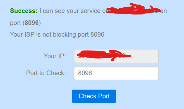

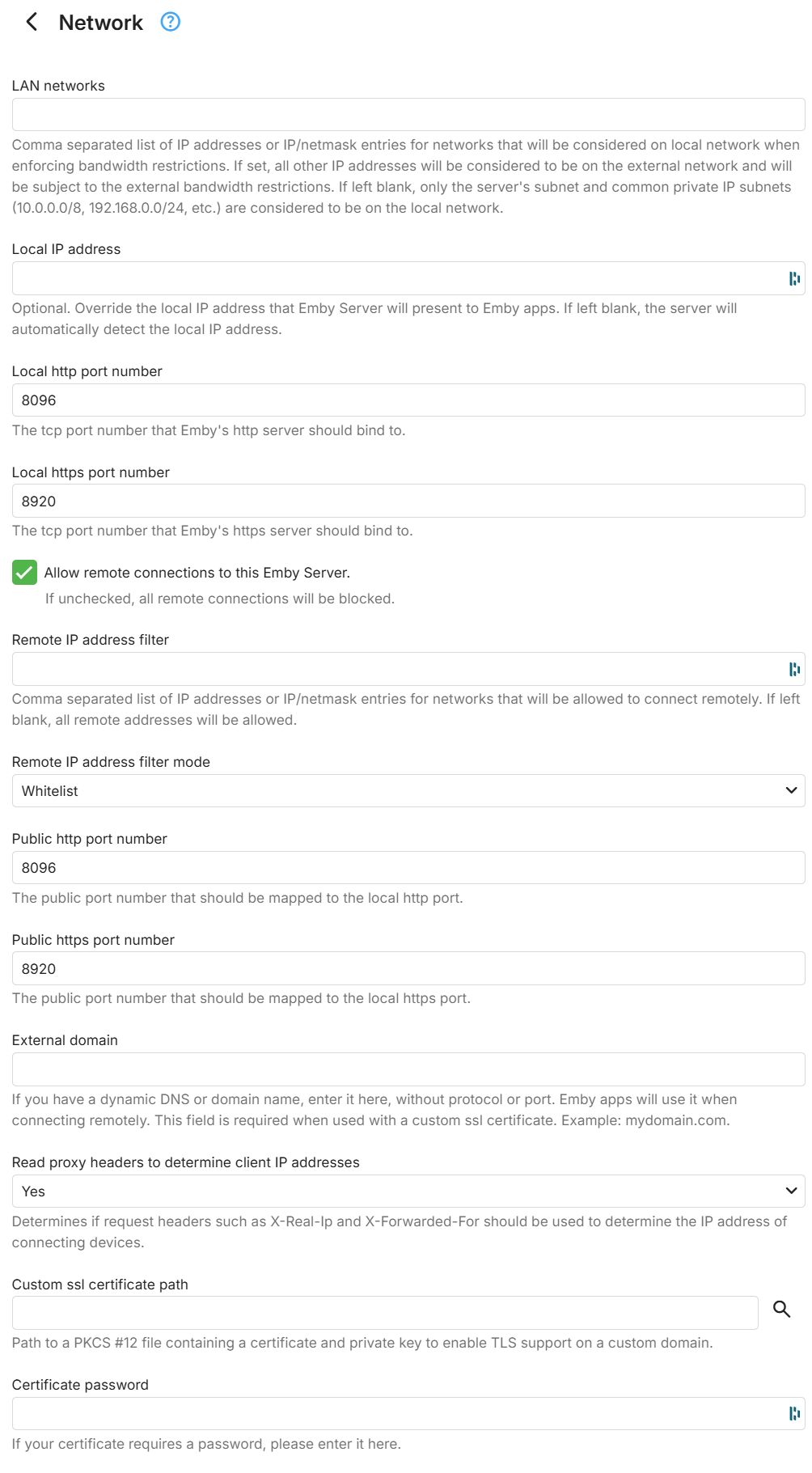

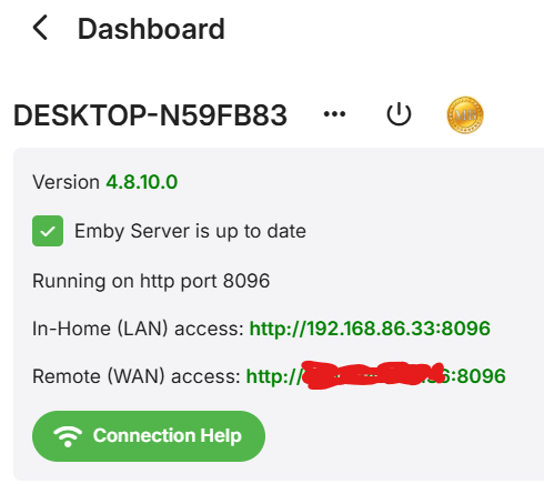

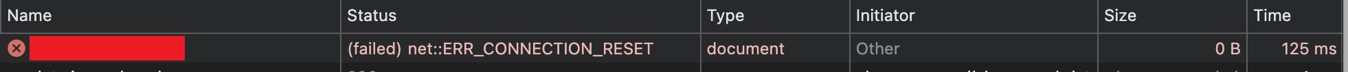

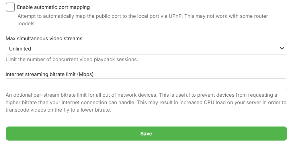

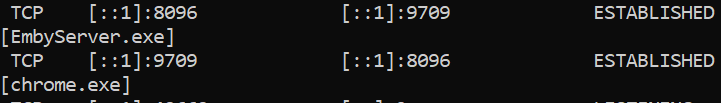

robertcrossuk 0 Posted November 16, 2024 Posted November 16, 2024 Hello, my Emby remote isn't working. I've followed the Connectivity troubleshooting (https://emby.media/support/articles/Connectivity.html) but still can't connect. See below for status. Red masks are my emby server/home static IP from my ISP and green is the network I'm using to connect to. canyouseeme.org with my static IP: I try to connect using chrome on another network: I enabled windows firewall logging and I can see in my windows firewall log on my Emby server that the connection is being allowed by Windows: My emby dashboard: My emby network settings page: My User settings page: My netstat -a -b -n outputs are below: The emby log files don't show any activity, even in debug mode, when connecting from the remote network. Thanks, Rob

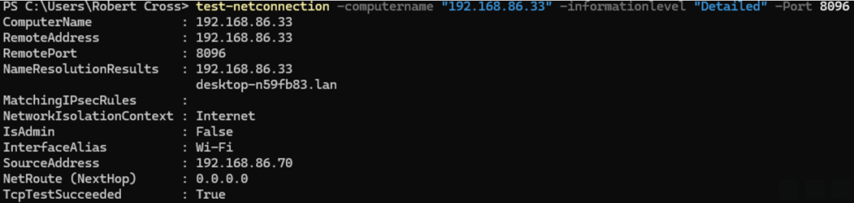

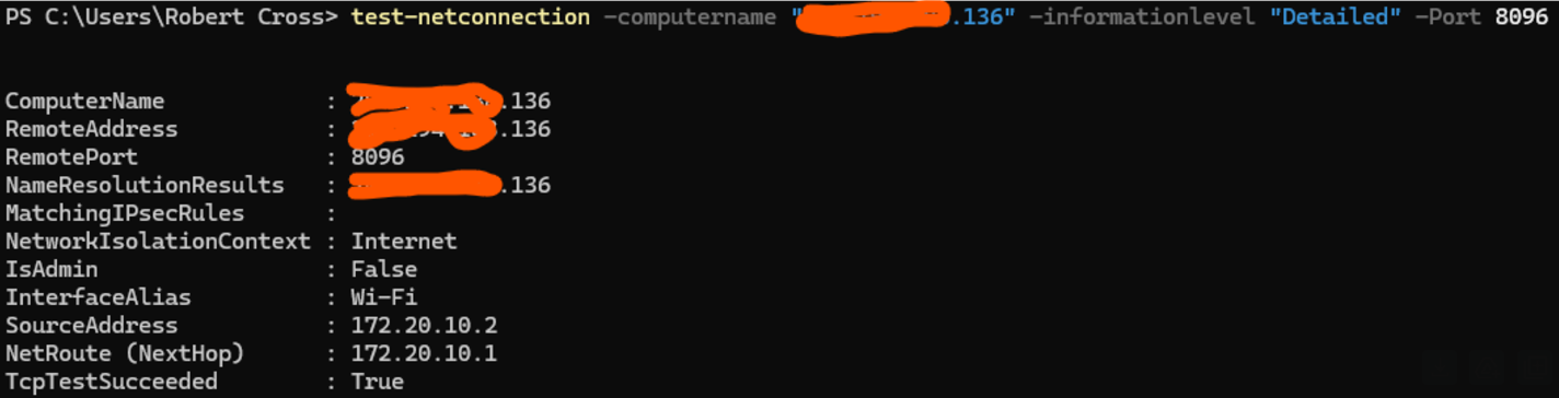

rbjtech 5335 Posted November 19, 2024 Posted November 19, 2024 Thanks for covering all the network basic checks - everything appears as it should. Can you do a powershell command :- from same LAN or routed local network :- test-netconnection -computername "192.168.86.33" -informationlevel "Detailed" -Port 8096 from WAN/remote :- test-netconnection -computername "WAN IP or DNS/FQDN" -informationlevel "Detailed" -Port 8096 1
robertcrossuk 0 Posted November 30, 2024 Author Posted November 30, 2024 (edited) Hello, sorry for the slow reply, details below: Local Network: Remote Network (tethered from my cell): Thanks, Rob Edited November 30, 2024 by robertcrossuk Images didn't attach
rbjtech 5335 Posted November 30, 2024 Posted November 30, 2024 (edited) 7 hours ago, robertcrossuk said: Hello, sorry for the slow reply, details below: Local Network: Remote Network (tethered from my cell): Thanks, Rob The 172.20.x.y is RFC1918 private address space that is not your LAN (192.168.86.x) - suggesting you have 'something else' inbetween your PC and the WAN destination. Could be a dmz, could be a reverse proxy, could be CGNAT, could be a FW, could be a WAF... - but the odd thing is the TCP packet request is getting a valid response. If you are aware of what the 172.20.10.2 is - then for the moment, you need to remove it for testing. If emby then works - then you know that is causing the issues. The SourceAddress can of course be whatever you like (if you used a VPN for example, that would be source) but something 'in the routing/config' here is causing you 'reset' issues - I do not believe this is being caused by Emby itself as a LAN probe works. Edited November 30, 2024 by rbjtech 2
