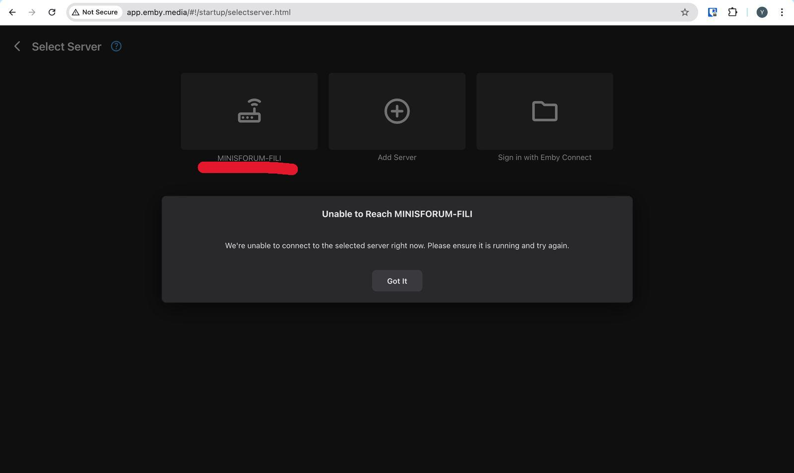

TheMovieJerk 0 Posted October 28, 2024 Posted October 28, 2024 Hi everyone, I'm sharing my Emby server with my dad, and I'm trying to find a way to make accessing the server easier for him. Currently, as you might expect, he needs a new URL every time my IP address changes. I'm thinking a domain name might be the solution. If so, could someone point me to a simple guide on how to set this up? I'm not very tech-savvy, so a step-by-step explanation would be greatly appreciated. I apologize if this question has been asked before. If so, please feel free to share a link to the relevant thread and close this one. Thanks a lot!

GrimReaper 4927 Posted October 28, 2024 Posted October 28, 2024 11 minutes ago, TheMovieJerk said: I'm sharing my Emby server with my dad, and I'm trying to find a way to make accessing the server easier for him. Currently, as you might expect, he needs a new URL every time my IP address changes. Hi there, you could use Emby Connect, which would enable your dad to connect to your server without knowing/entering IP address (nor care if/when it changes). Emby Connect
TheMovieJerk 0 Posted October 28, 2024 Author Posted October 28, 2024 22 minutes ago, GrimReaper said: Hi there, you could use Emby Connect, which would enable your dad to connect to your server without knowing/entering IP address (nor care if/when it changes). Emby Connect Thanks for your quick response, Grim. I tried following the guide step-by-step many times, but I'm still getting this error message when I try to access the server.
GrimReaper 4927 Posted October 28, 2024 Posted October 28, 2024 Your browser is likely force redirecting you to https://app.emby.media - if you don't have SSL setup on your server, make sure the address in the address bar is http://app.emby.media. 1
Luke 42290 Posted October 29, 2024 Posted October 29, 2024 2 hours ago, TheMovieJerk said: Thanks for your quick response, Grim. I tried following the guide step-by-step many times, but I'm still getting this error message when I try to access the server. Hi @TheMovieJerkdid you try any of the suggestions that are shown in your screenshot?
TheMovieJerk 0 Posted October 29, 2024 Author Posted October 29, 2024 9 hours ago, GrimReaper said: Your browser is likely force redirecting you to https://app.emby.media - if you don't have SSL setup on your server, make sure the address in the address bar is http://app.emby.media. Thank you so much, Grim! It works perfectly. As you mentioned, Chrome was indeed force-redirecting to HTTPS. Is it normal for smartphones to automatically redirect to HTTPS, even when manually changed to HTTP? Additional Questions: Is using the HTTP version secure, or does it pose a risk? Does Emby Connect have the same 25-device limit as Premiere? If it works, I'd like to share it with my family and friends, you know. How can I set up SSL on my router? Is there a simple step-by-step guide available? Thanksss a lot, guys!

TheMovieJerk 0 Posted November 22, 2024 Author Posted November 22, 2024 Hi, everyone! My dad successfully connected using Emby Connect (via HTTP) until my IP changed again. I don’t understand what the problem is. Can somebody me?
Luke 42290 Posted November 22, 2024 Posted November 22, 2024 42 minutes ago, TheMovieJerk said: Hi, everyone! My dad successfully connected using Emby Connect (via HTTP) until my IP changed again. I don’t understand what the problem is. Can somebody me? Hi, does your server dashboard display your new remote address?
TheMovieJerk 0 Posted November 22, 2024 Author Posted November 22, 2024 (edited) 8 minutes ago, Luke said: Hi, does your server dashboard display your new remote address? Hi, Luke. Yes, of course. And strangely enough, or maybe not, the remote address he gets there (the one I've just crossed out on the image) does not correspond to the actual one Edited November 22, 2024 by TheMovieJerk
TheMovieJerk 0 Posted November 22, 2024 Author Posted November 22, 2024 8 minutes ago, Luke said: Is it the old address? I honestly do not remember the old one, but this one is the same as the new one except for the last 3 digits
TheMovieJerk 0 Posted November 23, 2024 Author Posted November 23, 2024 (edited) 12 hours ago, Luke said: Is it the old address? Yeah, upon further inspection, I found out it is indeed the old one. I helped him in manually entering my new IP address under the 'Add Server' option, which solved the issue for now. But the main advantage of using Emby Connect is lost if I still need to rely on my IP address. Edited November 23, 2024 by TheMovieJerk
