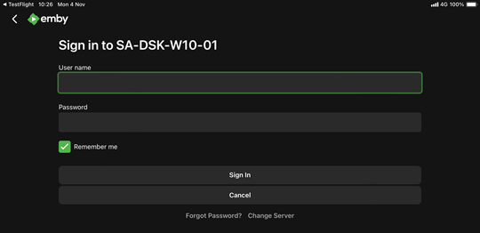

sa2000 697 Posted November 4, 2024 Posted November 4, 2024 Some late feedback. I was planning to try out the hostname / port method on the Emby for iOS 2.2.31 (1) Testflight beta. Well - i have done it now and it worked ok for me Tried it with WAN - disabling wifi and using the 4G/5G connection I have. Then signed out on the app and selected Change Server and then Add Server Then I entered my mywire.org free host name and my wan port for one of the servers This reached the server OK with the sign-in challenge and I logged in successfully using hostname / port 1
