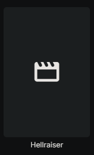

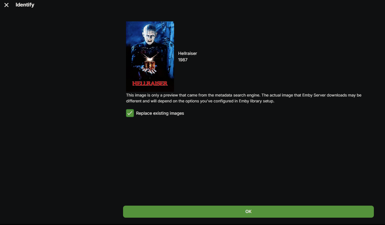

gruppa 3 Posted October 1, 2024 Posted October 1, 2024 (edited) Somehow the metadata got messed up for Hellraiser (1987) and now identify won't update it. Identify finds it but clicking OK at the bottom doesn't do anything. The spinny circle comes up for a second then goes away but it doesn't update anything. I've tried restarting Emby, re-naming the media file, removing identification and scanning the library again but nothing works. It plays fine though. Any advice would be much appreciated. Edited October 1, 2024 by gruppa words
Luke 42184 Posted October 1, 2024 Posted October 1, 2024 Hi, it kicks off a metadata refresh when you click OK. I would just be patient and allow that to finish. Please let us know if this helps. Thanks.
gruppa 3 Posted October 1, 2024 Author Posted October 1, 2024 2 minutes ago, Luke said: Hi, it kicks off a metadata refresh when you click OK. I would just be patient and allow that to finish. Please let us know if this helps. Thanks. I've had it happen when the progress circle comes up and it can take a few minutes to update but it's not doing that at all. The updating progress circle comes up then immediately vanishes, the OK bar at the bottom lights back up and it sits on the identify window like it's waiting for OK to be clicked again. I've left it there for an hour and nothing happens.
