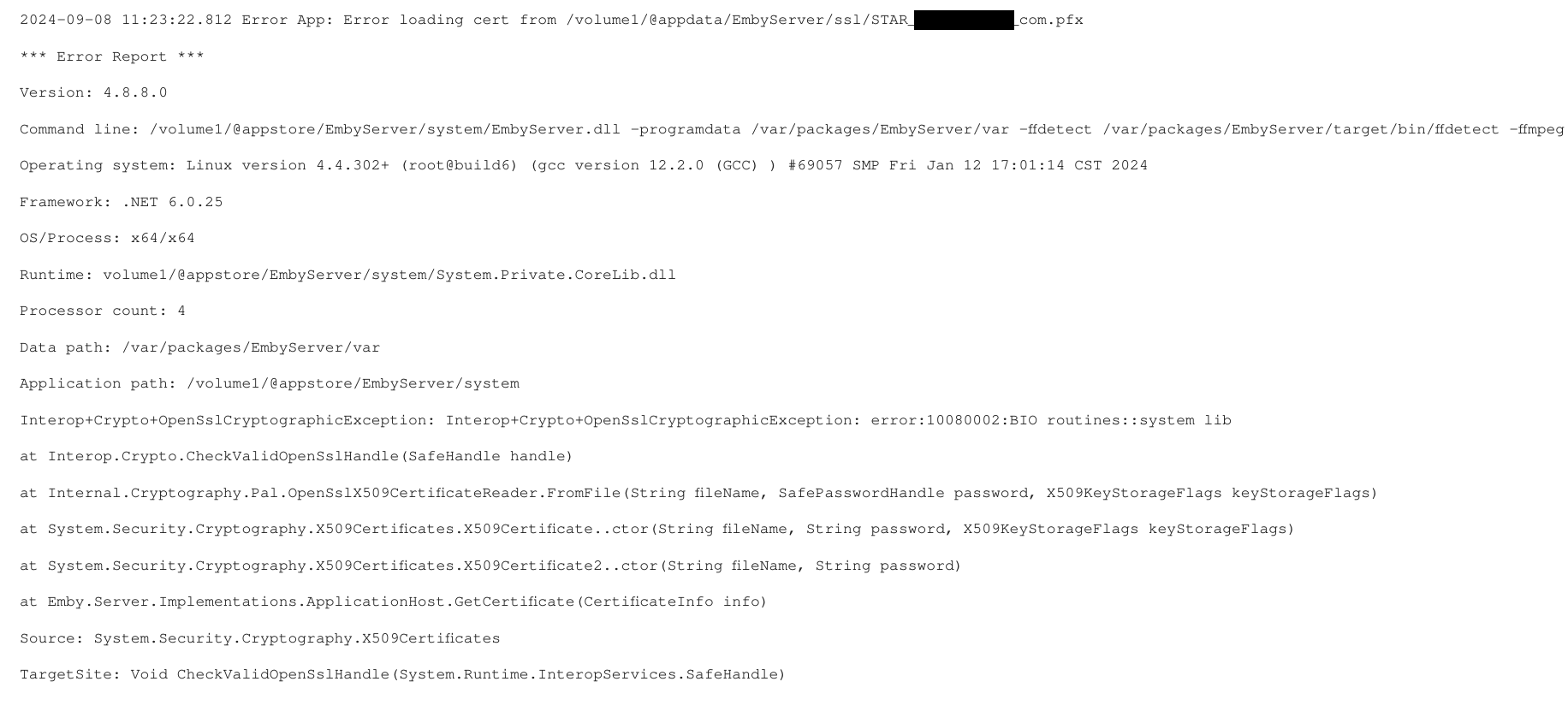

tcush89 0 Posted September 8, 2024 Posted September 8, 2024 Hi all, I'm trying to force Emby to https on my Synology NAS. I've tried following the steps at https://emby.media/support/articles/Secure-Your-Server.html but am still having issues. When I try to connect via https:// at the default port (8920), I get an "ERR_CONNECTION_CLOSED". I did check my log that I attached in the screenshot, and it looks like there was an error loading the certificate. Originally I thought there may be a permissions issue, so I moved the file to the directory listed in the screenshot and ensured "emby:emby" were the user owner and group owner, but it's still having trouble loading the cert. I did verify that the certificate password is correct. Any ideas? Thanks!
Solution tcush89 0 Posted September 8, 2024 Author Solution Posted September 8, 2024 Okay, I fixed it. Two things: I found this post that also seemed to suggest a permissions error. I think the permissions on the cert were okay (644), but just to be sure, I did what that post suggested: sudo chmod 644 /volume1/@appdata/EmbyServer/ssl/STAR_XXXXXXXXXX_com.pfx Even though I double checked the PFX certificate password and regenerated the cert a second time, I decided to triple check and regenerate the cert a third time. After redoing the cert and chmod 644, HTTPS works like a charm.
