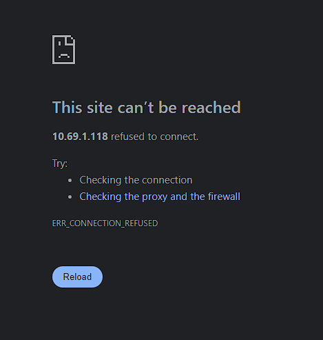

Pobinski 2 Posted September 4, 2024 Author Posted September 4, 2024 OK So Still Struggling. When i open Emby on the Qnap it tries to open up the NAS IP :8096 etc then i get the site that cannot be reached. so its trying to get there Could this now be either Firewall issue ? or beacuse i have uninstalled and reinstalled this App several times... the first time i ran this i got the landing page a few days ago to set the server up now i cannot get it to come back... Now i have a static IP. i have already Forwarded the Ports 8096 & 8920 in my UDMPRO i have made sure my NAS in my internal network also has a static ip, i tried turning off the firewall in the Qnap and forwarding the ports also in there to see if that was stopping the access but still no go...
Luke 42239 Posted September 4, 2024 Posted September 4, 2024 4 hours ago, Pobinski said: OK So Still Struggling. When i open Emby on the Qnap it tries to open up the NAS IP :8096 etc then i get the site that cannot be reached. so its trying to get there Could this now be either Firewall issue ? or beacuse i have uninstalled and reinstalled this App several times... the first time i ran this i got the landing page a few days ago to set the server up now i cannot get it to come back... Now i have a static IP. i have already Forwarded the Ports 8096 & 8920 in my UDMPRO i have made sure my NAS in my internal network also has a static ip, i tried turning off the firewall in the Qnap and forwarding the ports also in there to see if that was stopping the access but still no go... hi, what address is in the browser address bar?
Pobinski 2 Posted September 4, 2024 Author Posted September 4, 2024 Its goes to my server ip with the port 8096 http://10.69.1.118:8096/ Cheers
Pobinski 2 Posted September 4, 2024 Author Posted September 4, 2024 Sorry it was 8920 https://10.69.1.118:8920/
Luke 42239 Posted September 4, 2024 Posted September 4, 2024 7 hours ago, Pobinski said: Did you setup https in emby server network settings? if you haven't done that, then you will need to use the http port, so http://ip:8096 Please let us know if this helps. Thanks.
Pobinski 2 Posted September 5, 2024 Author Posted September 5, 2024 Strange Its letting me do this now and i can see the server again... So We are half way there now. Locally i can connect to the server, PC, Phone TV etc Everything is working great Getting the Remote is the next Step. There will only ever be 2 Other users and Myself remotely the rest will be Local. Port Forwarding this is what has got me. Its my own fault for buying enterprise network stuff for the house, massive overkill but Nice to have i just wish i had the knowledge more to utilise it all. So i now need to set up a Port Forward on the UDMPRO to go from my Static IP to the Local NAS ip is that correct ? on port 8096 ? Thanks
