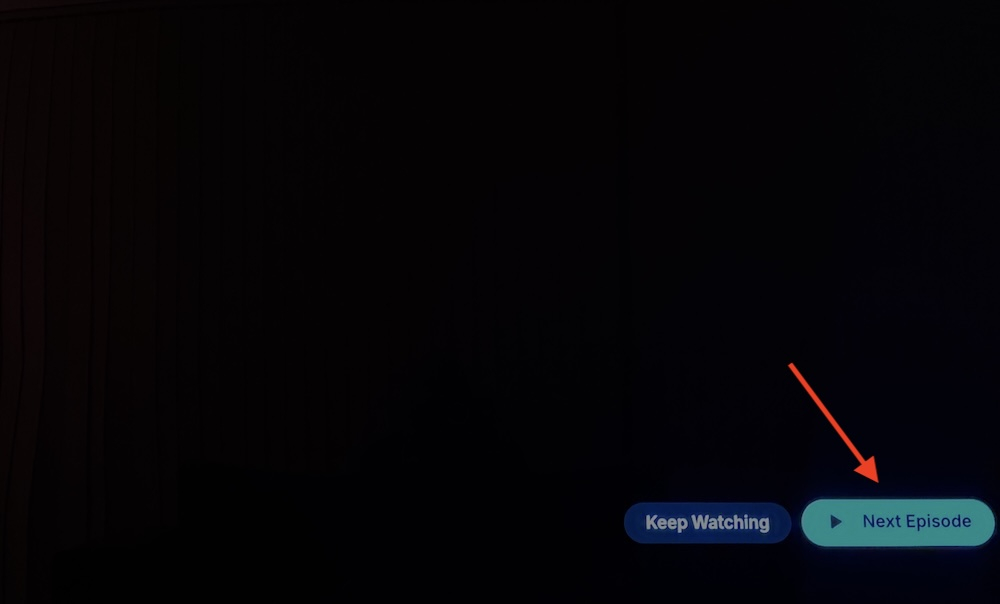

Blueskies278 43 Posted September 13, 2025 Posted September 13, 2025 (edited) Here is my latest log Emby 3.5.02. Blank screen, I have to click Next Episode to play the next episode. * 01:46 * Blueskies * Log emby_android_1757724101976.txt Thanks Edited September 13, 2025 by Blueskies278 1

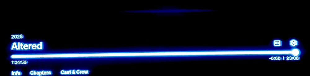

Blueskies278 43 Posted January 7 Posted January 7 (edited) 46 minutes ago, Luke said: Can you provide a log from the app with 3.5.23? Thanks. Thanks Android 3.5.23 7/1/2026, 6:04 File: Altered Bluskies278 Log emby_android_1767765702409.txt Edited January 7 by Blueskies278 1
Neminem 1629 Posted January 7 Posted January 7 Hmm what up with that time played on the left side? The right side shows total run time. Just curious
Blue278 22 Posted January 7 Posted January 7 4 hours ago, Neminem said: Hmm what up with that time played on the left side? The right side shows total run time. Just curious Right: time renaming / local time movie will end. Left: Movie running time. 1

Blueskies278 43 Posted January 20 Posted January 20 (edited) 24 minutes ago, Luke said: What exactly happened? Two issues *When the file stops playing, it doesn’t return to the default screen. *Auto Next episode doesn’t work when enabled. it just stops. I have to click on "Next Episode" to play next episode. Edited January 20 by Blueskies278

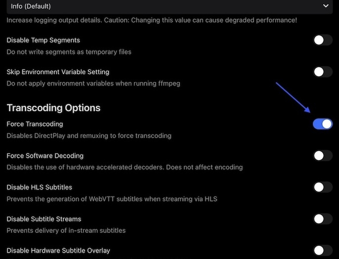

Blueskies278 43 Posted January 22 Posted January 22 (edited) On 20/01/2026 at 03:11, Luke said: I'm sure it can but it's definitely not something that is impacting every single mkv. For example try another one, or try with an mp4 and see how things go. UPDATE: Installed Diagnostics Plugin, enabled "Force Transcoding" * When the file stops playing, it now returns to the default screen. * Auto Next Episode working normally I hope this gives you valuable information. If you need a diagnostic log, please let me know. Thanks Edited January 22 by Blueskies278
