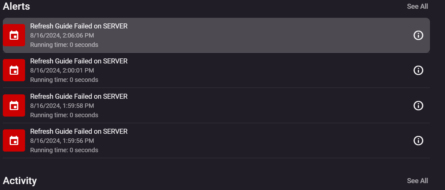

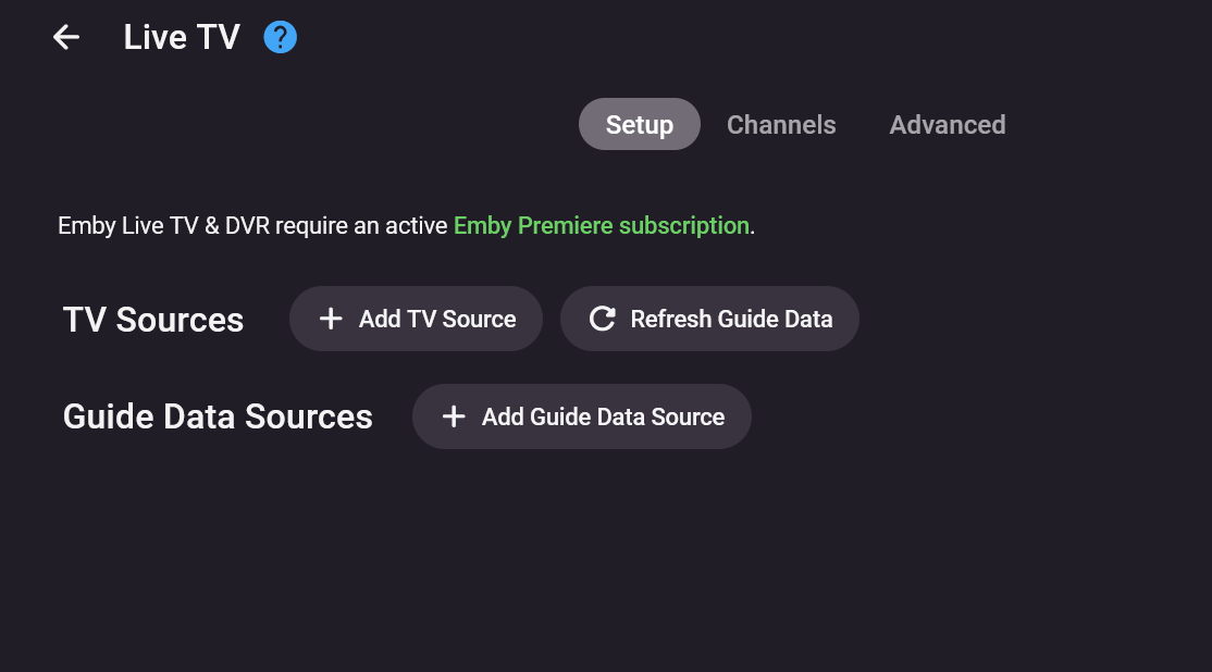

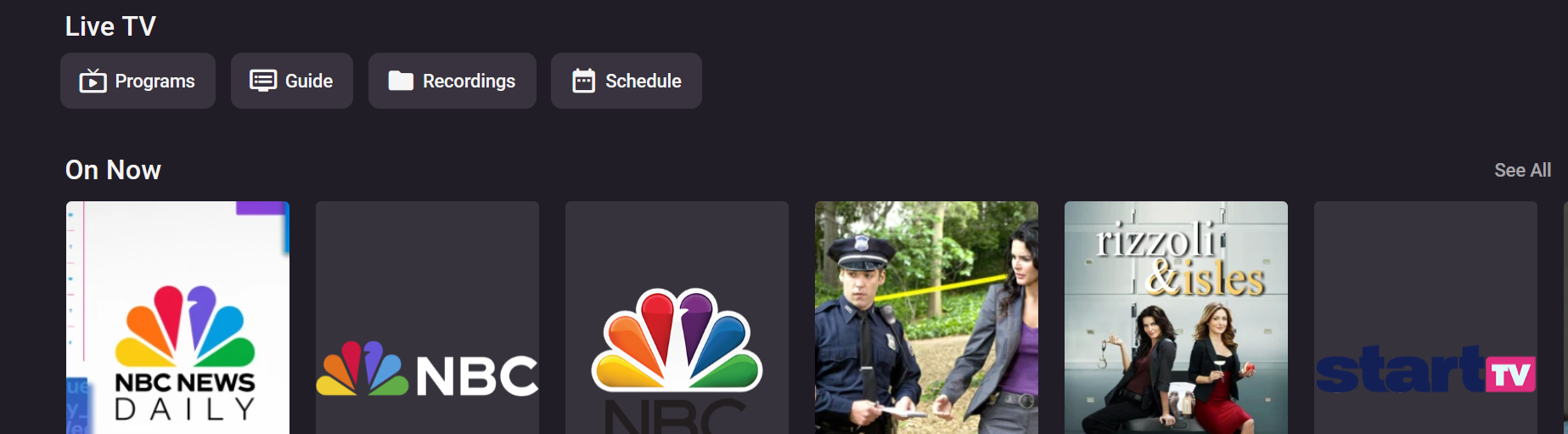

js28194 42 Posted August 16, 2024 Posted August 16, 2024 (edited) Hello all, I am in the process of redoing some things in my enviroment and I was wondering how to completely remove LiveTV? I have delete all the tuners and restarted Emby, but it still show's the guide with Triple Channels (now). There is this old thread from 2015, but I tried this all with no luck. Restarting the Emby Server is no help either, albeit nothing plays as expected. https://emby.media/community/index.php?/topic/27932-is-there-a-way-to-reset-the-tv-guide/ Edited August 16, 2024 by js28194 Adding

js28194 42 Posted August 16, 2024 Author Posted August 16, 2024 (edited) Attached. embyserver.txt That is the last one I had. I had cleaned up the directories in preparation for a backup before changing things around. Clean Directories, backup, remove Live TV, restart Emby SErver, LIve TV still shows up. I see some database is corrupt errors in there but not sure what to make of it as I was trying to remove LiveTV all together. Edited August 16, 2024 by js28194
Solution Luke 42241 Posted August 24, 2024 Solution Posted August 24, 2024 On 8/16/2024 at 3:33 PM, js28194 said: Attached. embyserver.txt 559.25 kB · 0 downloads That is the last one I had. I had cleaned up the directories in preparation for a backup before changing things around. Clean Directories, backup, remove Live TV, restart Emby SErver, LIve TV still shows up. I see some database is corrupt errors in there but not sure what to make of it as I was trying to remove LiveTV all together. @js28194this is your issue: https://emby.media/support/articles/Corrupt-Database.html Please let us know if that helps get you squared away. Thanks.
js28194 42 Posted August 25, 2024 Author Posted August 25, 2024 (edited) Thanks, I was able to restore from a backup and am back to square one with a clean install with my Library in tact. Will revist on how to remove LiveTV in the next couple of weeks. My objective is to move purely to NextPVR. Right now, I have a combination of both. Emby uses the HDHR-4K that transcodes for Emby Apps on my phone in a remote seeting, but all my kodi devices on local LAN use NextPVR with HDHomerun OTA devices (very old ones) if ain't broke don't fix it, plus it seems 4k OTA channels are all going DRM anyway. This works and it works very well, but the Objective is to integrate Emby into NextPVR (paid for already) and have one less link in the chain. Edited August 25, 2024 by js28194 1
