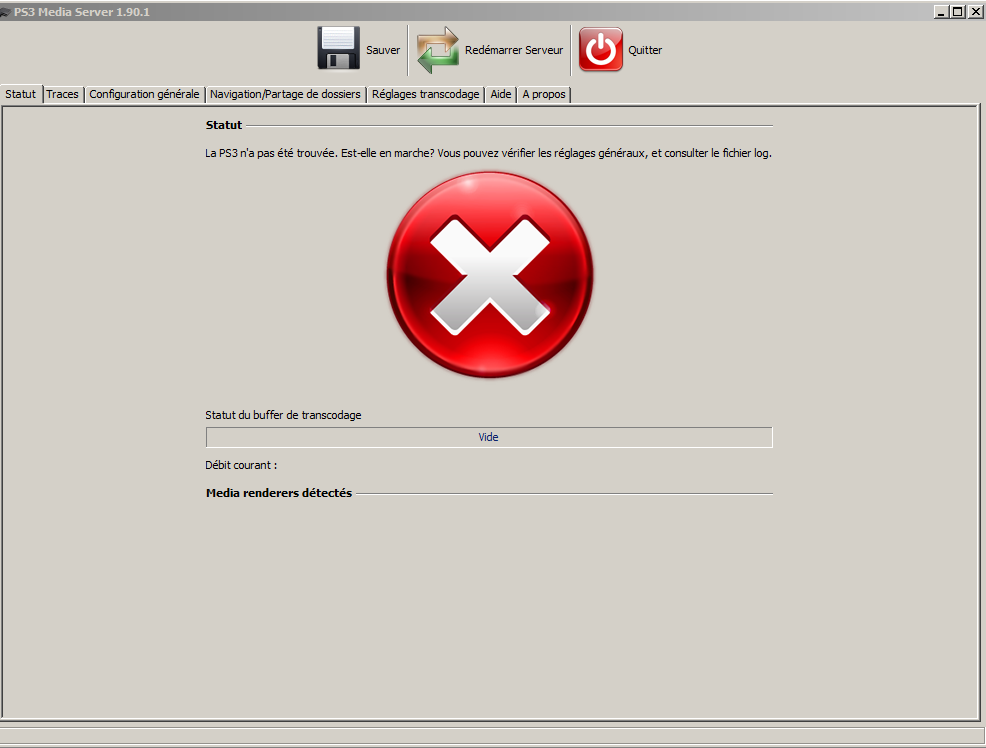

TheTenth 1 Posted August 10, 2024 Posted August 10, 2024 I use PS3 media server and Windows media server, they appear on my Smart TV Samsung and I click and navigate the folders to access my video or music files Now after Fiber has been installed, they don't appear at all (usually they were after Remote access. PS3 media server will not work (usually at the bottom, I'd see the SAMSUNG TV nad WIndows media server. In the SFR BOx settings there's a setting for Media server, but it's to use the Box itself as server but I have to plug a USB cable from the box to the PC Anyone could point me to find a solution?

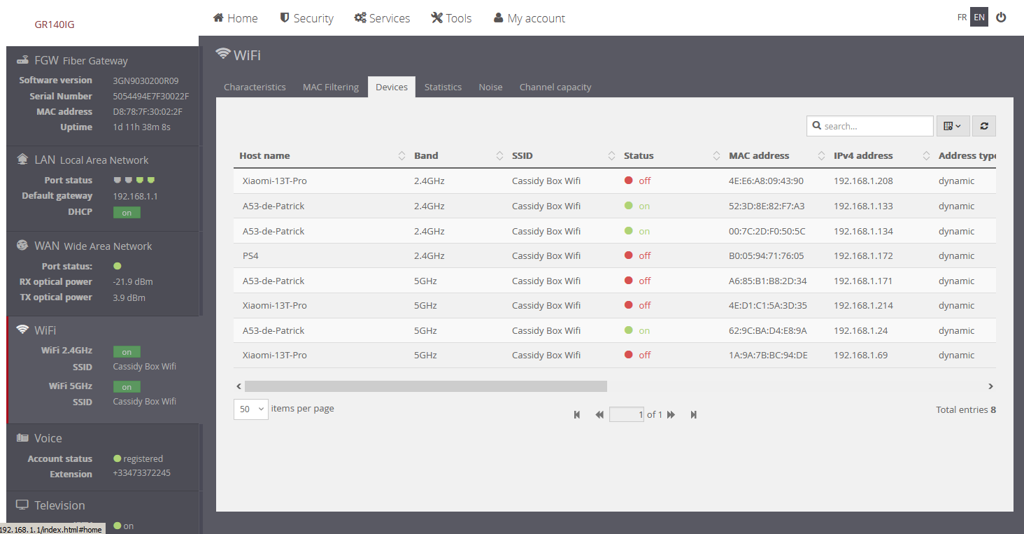

TheTenth 1 Posted August 11, 2024 Author Posted August 11, 2024 (edited) not sure what technical elements you need I have a 15 year AMP Sempron with Windows 7. My Box is a SFR box 8 GR14OIG (Vodafone), my PC and TV have a cable link, it's a SAMSUNG ue55ru7475uxxc. I have IPv4 and IPv6 on, UPnP v4 and v6 on, MAC filtering offI add a picture of my Wifi settings that do not show TIZEN (= SAMSUNG) or Xiaomi 13t pro (sometimes it doesn't appear at all)or sometimes in 5 ghz) that are on Wifi with the box I don't understand how Emby works, ca't find a way to choose files to share ... I have tried SimpleDLNA, Serviio and others and though they identify the TV, the TV receives nothing. I add a pciture of the Wifi settings where TIZEN doesn't appear Edited August 11, 2024 by TheTenth

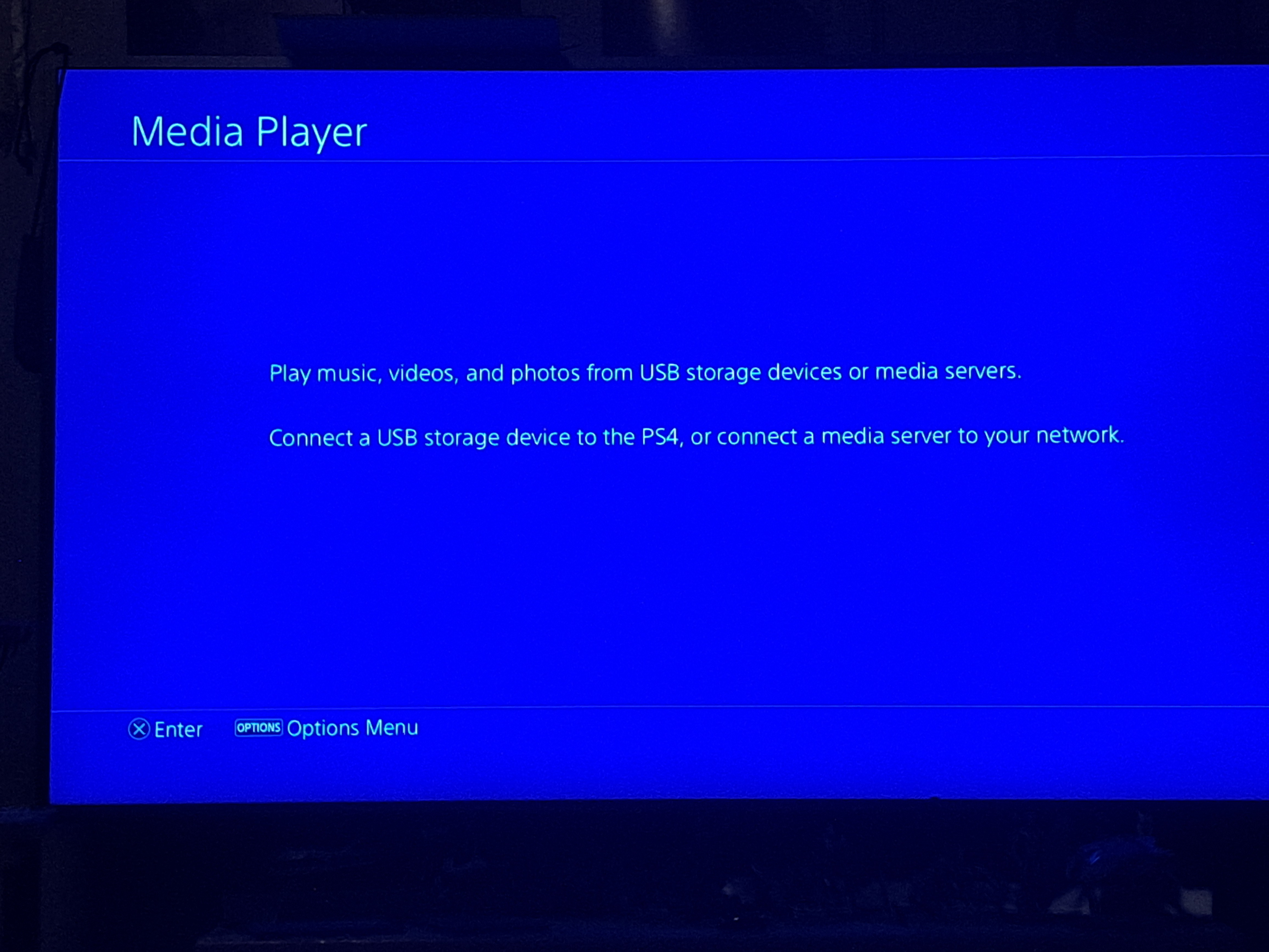

Luke 42233 Posted August 11, 2024 Posted August 11, 2024 4 hours ago, TheTenth said: I found how to add videos to Emby, but the server doesn't appear on the TV or PS4 Hi there, how exactly are you looking for the server on the PS4? What TV?
TheTenth 1 Posted August 11, 2024 Author Posted August 11, 2024 57 minutes ago, Luke said: Hi there, how exactly are you looking for the server on the PS4? What TV? TV is SAMSUNG ue55ru7475uxxc, on PS4 there's a Media Player app, it usually detects the server automatically, but it says "connect a USB storage device to the PS4 or connect a media server to your network"

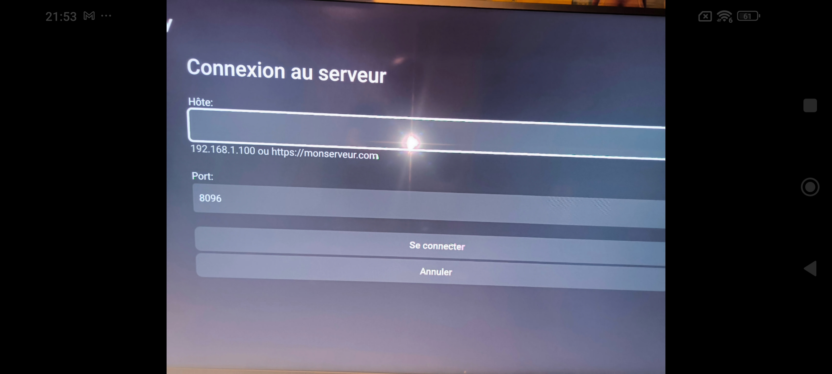

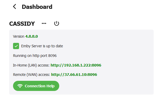

TheTenth 1 Posted August 14, 2024 Author Posted August 14, 2024 I'l stuck as I don't know what IP address to put there, on the TV app, I have a pin, that I put on emby.media/pin on the computer, it says it's ok, then I have a page with "add a server" on the right and "connect to Emby" on the left choosing "add a new server", first line is "host" then Port (8096) then Connect I don't know what Ip or something to put in "host" ; I tried the IP for Wan on the Emby dashboard, but it says it can't find the server (tried in LAN too with the cable)
Luke 42233 Posted August 14, 2024 Posted August 14, 2024 16 minutes ago, TheTenth said: I'l stuck as I don't know what IP address to put there, on the TV app, I have a pin, that I put on emby.media/pin on the computer, it says it's ok, then I have a page with "add a server" on the right and "connect to Emby" on the left choosing "add a new server", first line is "host" then Port (8096) then Connect I don't know what Ip or something to put in "host" ; I tried the IP for Wan on the Emby dashboard, but it says it can't find the server (tried in LAN too with the cable) What is the address of your Emby Server? That's what you should enter there.
TheTenth 1 Posted August 14, 2024 Author Posted August 14, 2024 I tried these with Lan or Wifi, neither works, can't find the server I'm still trying with other server software (simple DLNA, PS3 media server, Windows media, Serviio) none works, they detect the TV (Emby doesn't, sees only Firefox in Devices) but the TV doesn't.
