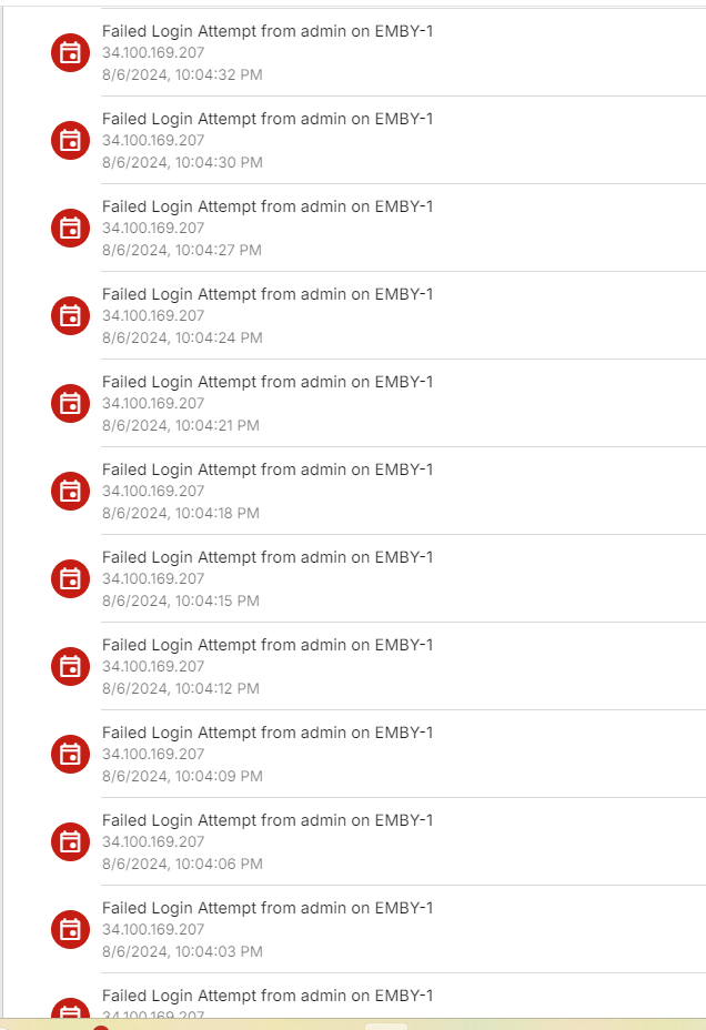

One2Go 122 Posted August 10, 2024 Posted August 10, 2024 5 hours ago, dexus said: So please devs, even if it is not a perfect solution or permanent fix, implement this, or remove the alert, as I can imagine many users get grey hairs when they see all the attempts.. Another irritation, is that it fills up the alert log, thus hindering me to se actual issues I care about, as they are moved down the list before i notice them.. I second that an implementation in an upcoming release. On the Dashboard you get 4 Alerts being listed and not until you actually look at the alert log do you get an idea of how many attempts and from what IP addresses and locations they came. Hopefully this thread and the replies will be enough to consider an implementation of changing the failed login attempts because of non existing user.

gutterdone26 9 Posted August 11, 2024 Posted August 11, 2024 I did have admin as a username during the time of the attack, but have since changed it. I've also changed the ports Emby uses since then. I was just curious how the bot or whatever was able to spam me so many times a few days ago if there's a 10 login limit. I'm on 4.8.8.0.

One2Go 122 Posted August 11, 2024 Posted August 11, 2024 Look at the following tests found on the 1st page: It will tell you what happens. If the user name is non existing, the attempts will continue until the bot gives up. If the bot finds a valid user name it will guess the password and after 10 failed attempts the IP address gets locked out. some of us would like to see Emby handle this differently. @Happy2PlayHow long is the lockout period? Thanks

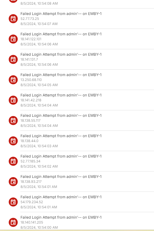

gutterdone26 9 Posted August 11, 2024 Posted August 11, 2024 1 minute ago, One2Go said: By the way that is the same IP address that attacked my Emby server on a QNAP NAS. I just blocked the IP address on my NAS. I was going to block the IP until I looked further back and saw all of these random IPs. This server is kind of a secondary one that I don't use as often and didn't notice this happening right away. I use reverse proxy on my primary server and that one has been fine. Anyway, I've hardened this secondary one a bit and haven't had any more attacks for a few days now. Still not sure why it didn't stop after 10 attempts though.
One2Go 122 Posted August 11, 2024 Posted August 11, 2024 2 minutes ago, gutterdone26 said: I was going to block the IP until I looked further back and saw all of these random IPs. This server is kind of a secondary one that I don't use as often and didn't notice this happening right away. I use reverse proxy on my primary server and that one has been fine. Anyway, I've hardened this secondary one a bit and haven't had any more attacks for a few days now. Still not sure why it didn't stop after 10 attempts though. It ONLY blocks attempts if it is an EXISTING user name. If Admin is non existing it will try until it is decided they will give up. By the way the same dates and IP addresses that you found were also in my log. At present no further attempts on my server also.

ebr 16354 Posted August 11, 2024 Posted August 11, 2024 39 minutes ago, gutterdone26 said: I was going to block the IP until I looked further back and saw all of these random IPs A great example of why blocking by IP isn't as valuable either (in your case, if we blocked the IP, it wouldn't have stopped any of those). Most of these bots use a random one on each attempt to try and get around that. 1 1
One2Go 122 Posted August 11, 2024 Posted August 11, 2024 14 minutes ago, ebr said: A great example of why blocking by IP isn't as valuable either (in your case, if we blocked the IP, it wouldn't have stopped any of those). Most of these bots use a random one on each attempt to try and get around that. ebr, not every Emby user has the ability to set up a reverse proxy and fiddle with the settings to give permissions to some and block others. If Emby does block after a number of failed attempts for non existing user name the bad actor and does not reply with anything that gives an indication of what the results were for the attempted login, it makes it a bit safer against bots. Since I had the same IP addresses that gutterdone26 had, my NAS allows me to block IP ranges which I did and it covered those from Singapore and Hong Kong. So please consider changes in the failed login attempts processing. What is the length of the block out period? Thanks O2G

rbjtech 5345 Posted August 12, 2024 Posted August 12, 2024 13 hours ago, ebr said: A great example of why blocking by IP isn't as valuable either (in your case, if we blocked the IP, it wouldn't have stopped any of those). Most of these bots use a random one on each attempt to try and get around that. I haven't looked into the details - but the problem is emby is REPLYING that the Auth has failed with a normal http response. I'm presuming that you are using a 403 or 423 or 429 etc for the 'locked user' message for a brute force valid username. And the bot is clearly stopping at 10 for this. So you just need to do the same for the non-valid users and the issue is then likely under control. Allowing the bot to continue to spam the emby site is just advertising that server is ripe for a more targeted attack as it's protections are obviously weak. The IP is irrerelevant if the non-user account they are trying to use is returning a 'locked' http response.
