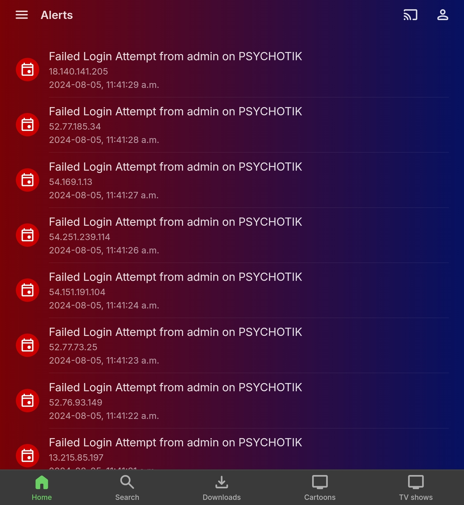

Psychotik 1 Posted August 5, 2024 Posted August 5, 2024 Someone is clearly trying to hack into my server right now with brute force. I can see them try and try. Is there anyway i can protect myself? A 2 factor authentication for example. I remote acess into my server during commute and let familly members access it + 2 close friends. Here a pic of him trying to gain acess. Started trying at 6am.

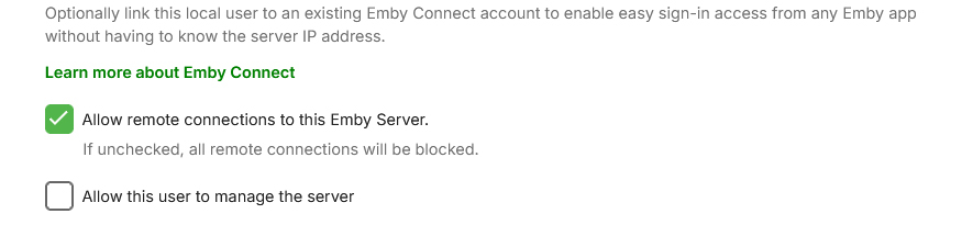

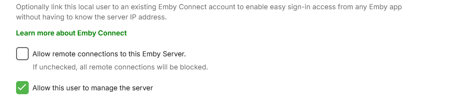

One2Go 122 Posted August 6, 2024 Posted August 6, 2024 (edited) Since I also had yesterday 4 failed login attempts on my QNAP NAS for user Admin, I thought I post here for a "Best Practice" item. I only have 5 remote users plus myself when I go on vacation. To minimize any damage from hacking, I have no user account named "Admin". However I would like some comments on the changes I am about to make to the profile of users. I ONLY manage the server from the local network and if I am away and management of the server is needed, it has to wait until I am on the local network. So here is what I am trying to implement and the User Names are for clarity only. Any comments are welcome. Thanks User for managing the server (Local Admin) Finally the Remote Users with their permissions. Edited August 6, 2024 by One2Go 1

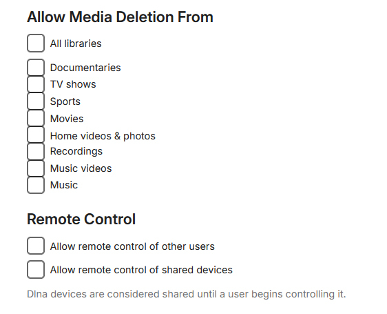

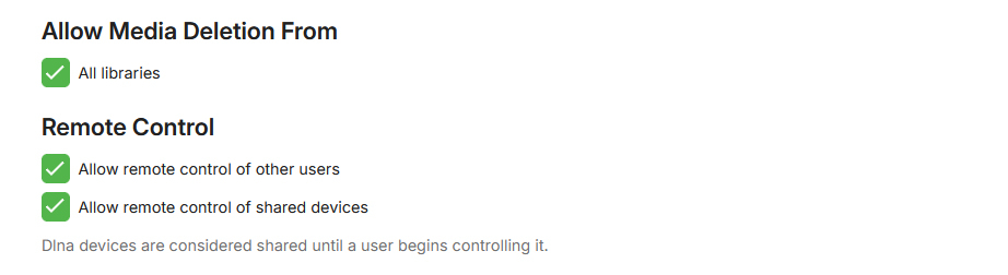

One2Go 122 Posted August 6, 2024 Posted August 6, 2024 (edited) 19 minutes ago, rbjtech said: @One2Go Did you see these in this thread ? These new attacks are possibly related to this - https://www.bleepingcomputer.com/news/security/surge-in-magniber-ransomware-attacks-impact-home-users-worldwide/ I read this thread and implemented the first 5 of your suggestions. My posting was related to your point 3 "Disable remote 'Admin' access". Your point is very well taken, why would you want to do a remote admin. Therefore my screenshots, one account for accessing Emby when traveling and one account when doing admin tasks when at the local network. All deletions of libraries has been disabled for remote users. The bleeping computer article talks about encrypting files, while I have taken steps to prevent that on the NAS level, these attacks are only at the Emby server not at the NAS. Can they encrypt files if they only have playback permissions on Emby? Edited August 6, 2024 by One2Go 1
rbjtech 5345 Posted August 6, 2024 Posted August 6, 2024 54 minutes ago, One2Go said: I read this thread and implemented the first 5 of your suggestions. My posting was related to your point 3 "Disable remote 'Admin' access". Your point is very well taken, why would you want to do a remote admin. Therefore my screenshots, one account for accessing Emby when traveling and one account when doing admin tasks when at the local network. All deletions of libraries has been disabled for remote users. ok great - I'm glad it's been useful to you. 54 minutes ago, One2Go said: The bleeping computer article talks about encrypting files, while I have taken steps to prevent that on the NAS level, these attacks are only at the Emby server not at the NAS. Can they encrypt files if they only have playback permissions on Emby? So I've done some more research on the link I provided - and it's not a remotely executable vulnerability - thus it's not going to impact emby. I've removed the link. It is odd through that there is a flurry of activity with people reporting uninvited access attempts - something that emby need to keep an eye on - but with the low numbers of people reporting it - I don't think it's widespread. I don't see any attempts, but then again, I don't use emby ports..

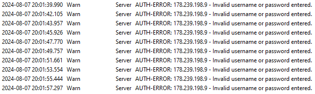

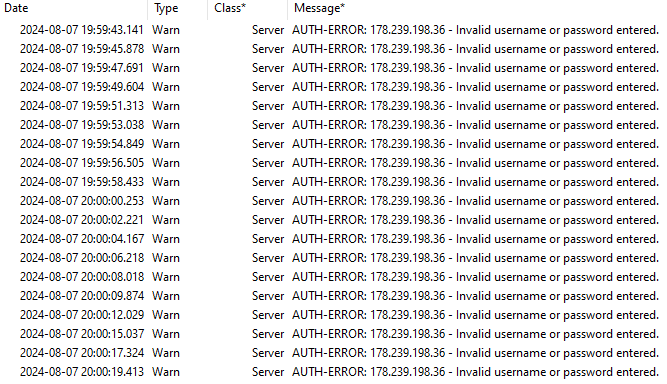

One2Go 122 Posted August 7, 2024 Posted August 7, 2024 (edited) On 8/5/2024 at 2:10 PM, rbjtech said: Emby has built in brute force protection - it should be locking 'admin' for a period after I believe it's 10 failed attempts. It's not as flexible as using a reverse proxy and f2b etc, but it achieves the same result to stop a constant brute force. It looks like that it DOES NOT lock out failed admin login attempts after trying a number of times. I went to the Alert log and found out that attempts to login as admin and username from one single IP address has been going on for hours. I gave up after counting 20 failed login attempts. The entire trying to log in started on 8/5/2024, 2:49:00 AM prior to that, nothing. This is from the Alert log: Started at: Failed Login Attempt from username on QNAP-NAS 34.100.169.207 8/6/2024, 11:08:35 PM Ended after 49 attempts at: Failed Login Attempt from username on QNAP-NAS 34.100.169.207 8/6/2024, 11:10:58 PM Than followed by the username of admin for countless attempts every few seconds: Started again at: Failed Login Attempt from admin on QNAP-NAS 34.100.169.207 8/6/2024, 11:11:39 PM Ended too many attempts to count at: Failed Login Attempt from admin on QNAP-NAS 34.100.169.207 8/7/2024, 12:05:07 AM How can Emby allow so many failed login attempts from a single IP address? Is there a setting that I missed or is the blocking something that needs to be implemented? I am at the latest version of Emby. @Luke@ebr@softworkzPlease leave some advise or answers to this occurrence of mine. Edited August 7, 2024 by One2Go 1

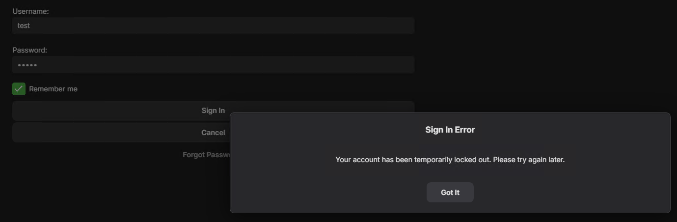

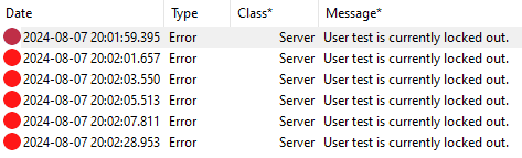

rbjtech 5345 Posted August 7, 2024 Posted August 7, 2024 (edited) Ah - a sloppy user based implementation - it only locks out the user if the username is correct and password is wrong. It doesn't lock out if an incorrect username is used - agree 100% ... If I use Admin - no lockout, if I use test (a quick account I just created) then I do get lockout .. User Admin (does not exist..) User test - does exist - locked out after 10 tries. ps - don't care about showing the client IP - this is from a VPN. -edit- At leasy my Pushover alerting is working, as it went balistic when testing this. Both 'Admin' and 'test' sent the alert to my phone using the Emby Notifications. -edit 2-The issue is going to be that while locking a user is relatively easy - Emby is going to have to blacklist the IP (which you can do in GUI today) - the issue is I'm not sure if that can be dynamically blocked, as any network configuration change usually needs a reload ... lets see. Edited August 7, 2024 by rbjtech
One2Go 122 Posted August 7, 2024 Posted August 7, 2024 6 minutes ago, rbjtech said: Ah - a sloppy user based implementation - it only locks out the user if the username is correct and password is wrong. It doesn't lock out if an incorrect username is used - agree 100% ... If I use Admin - no lockout, if I use test (a quick account I just created) then I do get lockout .. I thought that the protection should have been better implemented for user login when attempts are failing. On my NAS I can specify that after like 5 attempts the IP address is banned for 24h or longer. Don't know if the implementation for that in Emby would be difficult. 1
ebr 16354 Posted August 8, 2024 Posted August 8, 2024 18 hours ago, rbjtech said: a sloppy user based implementation Completely unfair, IMO. It is effective for what it needs to do and within the scope of our product. If the user doesn't exist, what would be locked out? You might say something like IP address but my response would be that would have limited effect and, also, that level of blocking is better left to something at the network level. If they try forever with an invalid user, what is the harm? They'll never get in... so, aren't they effectively "locked out" of Emby? 1 2
One2Go 122 Posted August 8, 2024 Posted August 8, 2024 30 minutes ago, ebr said: Completely unfair, IMO. It is effective for what it needs to do and within the scope of our product. If the user doesn't exist, what would be locked out? You might say something like IP address but my response would be that would have limited effect and, also, that level of blocking is better left to something at the network level. If they try forever with an invalid user, what is the harm? They'll never get in... so, aren't they effectively "locked out" of Emby? You do have a point with your assumption, however do the repeated attempts have an impact on the NAS performance when someone is streaming? Do the Blacklist function prevent the person from attempting to login? Since I have only a few users I have toyed around with the idea of using the Whitelist function after monitoring the situation for awhile. The attacks have since then stopped. Please let me know the answers to the two questions.
ebr 16354 Posted August 8, 2024 Posted August 8, 2024 Just now, One2Go said: do the repeated attempts have an impact on the NAS performance when someone is streaming? Even if we put the IP on a "blocked" list, the attempts would still be getting to and being processed by your Emby server - it would just be failing a different way other than the user not existing. The net effect will be exactly the same. That's why, doing stuff at the IP level is better left to the network layer somewhere else - then that traffic never even gets to Emby. 2 minutes ago, One2Go said: Do the Blacklist function prevent the person from attempting to login? Sorry, I don't really understand that question.
