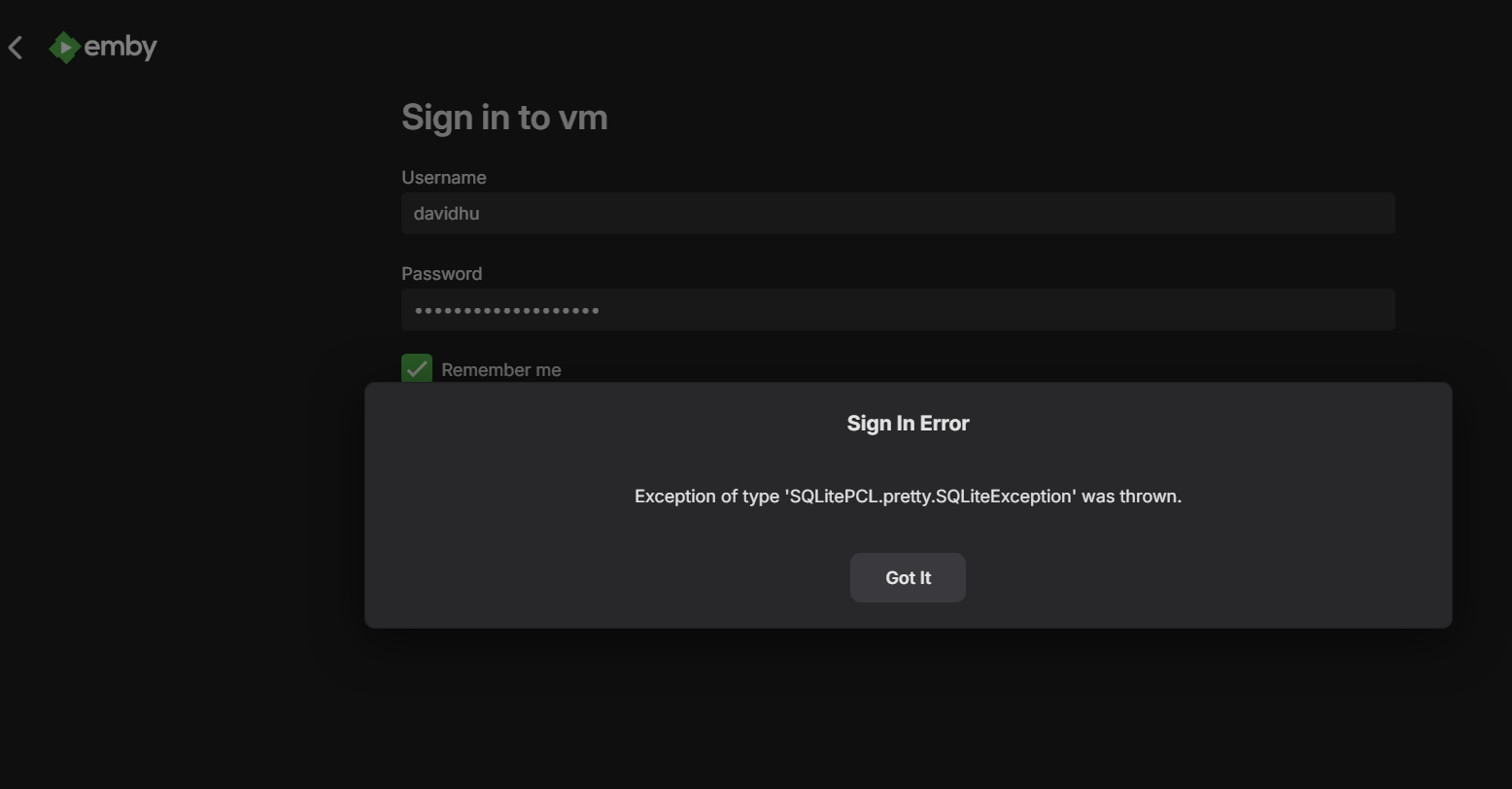

davidhu1207 1 Posted July 20, 2024 Posted July 20, 2024 Today I renamed a library in the media library, and then all the media library contents became empty so can not to play normally. I tried to reinstall OS and EMBY service but face the same issue. and now I got a new problem that I can only create ONE library, it will be empty again if I create secondary library. Does anyone know how to solve this problem? thanks in advanced !

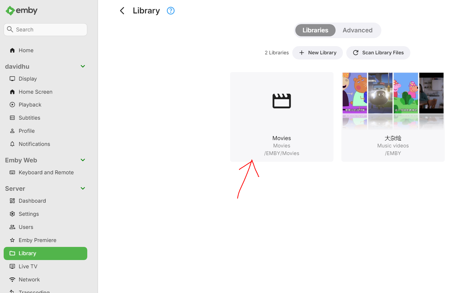

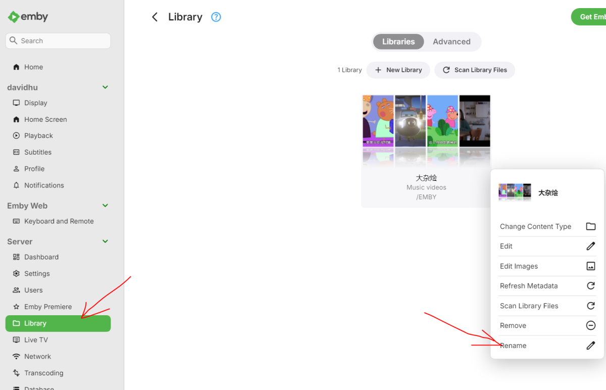

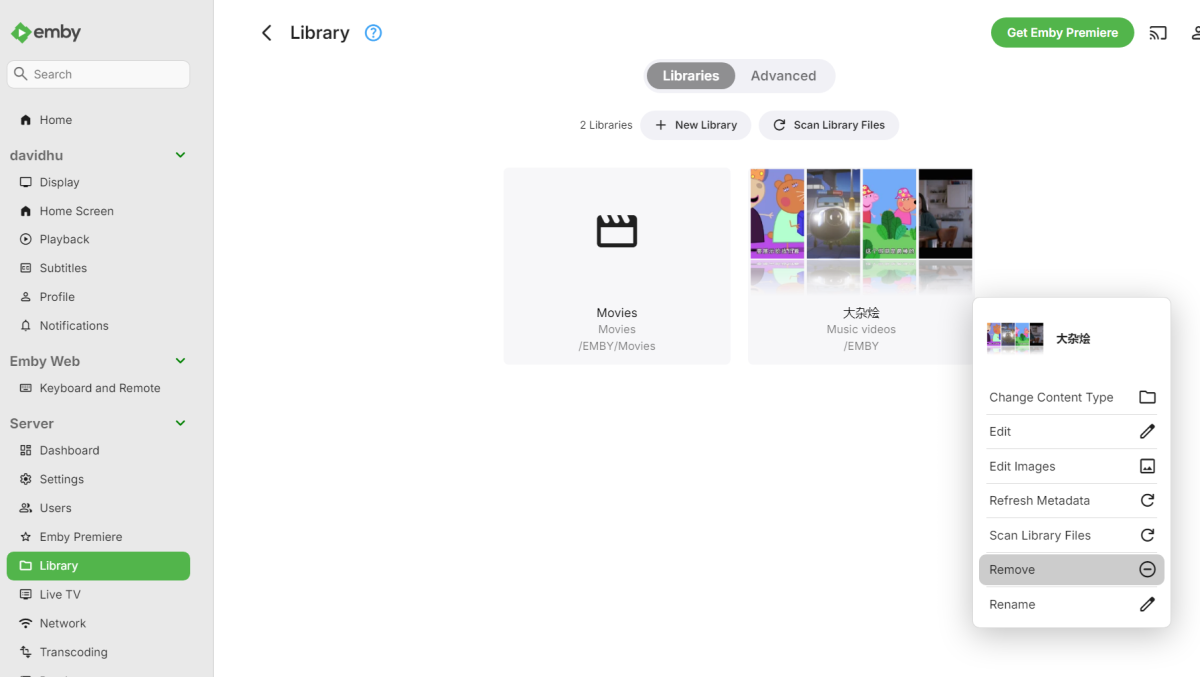

davidhu1207 1 Posted July 20, 2024 Author Posted July 20, 2024 4 hours ago, Happy2Play said: What do you mean you renamed a library? How many libraries do you have and what are their paths? But sounds like you have overlapping library paths. Please post the server log also. I mean the rename library please refer to the snapshot. Will got the error message and then all library will be can not play normally because show up is empty. However I have tried to remove all libraries and added again, but still face the issue that the first added library can be work, all other library are empty. I have 8 libraries and still work well before I tried to rename one library. and now no more log can provide because I have reinstall OS and EMBY service. but the issue that the first added library can be work, all other library are empty still again.
Happy2Play 9812 Posted July 20, 2024 Posted July 20, 2024 (edited) Okay and the server log as the screenshot is not the complete error. But without all the original libraries and log it will be impossible to say. What where/are all library paths? As they can not overlap each other. Edited July 20, 2024 by Happy2Play

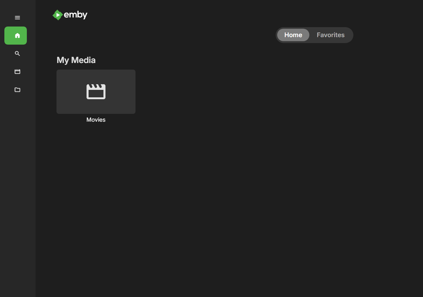

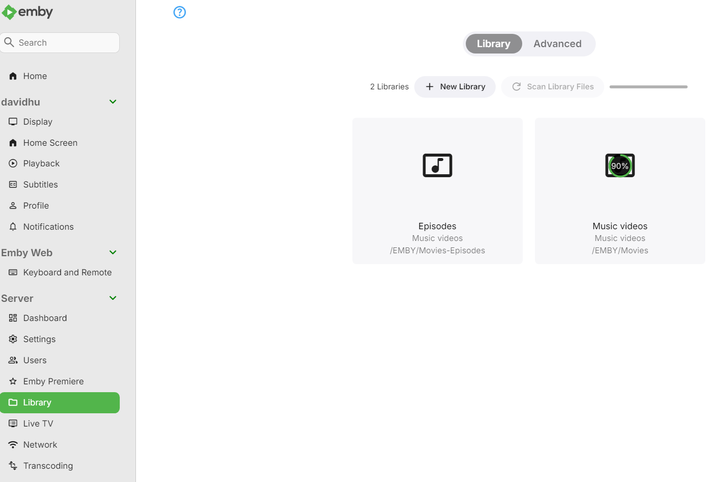

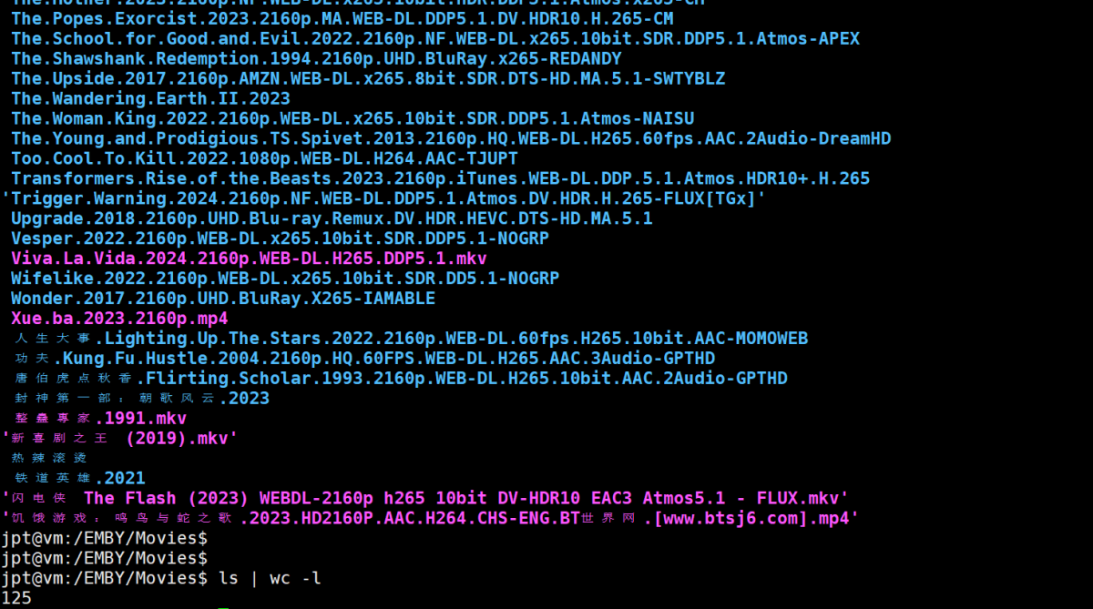

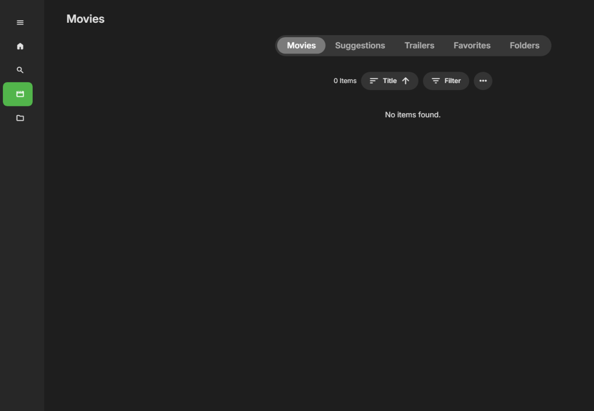

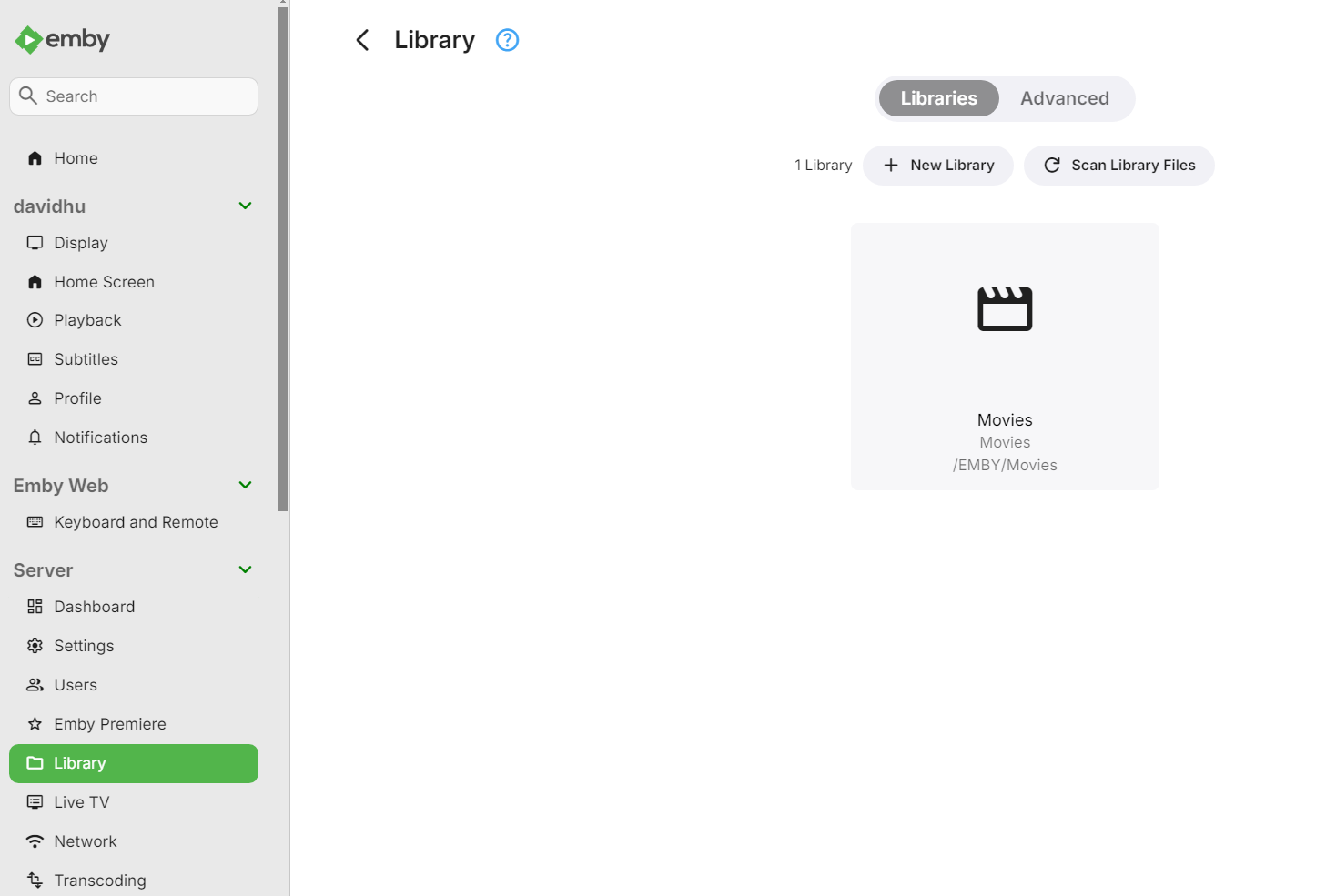

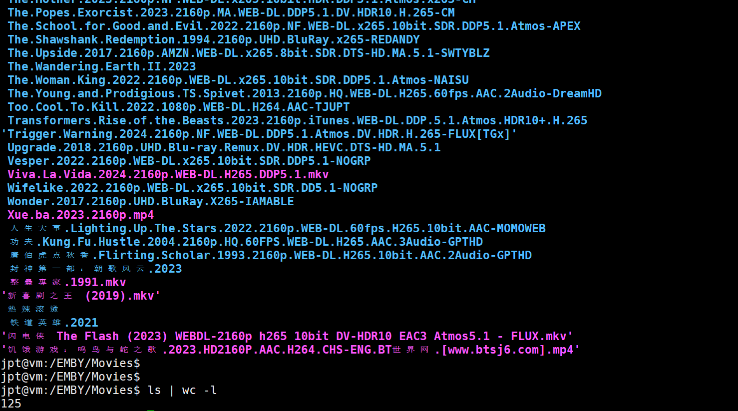

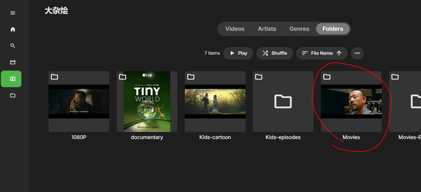

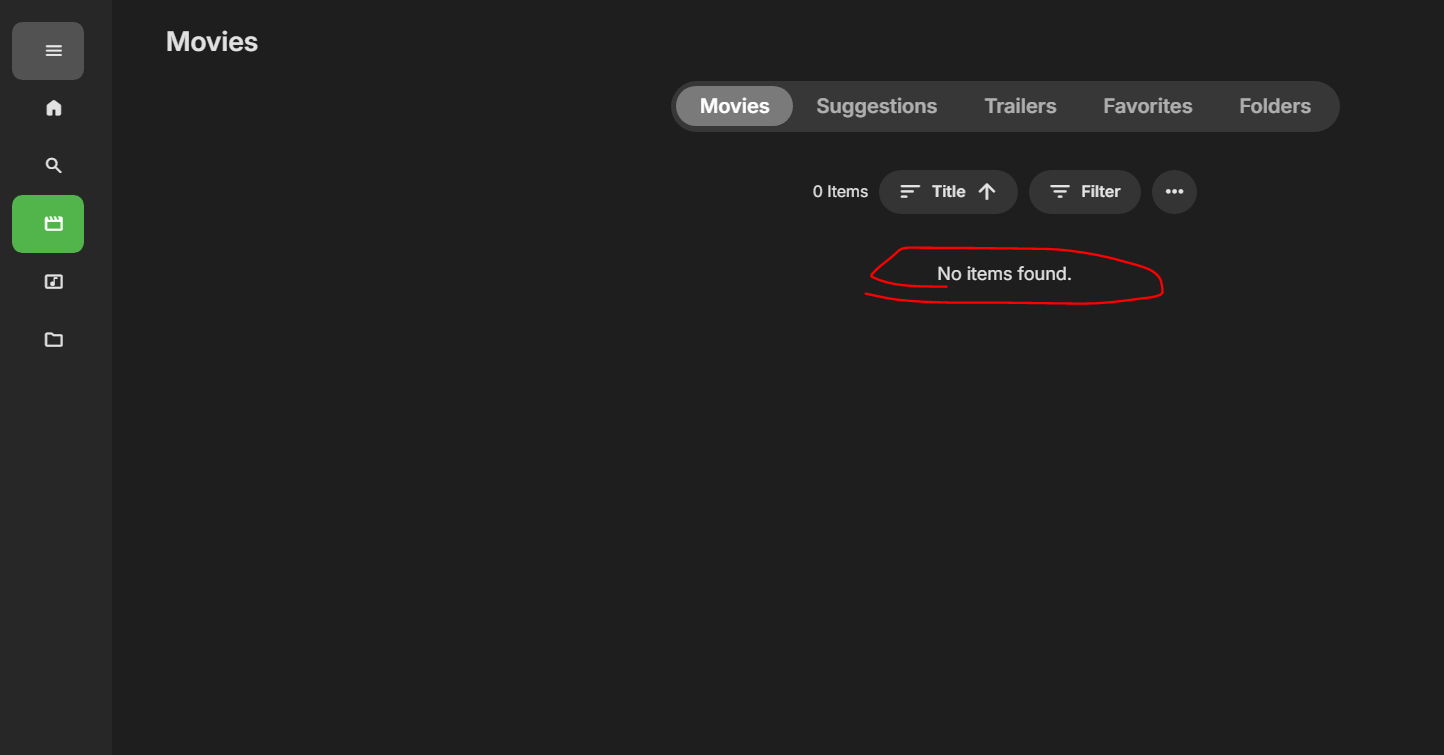

davidhu1207 1 Posted July 20, 2024 Author Posted July 20, 2024 When I add new library and then it show "No items found", rerfer 1.PNG and 2.PNG. but actually the there have125 video files in that folder. and in the first library is work well refer to 3.PNG and 4.PNG
Happy2Play 9812 Posted July 20, 2024 Posted July 20, 2024 Yes per your image Music video library will kill all other libraries do to parent path /Emby. No other library can ever be a child of any other library so /Emby/Movies will not work as /Emby is already a library. You have to make music videos something like /Emby/Music Videos.
davidhu1207 1 Posted July 20, 2024 Author Posted July 20, 2024 8 minutes ago, Happy2Play said: Okay and the server log as the screenshot is not the complete error. But without all the original libraries and log it will be impossible to say. What where/are all library paths? As they can not overlap each other. I have 7 libraries as below path. I have delete all libraries and add only one to the /EMBY. it can see all contents now. but I want to create more libraries for echo sub-folder, but just first one library is work, I really don't know what the root issue. do you know, I have use the 7 folders for 2 years and no any issue. this is my first face the problem at yesterday, and can not be to fixup include reinstall EMBY and reinstall OS and EMBY. /EMBY/1080P/ /EMBY/ documentary/ /EMBY/Kids-cartoon/ /EMBY/Kids-episodes/ /EMBY/Movies/ /EMBY/Movies-Episodes/ /EMBY/TEST/
Happy2Play 9812 Posted July 20, 2024 Posted July 20, 2024 You can not have a root folder library and a subfolder library as it creates SQLiteException: Constraint: FOREIGN KEY constraint failed issue in the database. https://emby.media/community/index.php?/topic/128180-sqliteexception-constraint-foreign-key-constraint-failed So all library path can not have any child libraries. So you can not have a /EMBY library and all the others. Delete that library /Emby and all the others will work.

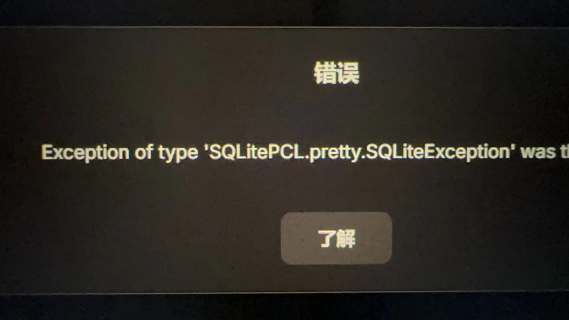

davidhu1207 1 Posted July 20, 2024 Author Posted July 20, 2024 7 minutes ago, Happy2Play said: Yes per your image Music video library will kill all other libraries do to parent path /Emby. No other library can ever be a child of any other library so /Emby/Movies will not work as /Emby is already a library. You have to make music videos something like /Emby/Music Videos. it's only work first one library so I create /EMBY, Below is my libraries, but only one can work since pop the error message Exception of type 'SQLlitePCL.pretty.SQLiteException'.... /EMBY/1080P/ /EMBY/ documentary/ /EMBY/Kids-cartoon/ /EMBY/Kids-episodes/ /EMBY/Movies/ /EMBY/Movies-Episodes/ /EMBY/TEST/
davidhu1207 1 Posted July 20, 2024 Author Posted July 20, 2024 4 minutes ago, Happy2Play said: You can not have a root folder library and a subfolder library as it creates SQLiteException: Constraint: FOREIGN KEY constraint failed issue in the database. https://emby.media/community/index.php?/topic/128180-sqliteexception-constraint-foreign-key-constraint-failed So all library path can not have any child libraries. So you can not have a /EMBY library and all the others. Delete that library /Emby and all the others will work. it's no the issue, I have delete /EMBY library and keep another one and face the same issue.
Happy2Play 9812 Posted July 20, 2024 Posted July 20, 2024 You cannot have a /Emby library and creates any other library containing /Emby/xxxxxxxxxxxxxx as the path is already in the database and cannot be used again. So if you want /Emby/1080p you have to remove /Emby library completely. There is no way to have both. So you most likely will have to remove all libraries and hope the db clears itself otherwise you will have to start over.

davidhu1207 1 Posted July 20, 2024 Author Posted July 20, 2024 47 minutes ago, Happy2Play said: You should not have any issues as long as you do not have parent and sub-folders libraries on a new install. BIG ISSUE,I can't login to the web EMBY still show the ERROR MESSAGES 'SQLlitePCL.pretty.SQLiteException..' since update EMBY from 4.8.8 to 4.9.0.27 BETA
Happy2Play 9812 Posted July 21, 2024 Posted July 21, 2024 1 minute ago, davidhu1207 said: BIG ISSUE,I can't login to the web EMBY still show the ERROR MESSAGES 'SQLlitePCL.pretty.SQLiteException..' since update EMBY from 4.8.8 to 4.9.0.27 BETA Without logs it is impossible to say.
