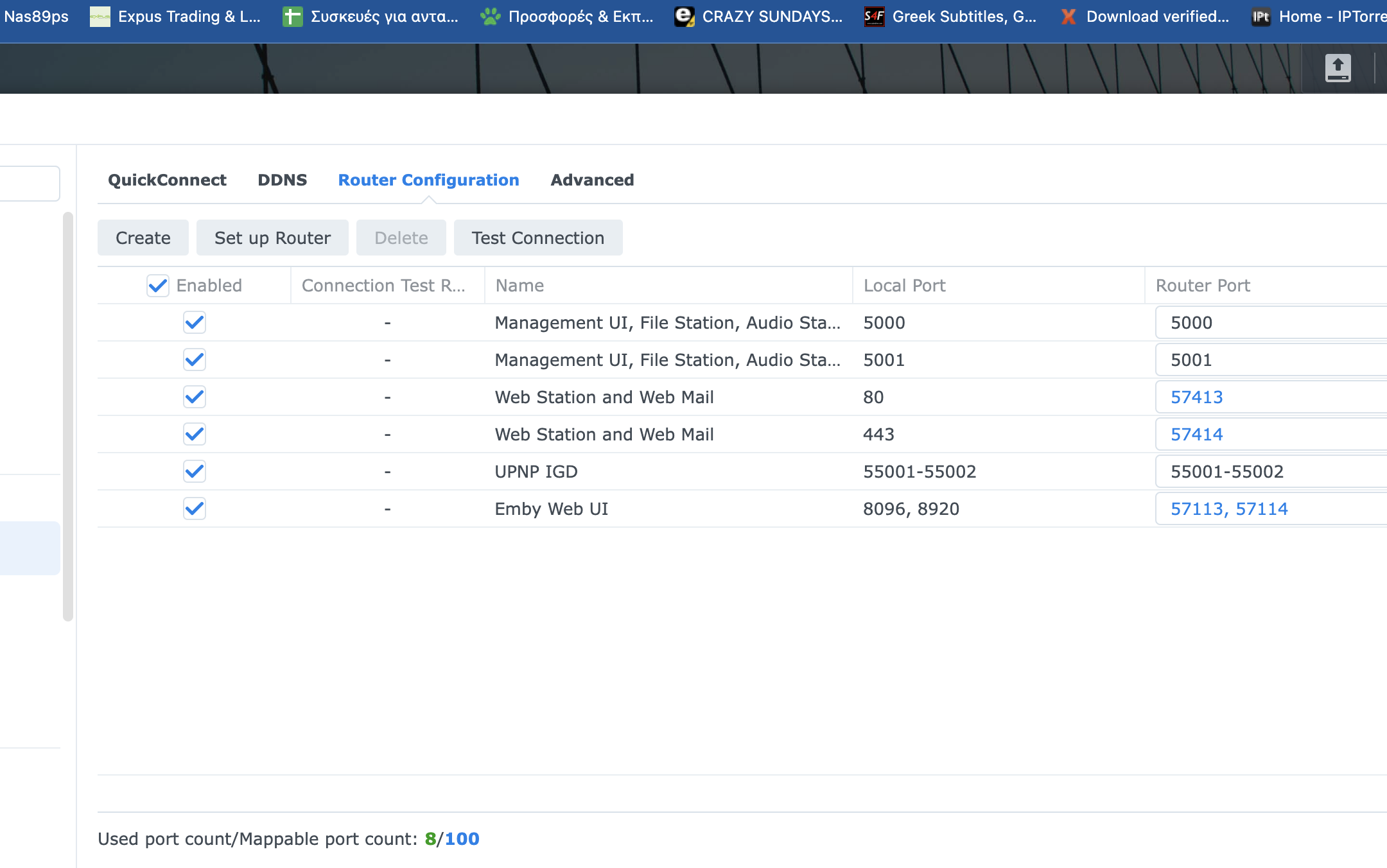

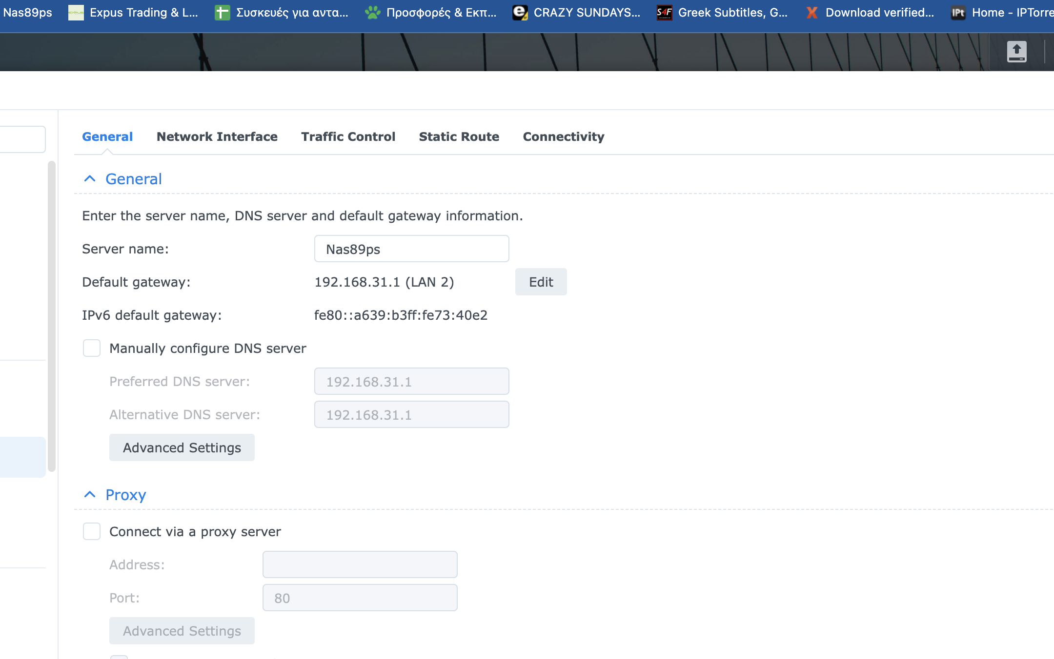

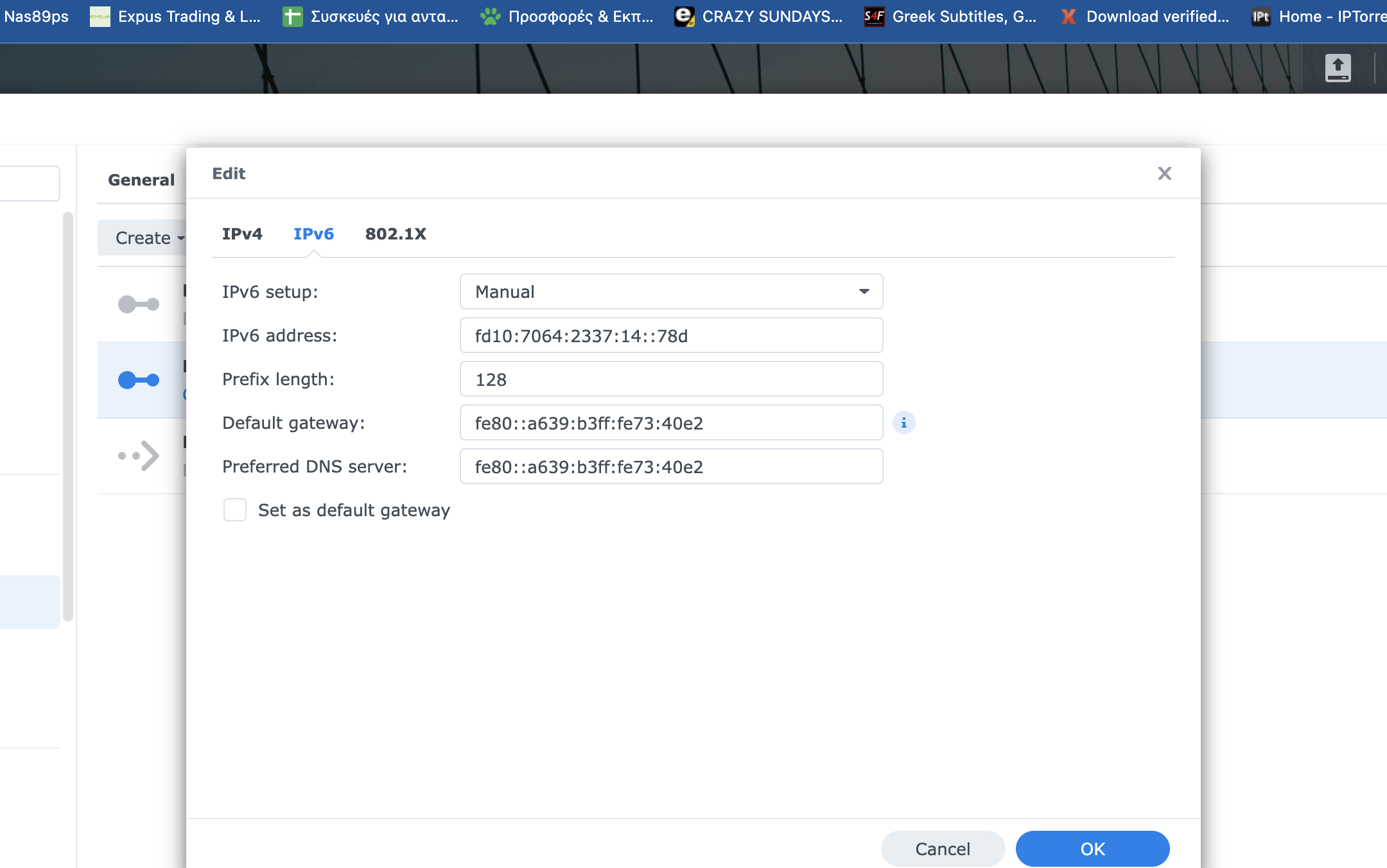

Frago21ps 3 Posted July 12, 2024 Posted July 12, 2024 So another user changed to starlink,Before i changed i read about ipv6 with external router and i have a Xiaomi AX3200 which have ipv6 support,i have enable ,synology see ipv6 network but my knowledge stop there,cant make it work,is anyone to guide me and make it work outside home network?

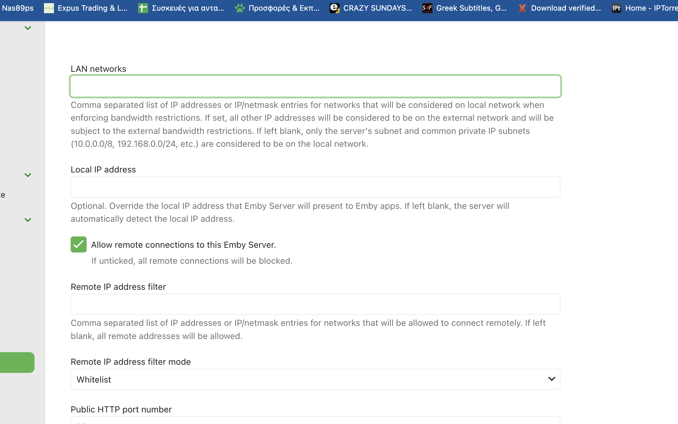

Frago21ps 3 Posted August 15, 2024 Author Posted August 15, 2024 Just now, skidmarks said: I am trying it with a public IP number with the business class priority 40G plan. Bypassing all the CGNAT nonsense. Are you doing the same? Yes trying to get emby work outside home but didn't find a solution, some guides are here but hard for me

skidmarks 199 Posted August 17, 2024 Posted August 17, 2024 (edited) I can access EMBY now from a WAN connection! #1: I upgraded to the 40G Priority Business class. $20 more a month than the standard home plan. This provided me with an almost static PUBLIC IP number. #2: Get a router that you can use, i have a ORBI Mesh system now. Most important part is said router must include port forwarding. #3: Put the Starlink Router In Bypass mode. #4: Connect your router to the Starlink. Assign your internal sever a static LAN IP number. Reserve that IP number in the DHCP settings or give the server a static IP number that is not in the DHCP range. #5: Port forward the port used by EMBY. should be 8096 unless you manually changed it from embys dashboard. DONE! The public IP number that is provided may change occasionally, but they suggest that it will only change during prolonged power outages, if you move your location (which is only a problem if you are roaming with the dish) and if they do software updates. I have read that some haven't had the public IP number change in over a year. There are a few ways that people are getting around the CGNAT issues with Starlink. Did i want to give Elon another $20.00 a month? NO! But it seemed to be the more logical and simplest way, for me, to go. Edited August 17, 2024 by skidmarks 1 1
