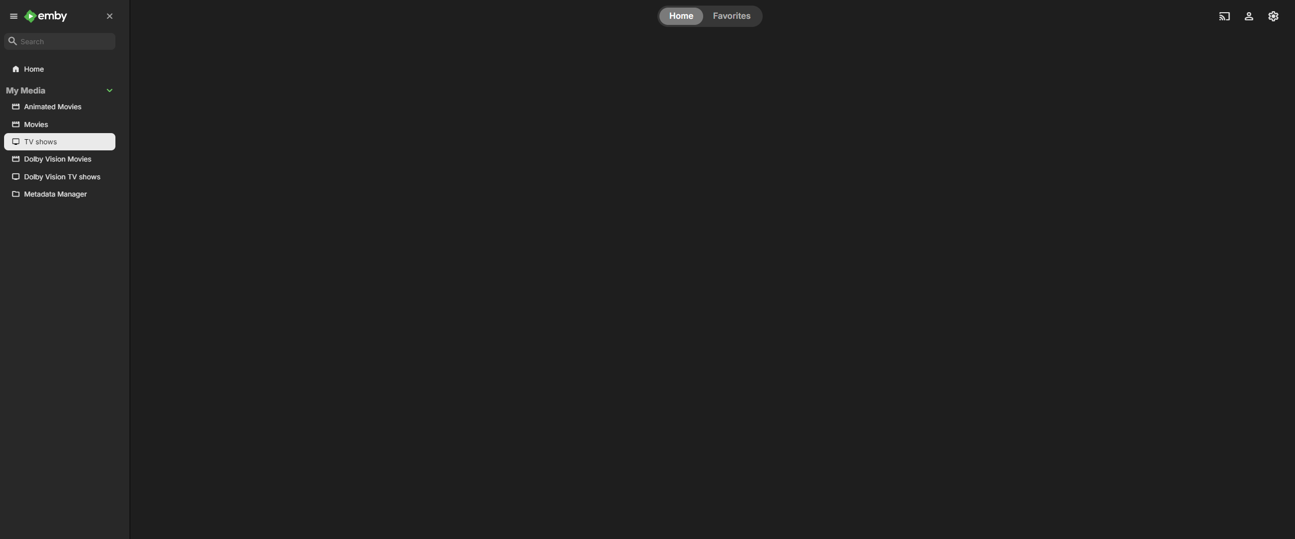

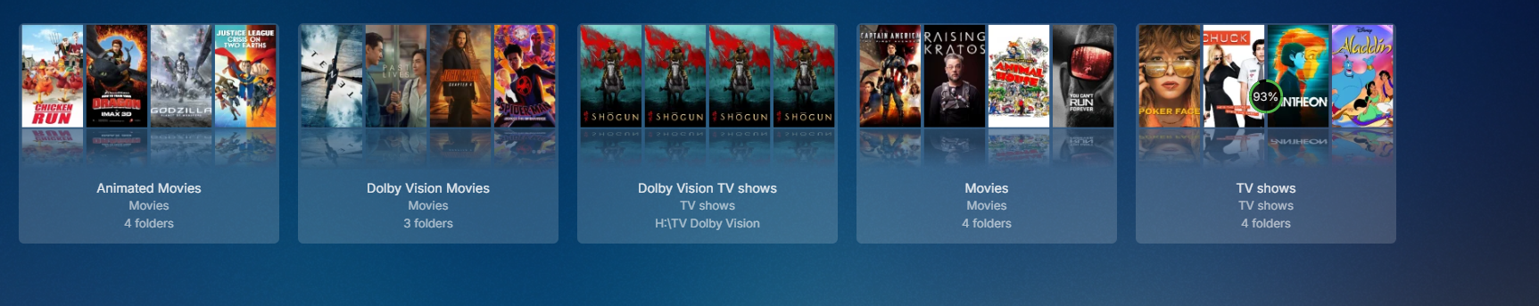

Zerok 2 Posted June 25, 2024 Posted June 25, 2024 Hi All - As of this morning my TV Shows library seems to be broken. If I click on it I don't see anything load, but if I go into Settings > Libraries I see the folders added for this section. I tried reinstalling Emby and even rebooting my system, but I can't seem to figure out what the issue is. I can see the TV Shows library just fine on the Plex client, so I know the drives are mounted correctly. Any assistance would be greatly appreciated.

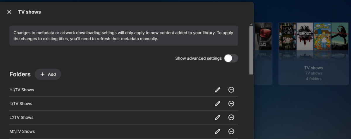

Happy2Play 9798 Posted June 25, 2024 Posted June 25, 2024 37 minutes ago, Zerok said: No changes at all. Server has been up for 2 weeks and figured a reboot it would have fixed it. I am on Version 4.8.8.0 Please provide the server log. May also need to see applied folder paths for each library.

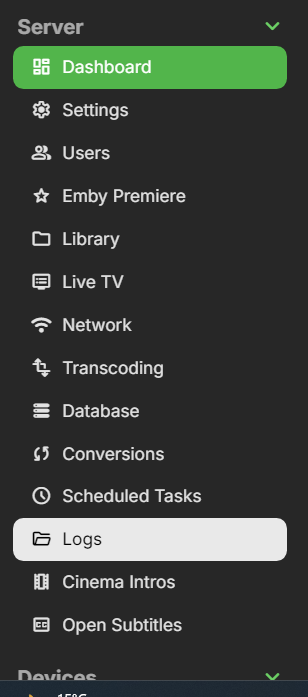

RanmaCanada 500 Posted June 26, 2024 Posted June 26, 2024 I had something similar happen and ended up having to remove my entire TV library, wait a few hours (as the sql database was updating), then re-add the folder. Something is broken with the latest update. To get to the logs, just go to manage server, then on the left hand side you will see 1

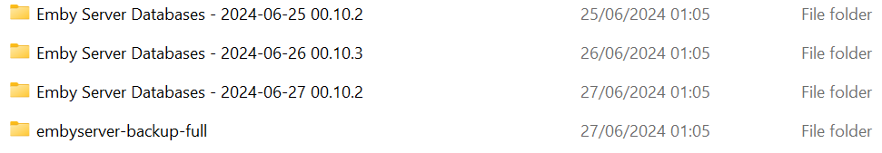

sa2000 690 Posted June 27, 2024 Posted June 27, 2024 (edited) You could check the backed up library db files here if any do not fail on the PRAGMA Integrity_check Your path is here I:\Emby Server Databases - 2024-02-03 00.10.6\ See if you are keeping extra backup copies in addition to the last full backup in embyserver-backup-full which I presume is corrupt This is what my backups directory looks like Edited June 27, 2024 by sa2000
