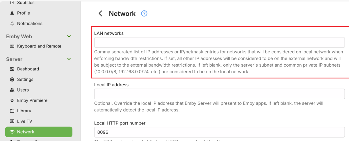

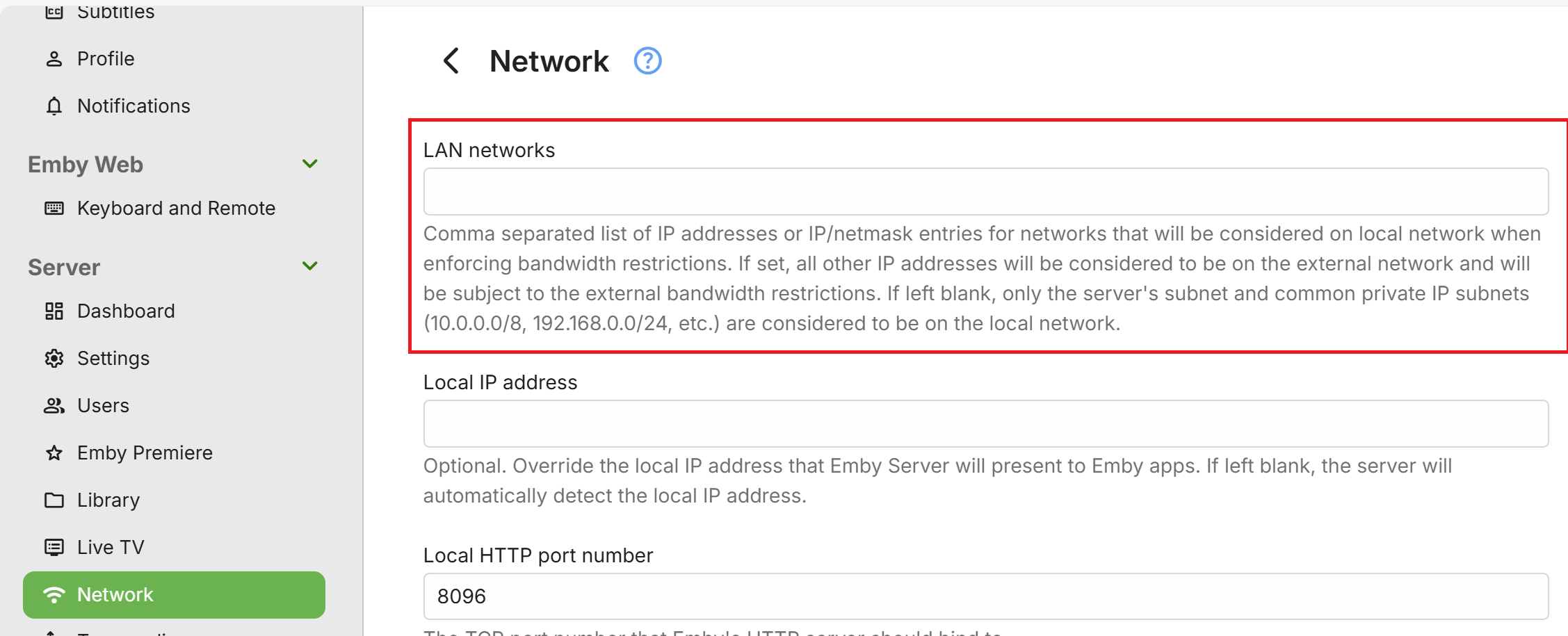

sa2000 697 Posted July 10, 2024 Posted July 10, 2024 (edited) 19 hours ago, Q-Droid said: I suspect this would've worked if the OP had added the local VPN (wireguard) subnet to the LAN subnet in the Emby network settings? Nothing else needed unless this was tried and I missed i Thanks. Yes that would be an easier option. I don't think it was tried and @cptbrainiafound that enabling Remote Connections made it work. I see that we just mention Bandwidth Restrictions for this "LAN networks" setting. That would need tweaking. @cptbrainiaCould you try this as alternative to having Remote Connections enabled - especially since you indicated you did not want remote access. So find the IP address subnet used by the VPN locally and add that subnet to the LAN networks server setting. This is the screen in Server Settings Edited July 10, 2024 by sa2000
Neminem 1623 Posted July 10, 2024 Posted July 10, 2024 Just remember to also add you Lan network range in there too. Other wise you might not be able to login with your lan connection. Here is my lan network config. Wireguard Lan 10.253.0.0/24 192.168.1.0/24 10.253.0.0/24, 192.168.1.0/24 1 1
