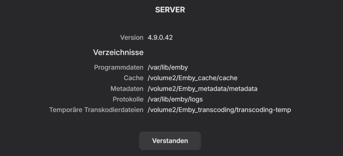

steamhead 10 Posted September 22, 2025 Posted September 22, 2025 To add some further feedback to the Debian package install method, I've just installed Emby using the deb package on a DXP8600 and it is working wonderfully. Some points to consider though for better UGreen integration. As mentioned before there definitely needs to be a way to integrate the emby user into the UGOS UI. The workaround of creating a UGreen group and then adding the emby user to the group by editing the groups file works, but could be a bit daunting to some. The install puts all the emby stuff on the system SSD, whereas UGreen apps let you pick a destination elsewhere which is probably a good precaution for people with large databases, to avoid swamping the system disk. For now, to avoid this I've pointed /var/lib/emby to another storage group by a symbolic link. I used the "systemctl enable emby-server.service" command to try and get emby to start automatically with the server. On startup of the NAS I get an error complaining about /var/lib/emby already existing, which seems a bit odd given it contains persitent data. However if I issue "systemctl start emby-server" it starts fine. I suspect it may be something to do with the redirect of /var/lib/emby but I've not figured it out yet. Until then I just have to remember to start emby manually. 1

steamhead 10 Posted September 23, 2025 Posted September 23, 2025 >Perhaps a simple `sudo systemctl enable emby-server` would be enough to register em as a boot service. As mentioned I already tried that. The service is registered and tries to start on boot, but throws an exception complaining about /var/lib/emby already existing. But no such complaint if I try and start it after the boot. Not sure what is going off there.
