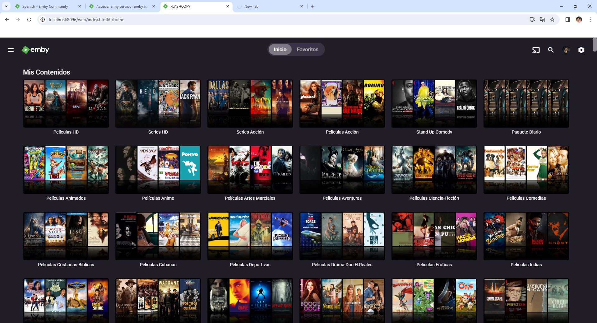

HannibalRoG 1 Posted January 13, 2024 Posted January 13, 2024 (edited) @Luke Tengo el mismo problema, se reinicio la pc donde esta instalado Emby server y solo abre desde localhost, ni siquiera usando la direccion ip desde la misma pc deja acceder a emby. Usando 127.0.0.1 carga Usando la ip del servidor no carga Edited January 13, 2024 by HannibalRoG

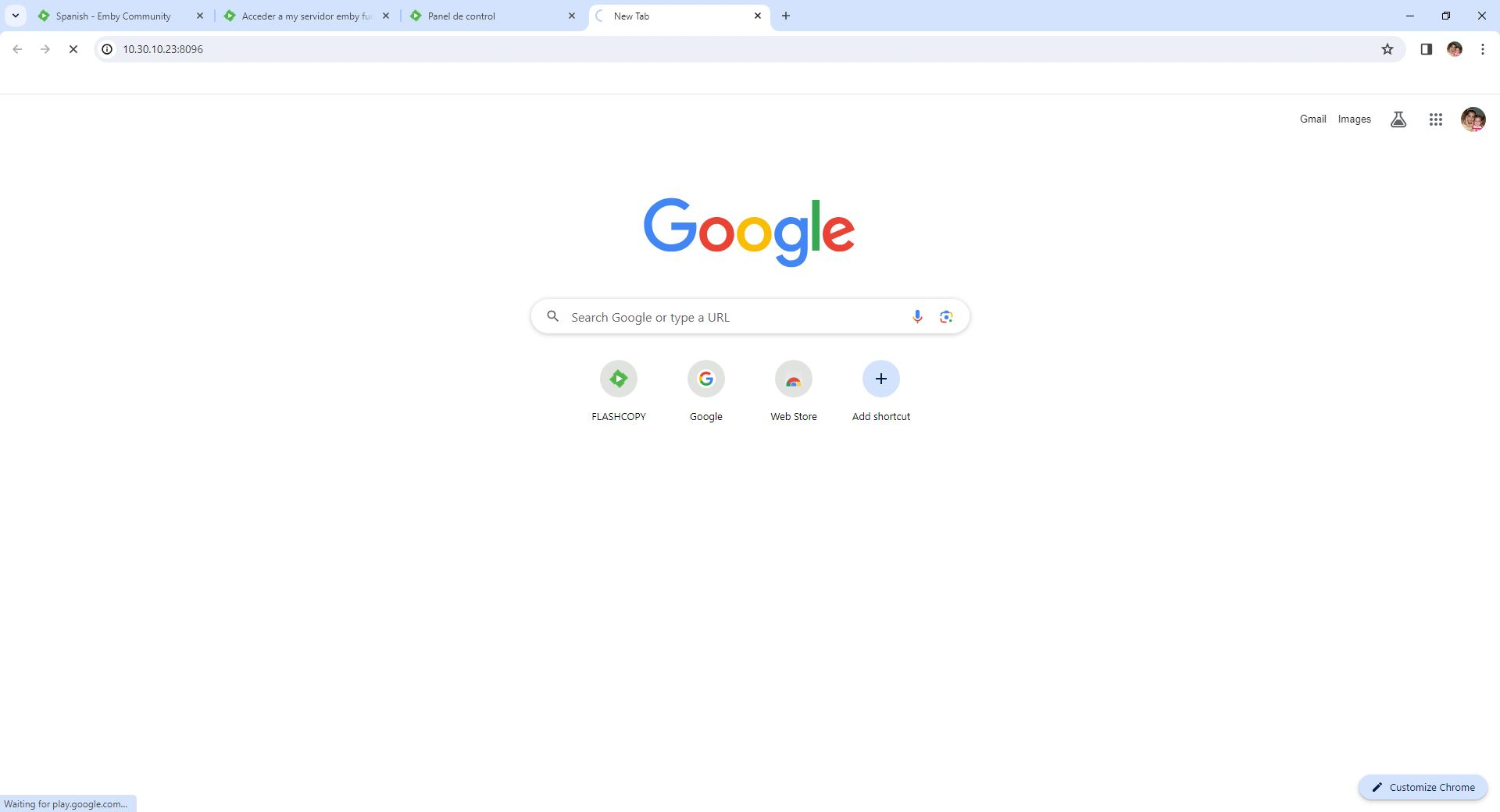

HannibalRoG 1 Posted January 13, 2024 Author Posted January 13, 2024 I posted in another topic but my problem is a little different. I had to restart the PC where emby server is and now it can only be accessed from localhost. Emby can be accessed from any PC on the local network or even from the same server using the IP. Any ideas? With localhost With Ip embyserver.txt

HannibalRoG 1 Posted January 13, 2024 Author Posted January 13, 2024 5 minutes ago, Luke said: @HannibalRoGI would suggest checking out our Connection Troubleshooter: Connectivity Please try the steps listed there and let us know which ones succeed and which ones do not. Thanks ! The only thing that could be blocking the connections would be the Windows firewall, but even when disabled it does not allow access from ip address. But even with the firewall activated it only allows access using localhost:8096 not with 10.30.10.23:8096 on the PC where the Emby server is.

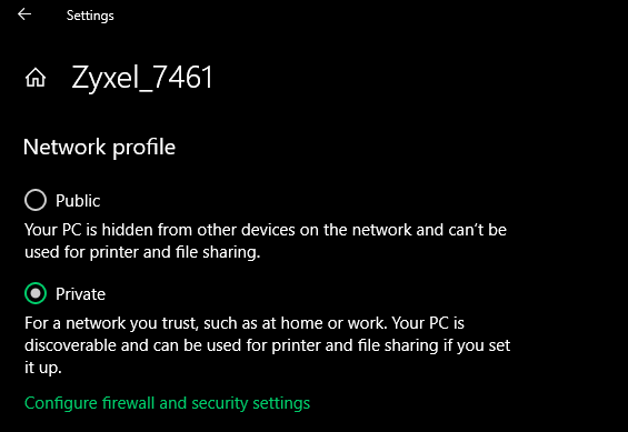

Neminem 1594 Posted January 13, 2024 Posted January 13, 2024 Check your NIC settings, that might have been set to public. After a reboot or windows update. 3
