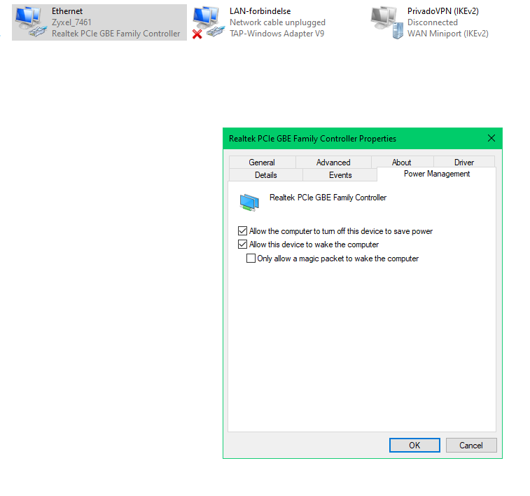

Neminem 1594 Posted January 11, 2024 Posted January 11, 2024 It sounds like your NIC is in sleep mode. Try turning that off. Untick Allow the computer to turn off this device to save power.
gid 0 Posted January 11, 2024 Author Posted January 11, 2024 I did it and it didn't help. It could not have helped because this is my main PC, when I switch the TV on it's only to move from the PC to the TV. The PC is continuously active and connected to the internet, and the network card never gets a rest.

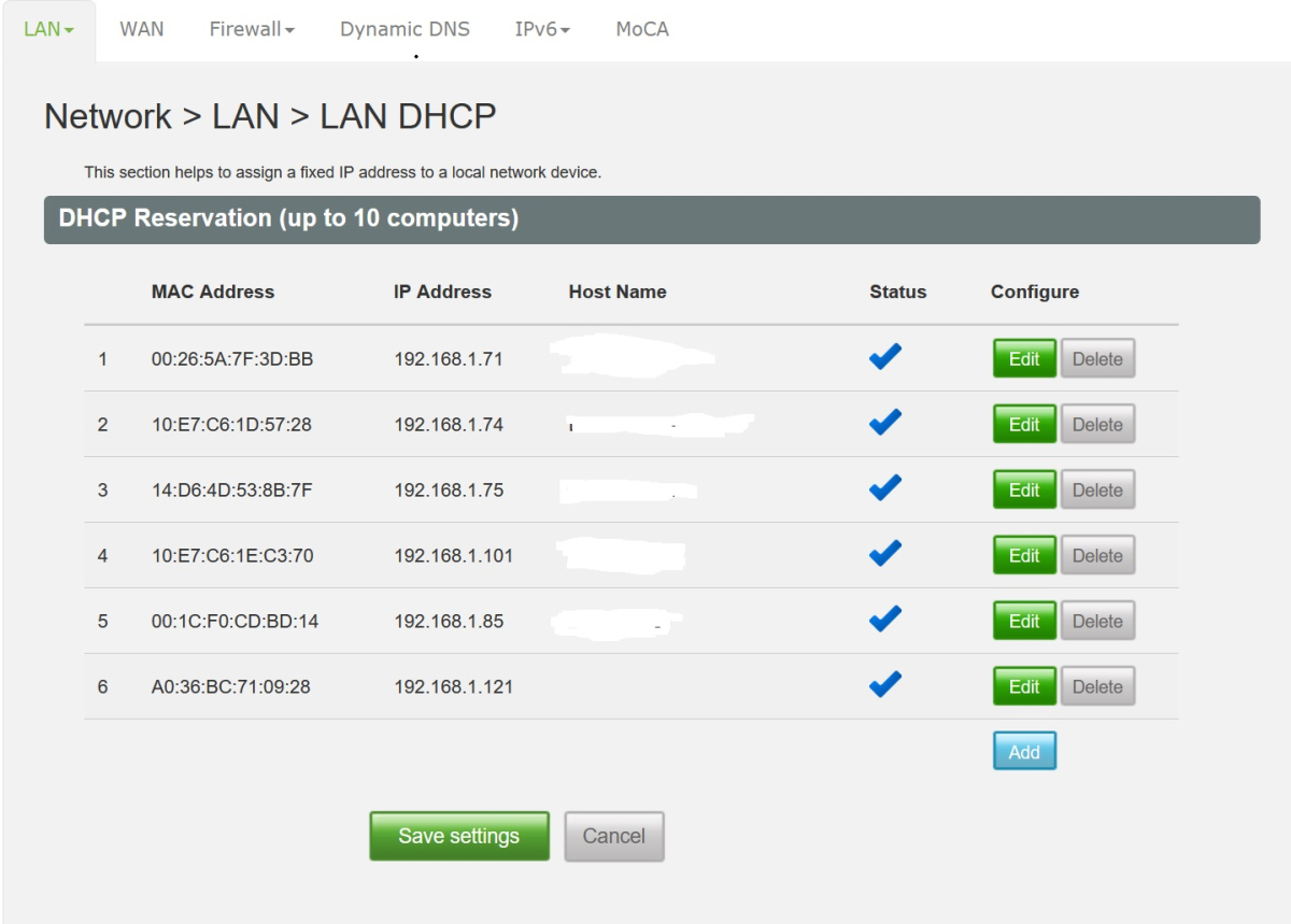

Luke 42184 Posted February 1, 2024 Posted February 1, 2024 On 1/30/2024 at 4:07 PM, gid said: No but recently the situation has improved a little bit on its own over the past 3-4 days: Now it fails to connect, takes me to the screen where I try again or define a new server, and if I try again, it succeeds. So no need to restart anything or dis/reconnect any cables. Not good, but better than before. That makes it sound like your server address is changing. In other words, the app saves the server ip address, then in between usages at some point it changes. Then you start the Emby Samsung app and it can no longer connect and needs to be configured again. Can you assign a static ip address for your server machine in your router's settings?
gid 0 Posted February 1, 2024 Author Posted February 1, 2024 My network address is already statically assigned and never changes.
tedfroop21 89 Posted February 1, 2024 Posted February 1, 2024 Does your router offer the option to reserve an IP address for your server? It is possible it is not being added to the routing table because its not DHCP. Kind of rare but if its an ISP supplied router you never know what corners were cut....
