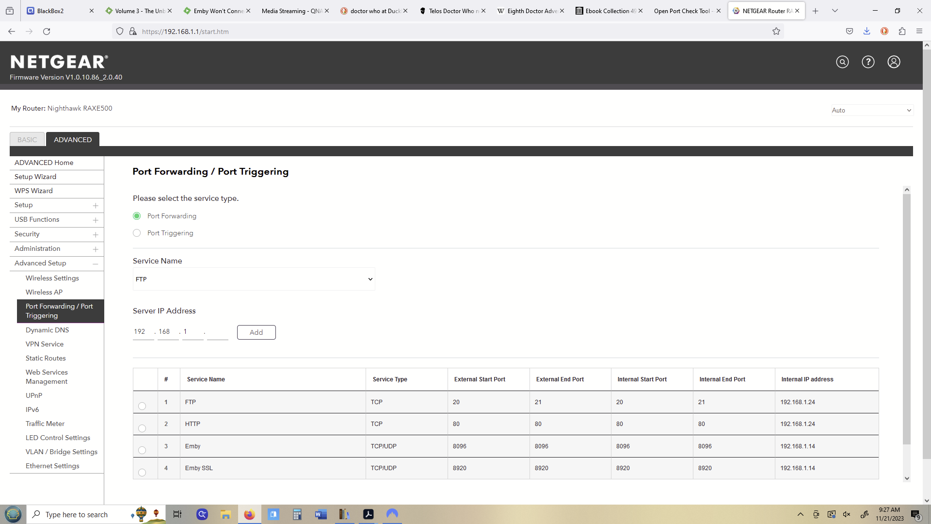

ebr 16307 Posted November 21, 2023 Posted November 21, 2023 17 minutes ago, jprobins007 said: I used port 8096 That is the port you defined as the external port in the forwarding? You are using plain http or https? Can you show us your port-forwarding setup (blur out the external IP address)?
jprobins007 24 Posted November 21, 2023 Author Posted November 21, 2023 (edited) Yes, that is the non-ssl external port. However, I did not notice that it was connecting to canyouseeme on https. I ran it again with the ssl port (8920). Same result. I am attaching screenshots. Port Forward.pdf Edited November 21, 2023 by ebr removed image with public IP address
ebr 16307 Posted November 21, 2023 Posted November 21, 2023 Hi. You can just paste images directly into this forum. Using PDF attachments makes it much harder for us to see. Thanks.
jprobins007 24 Posted November 21, 2023 Author Posted November 21, 2023 OK, more I do not understand. canyouseeme cannot see the ssl port (8920) when on the local network either. See attached. canyouseeme https local.pdf
jprobins007 24 Posted November 21, 2023 Author Posted November 21, 2023 (edited) OK. I will try to do so. Edited November 21, 2023 by ebr removed image with public IP address
ebr 16307 Posted November 21, 2023 Posted November 21, 2023 Are you sure your ISP allows traffic on those ports? What if you try mapping to the standard external ports of 80/443 just as a test to see if canyouseeme works?

jprobins007 24 Posted November 21, 2023 Author Posted November 21, 2023 It has worked on those ports for a more that a year, which does not mean that Astound did not lock them out recently.

jprobins007 24 Posted November 21, 2023 Author Posted November 21, 2023 I changed the port to 400 and everything connects!!!!! For some reason, I thought I had to use 8096 and 8920. You hit it right on the head, when I was so frustrated. Is any particular port no. better/safe than another? Thank you very, very much. I am very appreciative of you and this board. 1
ebr 16307 Posted November 21, 2023 Posted November 21, 2023 15 minutes ago, jprobins007 said: Presumably a different ISP Not at your server location - which is the one that must be blocking traffic on some ports. Glad you got it figured out. 1
pwhodges 2023 Posted November 21, 2023 Posted November 21, 2023 4 hours ago, jprobins007 said: Is any particular port no. better/safe than another? Ports below 1024 are more likely to have an existing service attached - though not many in practice even so. Aside from that the number is entirely arbitrary; it's like your ip address is the apartment block, and the port is the particular apartment (actually, that's a dreadfully inaccurate metaphor, but so what). Avoiding 8096 and 8020 has the slight benefit that they won't get hit by people scanning for Emby servers on the "standard" ports. Paul
