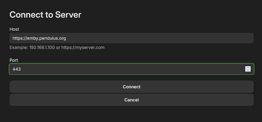

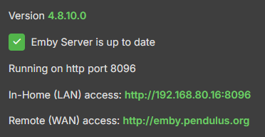

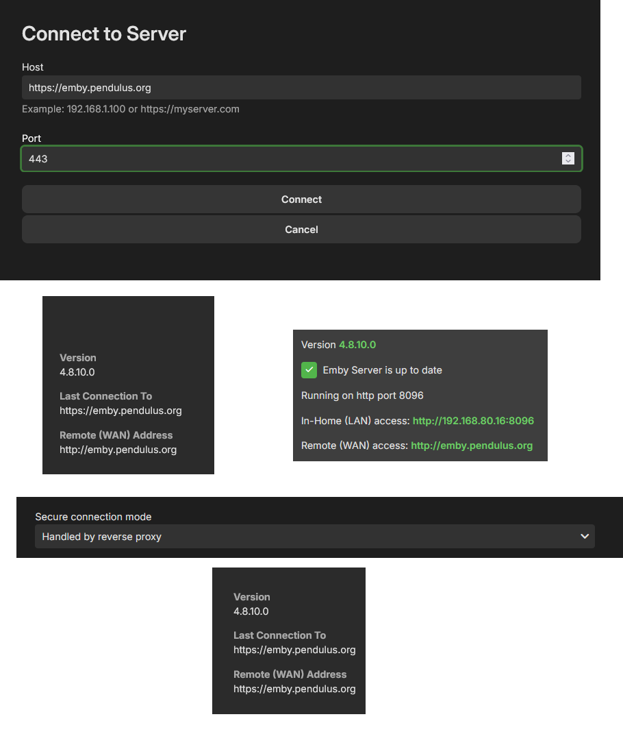

jgauthier 13 Posted October 24, 2024 Author Posted October 24, 2024 I am using a reverse proxy, it terminates SSL and then forwards to emby on HTTP. I checked my nginx logs for this hit and I can see everything is attempting to use HTTP and then redirected to HTTPS. This could be the problem with POST, but it's definitely not what I want... I know I set up emby connect up with HTTP: But then when I look at the connection it's HTTP. Discovered it was getting this info from the server itself. Found this setting , I haven't seen before and set it: NOW, it shows all HTPS. I will retry the Alexa integration when I am home in the evening. Thanks!
