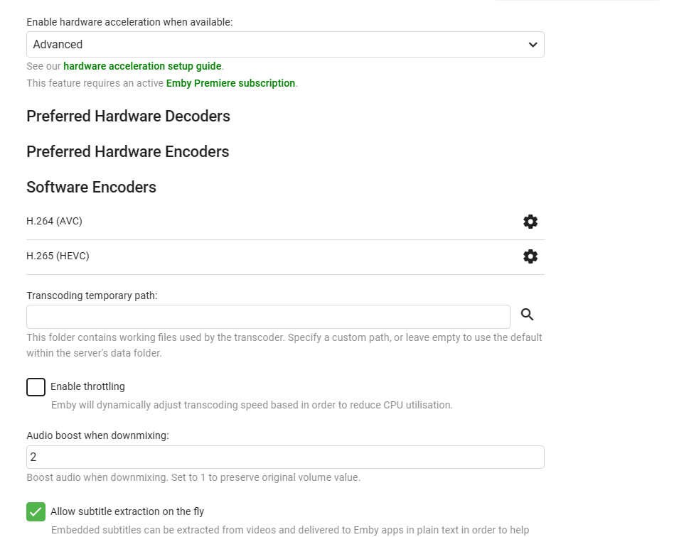

grahamcoyswanst 2 Posted October 16, 2023 Author Posted October 16, 2023 Installed it but i only see this
grahamcoyswanst 2 Posted October 16, 2023 Author Posted October 16, 2023 1 minute ago, croaton said: This one emby-server-deb_4.8.0.53_amd64.deb But make sure in your Repo apt sources list non-free-firmware is activated and have installed the intel drivers for the iGPU Best Regards than you will do this
croaton 9 Posted October 16, 2023 Posted October 16, 2023 (edited) 2 minutes ago, grahamcoyswanst said: Installed it but i only see this Check the Drivers with sudo lspci -v -s $(lspci | grep VGA | cut -d" " -f 1) < this shows you if the kernel drivers are active of the iGPU for smaller Output you can use ls -la /dev/dri and you need an active Premiere Subscription Edited October 16, 2023 by croaton

Q-Droid 1011 Posted October 16, 2023 Posted October 16, 2023 Attach the most recent hardware detection log. You might need to check that the runtime user for the emby server (usually emby) also has the video and render supplementary groups. If the user is emby then "id emby" would show the details. If either is missing then add them to emby.
grahamcoyswanst 2 Posted October 16, 2023 Author Posted October 16, 2023 here you go mate thank you hardware_detection-63833058418.txt
Q-Droid 1011 Posted October 16, 2023 Posted October 16, 2023 Is OS user emby running the server? Did you check to see if emby has the render group?
grahamcoyswanst 2 Posted October 16, 2023 Author Posted October 16, 2023 Emby doesn't have access to the render group and would you be able to tell me how to do that, please?
Q-Droid 1011 Posted October 16, 2023 Posted October 16, 2023 sudo usermod -a -G render emby Should restart Emby server after adding the group.

grahamcoyswanst 2 Posted October 20, 2023 Author Posted October 20, 2023 Hey so i did the above and its still not showing any hardware just the software. I restarted emby and also the server. Is there anything else i could try or any info you need just tell me how to get it for you and ill sort it. Sorry for the delay on this post I unexpectedly had to pop into the hospital for 3 days.
Q-Droid 1011 Posted October 20, 2023 Posted October 20, 2023 Attach hardware detection log and embyserver log after restart. Did you make sure emby user has both video and render groups? The emby user is running the server, right? If you are on Debian 12 then the kernel should be 6.x and new enough for Raptor Lake, but still check for updates.
grahamcoyswanst 2 Posted October 20, 2023 Author Posted October 20, 2023 Hey i have attached the logs im going to look into the other stuff you said because I'm not sure but will find out. embyserver (4).txt hardware_detection-63833400823.txt
