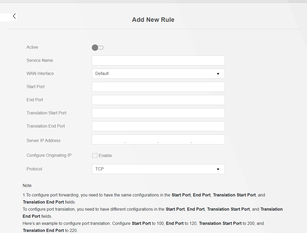

rbjtech 5335 Posted October 6, 2023 Posted October 6, 2023 I think the OP just wants to know what to put in the fields on the port forward ? Service name = Emby, All 4 fields regarding Port = 8096, Ip Address = your emby local Ip Address, Activate the rule. if your emby server has firewalls on it - then you may need to create f/w rules for those - if Windows, ensure it is has 'Private' networking as opposed to 'Public'. Let us know how you get on but try and use the guides linked above - that's what they are for .
Tekken009 4 Posted October 11, 2023 Author Posted October 11, 2023 First of all, thanks for all help, I believe it is a port forward issue to I have these numbers in my rule + my IP address. I can see, that the router has a firewall as well, maybe the issue is with this?

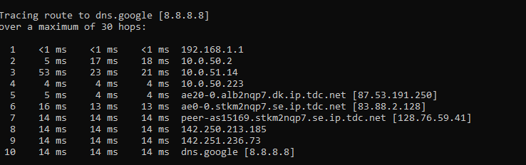

pwhodges 2023 Posted October 12, 2023 Posted October 12, 2023 22 hours ago, Tekken009 said: I have these numbers in my rule + my IP address. When you say "my IP address", do you mean your WAN address, or the local address of the computer running Emby? It should be the second (incidentally, as that is internal to your network, there's no need to hide it here). Have you checked for the possibility that your ISP uses cgNAT - if they do then there is no straightforward way to get around it. Ways to check: Method 1: At a command prompt type "tracert 8.8.8.8". If any line after the first contains an address in the following ranges, you are behind cgNAT: 192.168.x.x 10.x.x.x 172.16.x.x through 172.31.x.x 100.64.x.x through 100.127.x.x Method 2: Log into your router and check its WAN / external address; where to find it depends on your router. If this address is different from the one given by calling https://whatismyipaddress.com/, you are behind cgNAT. Paul
Tekken009 4 Posted October 12, 2023 Author Posted October 12, 2023 It is my LAN ip and not WAN. I did the tracert 8.8.8.8 and got following: It does not seem as i am behind cgNAT?
rbjtech 5335 Posted October 12, 2023 Posted October 12, 2023 33 minutes ago, Tekken009 said: It is my LAN ip and not WAN. I did the tracert 8.8.8.8 and got following: It does not seem as i am behind cgNAT? You are behind cgNAT I'm afraid. You will not be able to easily share your emby instance - as it has no 'public' IP address.

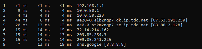

Tekken009 4 Posted October 13, 2023 Author Posted October 13, 2023 When i look at Emby dashboard, it has the new IP (after a restart og the pc). So far so good. But i still can not access the server remotely. This is my new tracert: Line 8-10 has changed..? when i look at this address, i have a new IP https://www.whatsmyip.org/
rbjtech 5335 Posted October 13, 2023 Posted October 13, 2023 21 minutes ago, Tekken009 said: When i look at Emby dashboard, it has the new IP (after a restart og the pc). So far so good. But i still can not access the server remotely. This is my new tracert: Line 8-10 has changed..? when i look at this address, i have a new IP https://www.whatsmyip.org/ It's still CGNAT - you need to reboot your router and wait until the 2nd line does not start with a 10.
Tekken009 4 Posted October 13, 2023 Author Posted October 13, 2023 Okay, so are we talking hard reset og just power off and power on?
rbjtech 5335 Posted October 13, 2023 Posted October 13, 2023 (edited) 4 minutes ago, Tekken009 said: Okay, so are we talking hard reset og just power off and power on? Off and on again - but please liaise with your ISP - they will be able to advise when the change has been made at their end. You may need to wait. You may need to do something on the router - but they should advise you of this. As above - if the 10.x.x.x has been replaced with something else on line 2 - then you are likely on a real public IP - and it should work from that point onwards. Edited October 13, 2023 by rbjtech 1
